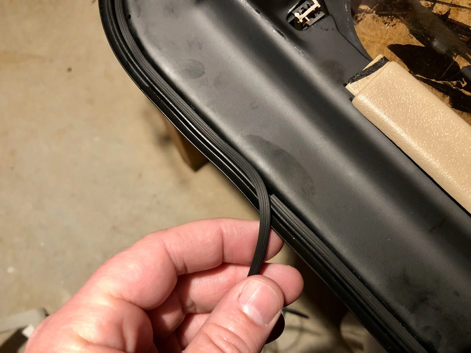

Step 4: Jam this screen door rope (0.160) that you can get for $5 at the hardware store into the gasket seam and let it sit overnight, with plenty of the lube on the gasket.
** the sunroof will not fit back in the sunroof hole with this rubber rope in the gasket. The rope is too fat.

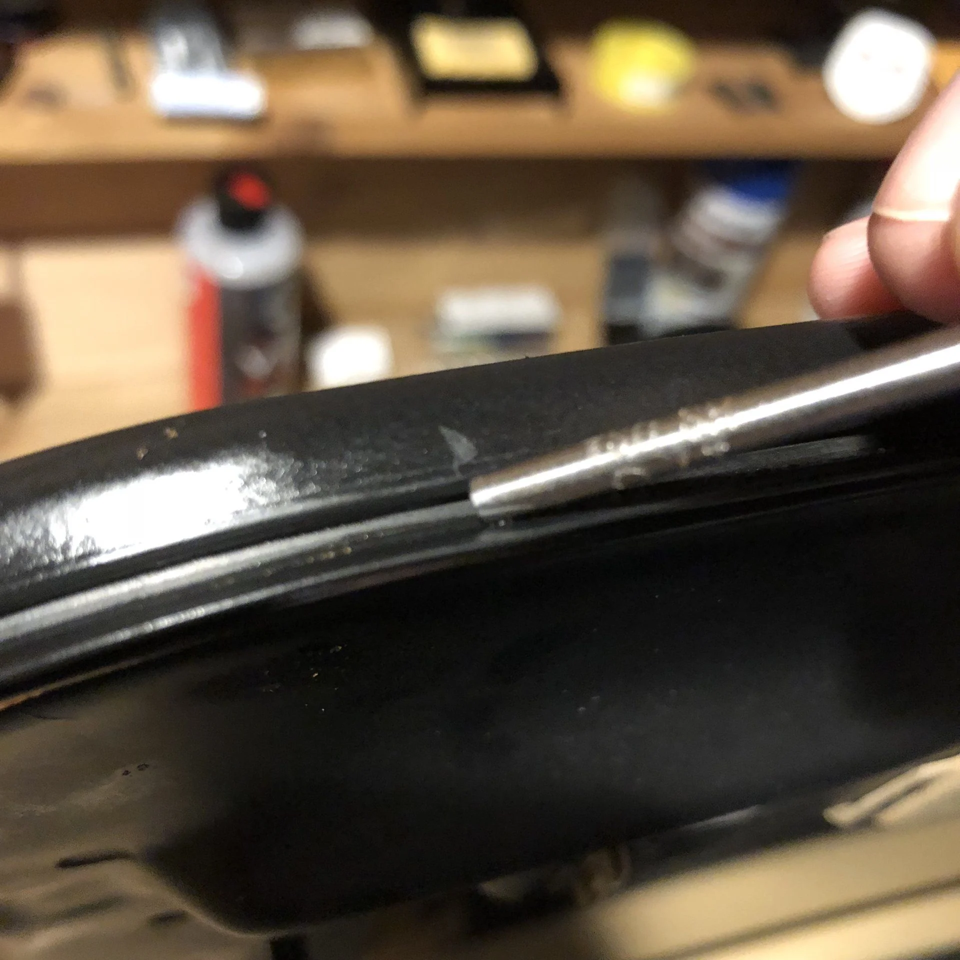

Step 5: make sure you clean the outside seam with lube and a smooth device, i used the smooth end of a 1/8" drill bit.

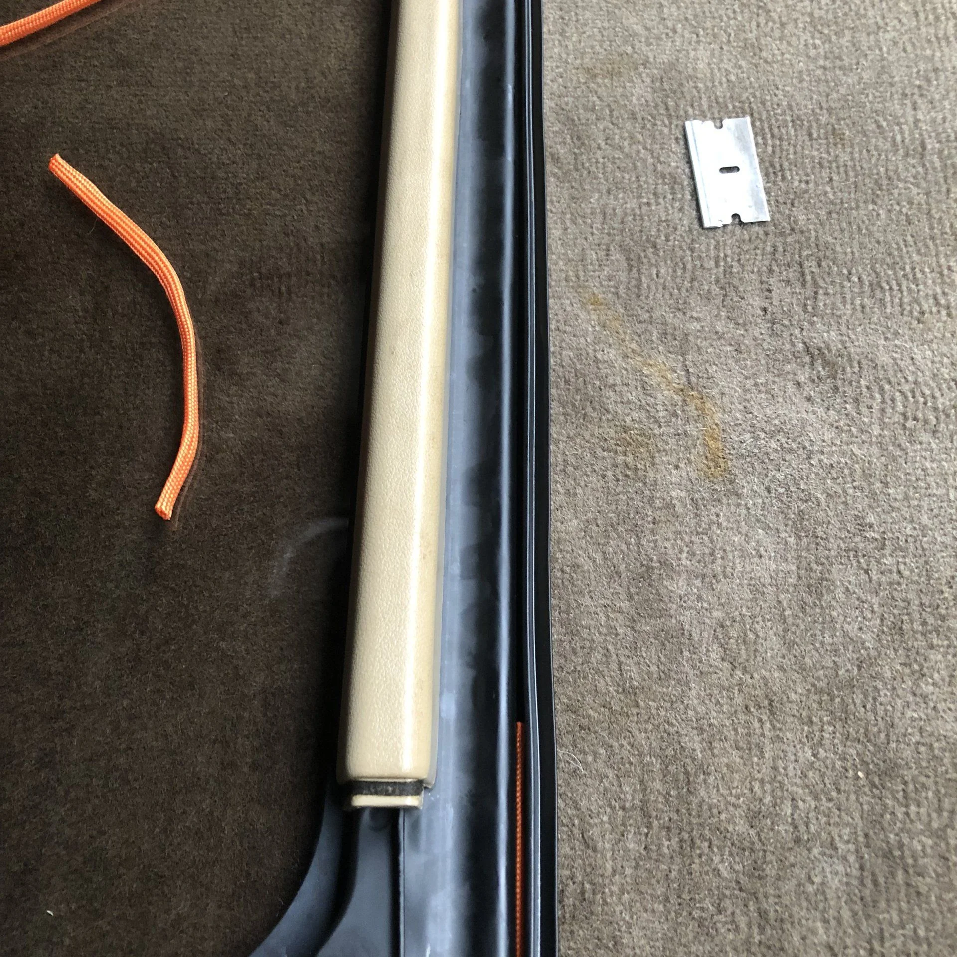

Step 6: remove the rubber rope and add paracord to the gasket seam and see if the sunroof will drop down into the sunroof hole. My sunroof was still too wide with the paracord in the gasket seam.
Step 7: if the stuffed gasket is still too fat to fit back in the truck, remove the center cord from the paracord and try again.

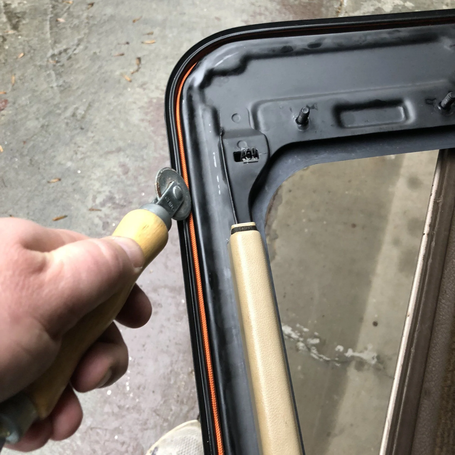

Step 8: you will see that with each fit attempt you can see where you need to trim out the paracord filler, I had to cut out most of the back side of the paracord for the glass to just bearly drop into the sunroof hole.
Step 9: once the panel will go back in and out of the sunroof "with help" you can see where adding meat to the gasket will really minimize the gap between the sheet metal and the glass gasket. So snug everything back up and then actuate the assembly after the bolts are tight.
