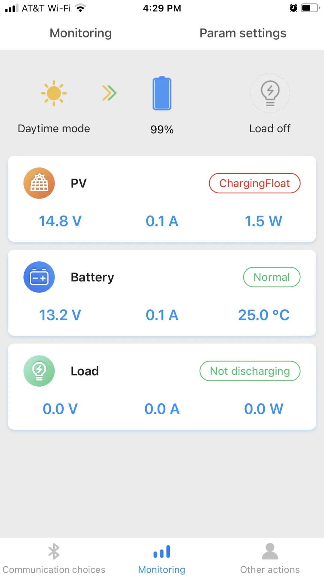

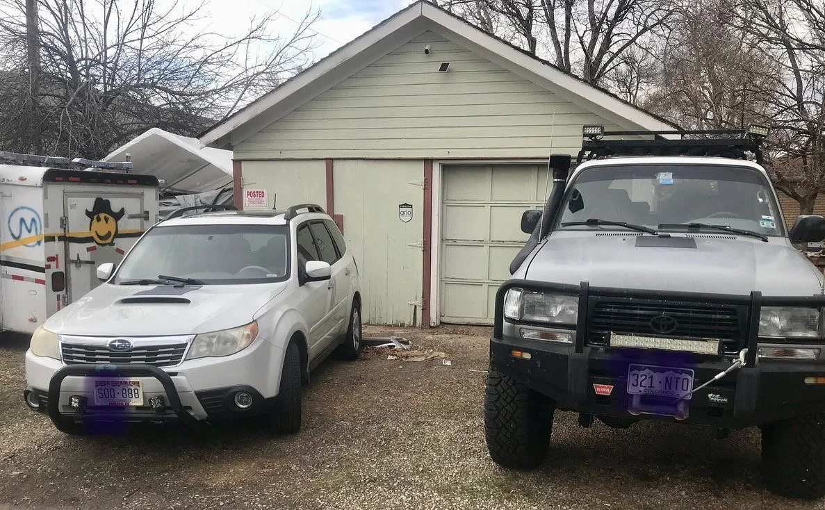

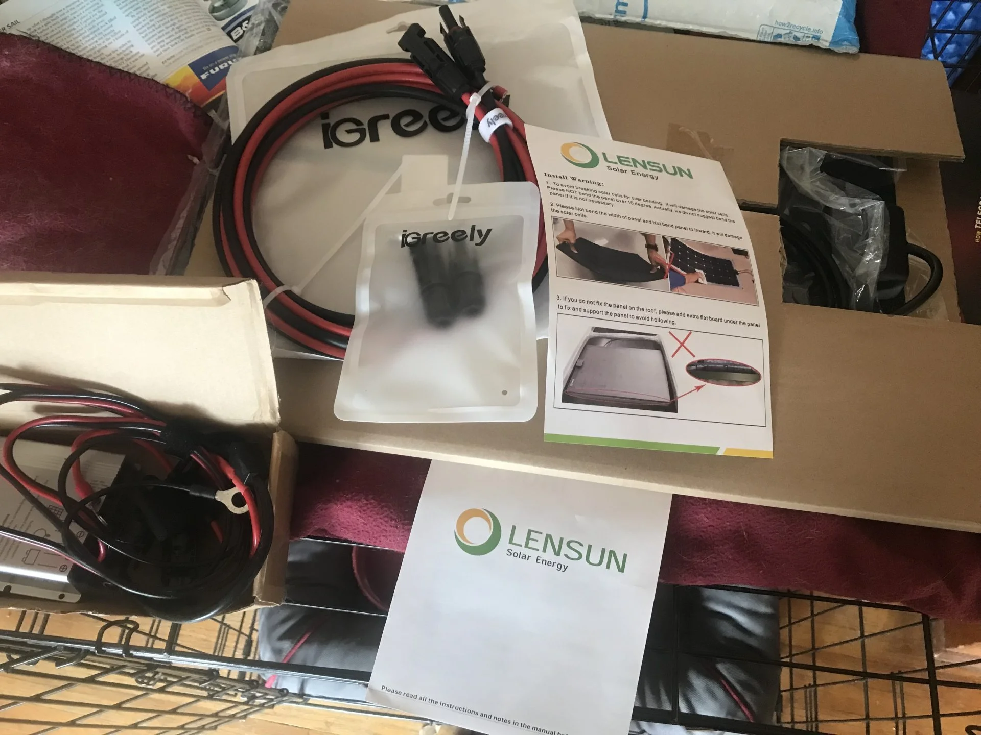

Since Covid and WFH… vehicles not getting used much so added lensunsolar mppt controllers and 20w flexible panels to truck and my Subaru. Also on truck I peeled off all accessory wires and put in big fuse and a breaker switch so I turn off power to all that when truck parked. So now batteries are all ways 13.1 or so when I go and start them. Both vehicles have yellow top gel batteries and here’s some photos …

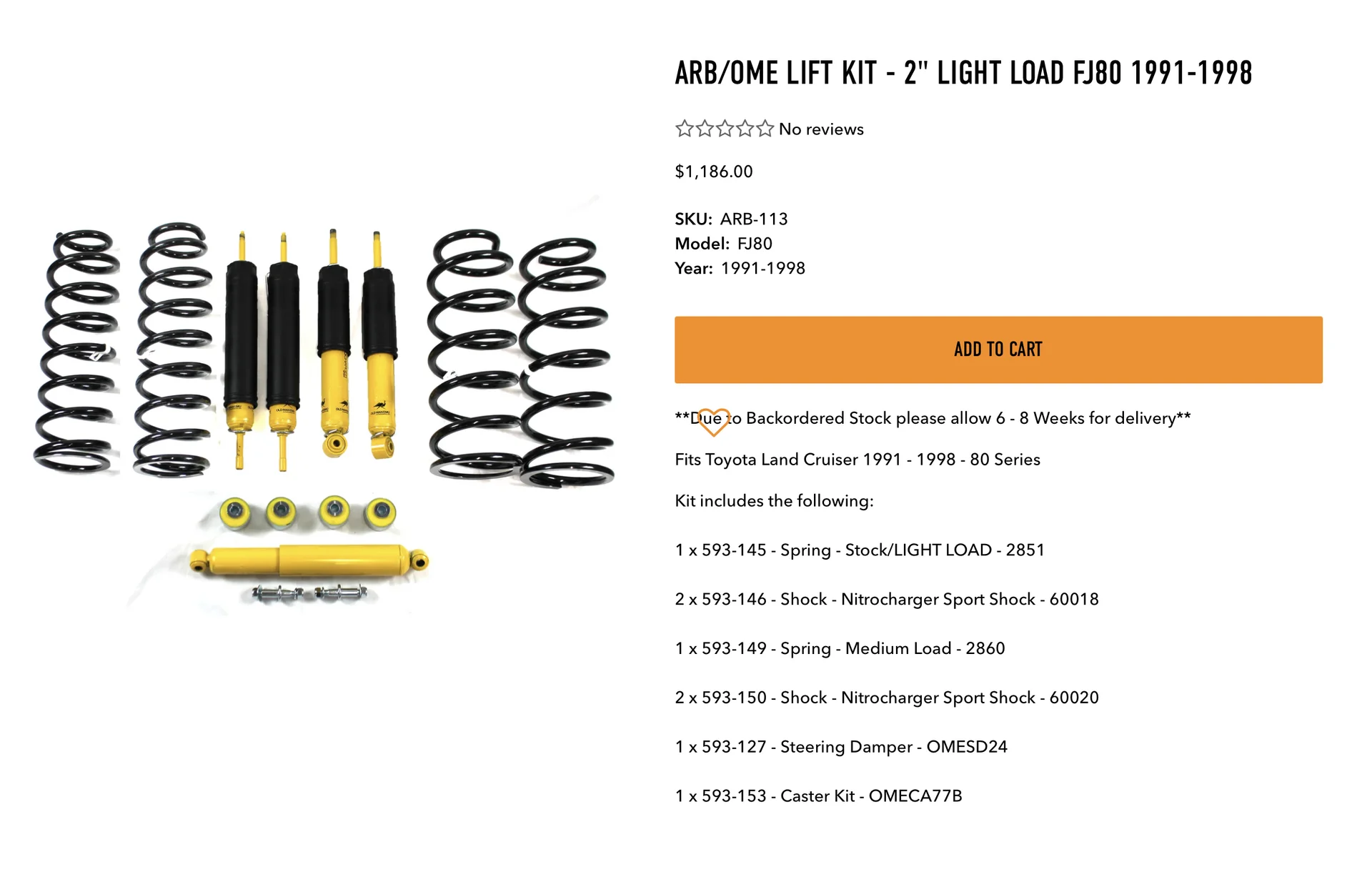

Hi. Gathering up parts to do the 5.3 ls swap. I read through many swaps. If I remember correctly, you will need a 2" lift. Do you guys know if the ome 2" will work? Thought about the icon but it's out of my budget.
Planning on running heavy in the front (compensated for the added weights) and medium in the rear.
