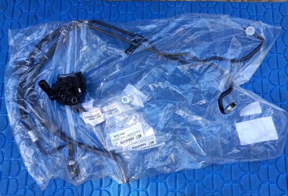

You can get pump kit, and rebuilt. Rack also, but kind costly and requires tools you may not have. Buying new, would save time a give 1 yr wty.

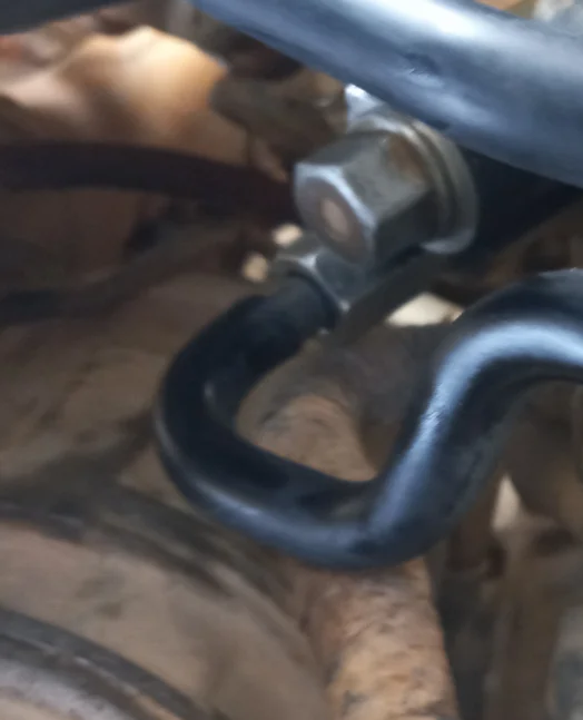

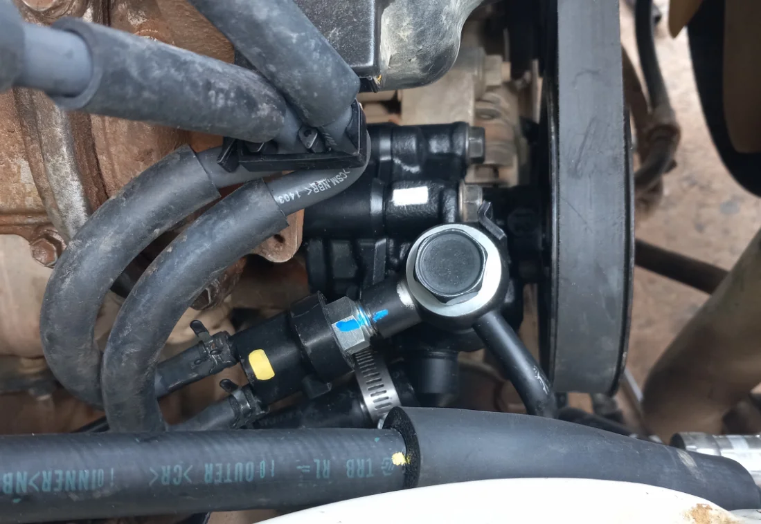

I make sure correct banjos used:
We have 2 different banjo bolts on either end of HP line. Not sure if possible, to mix them up. But just may be if one did, it may effect pressure or flow or both. In ever case of 06-07. The Vane pump banjo is silver, the rack side dark color.

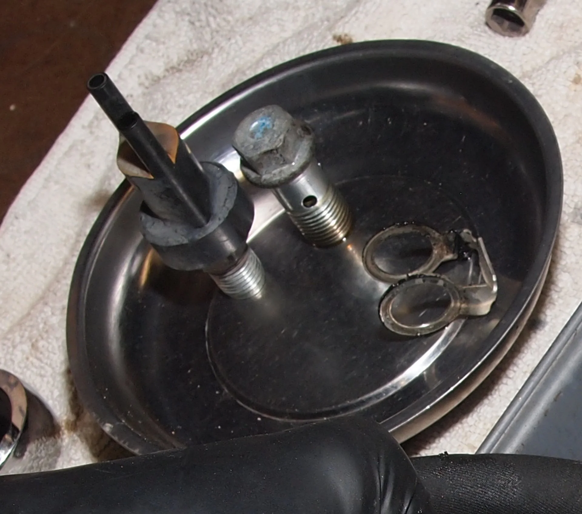

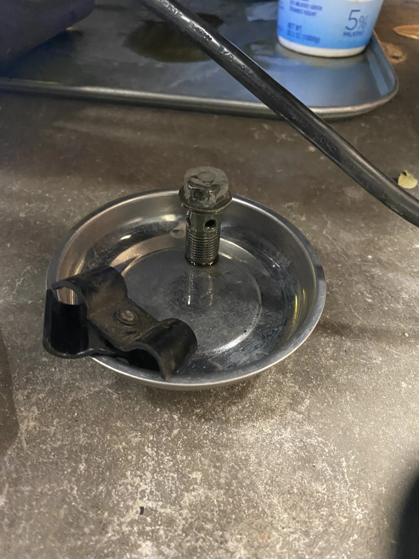

The below pictures are from an 07LX (first 2) & 06LC (3rd pci) , which there are variation through the years. If I find 98-02 pictures, I'll post them later. But it seem hole size, off-set and position is a little different between these and rack side has a valve.
Rack side banjo bolt (IIRC)
This would be Vane pump banjo.

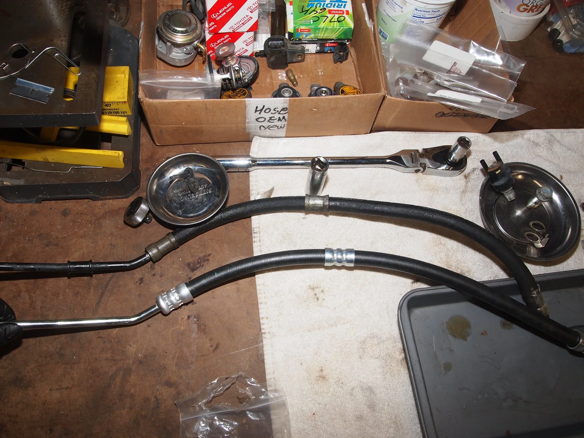

Below is Old OEM and new aftermarket HP line. It's my understand that is a reducer in center of rubber hose(s). If debris in it, could cause pressure/flow issues. So I'd back flush, once both end disconnected.
This from 06LC

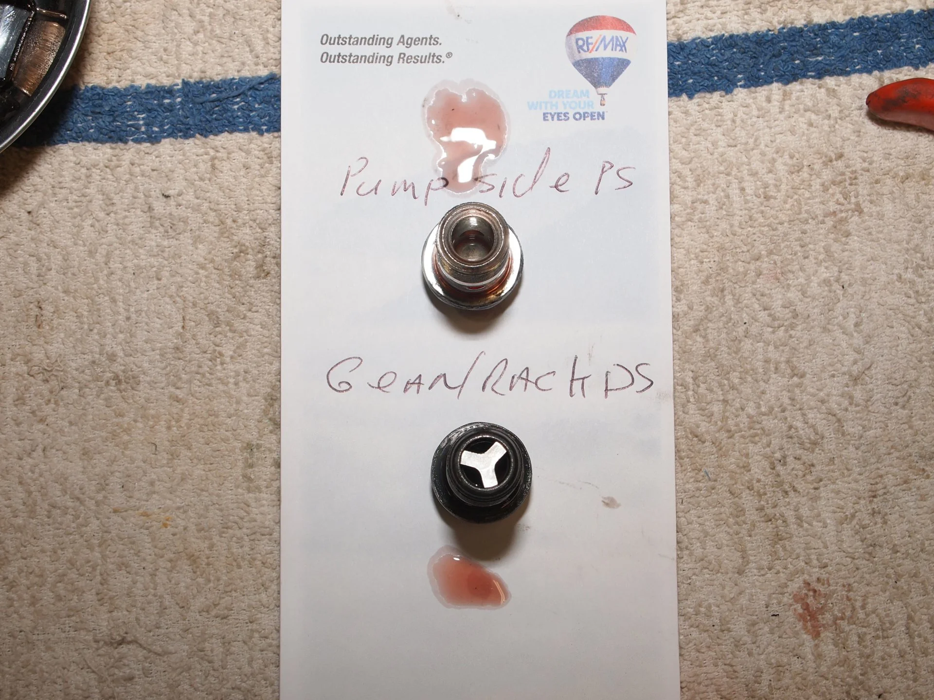

On my 99 model, the bolts are very different from the rack vs. the pump side.
The pump side is a 22mm with a long nipple that screws deep into the pump. IIRC the rack side banjo is a more conventional looking 14mm like the one in your picture. That one is the original rack's banjo.

An early morning power steering fluid check found the reservoir has melted. The cap cannot be removed. The cap lid separated while we were attempting to remove the cap and inside. To add fluid, I had to remove the reservoir and fill it through the tube ports and tilt it so the hoses could be connected without spilling it.
Power steering completely failed on the way home from a 150-mile weekend trip tonight. The pump is circulating fluid but nothing happens. Note this fluid was clean approximately 1 week ago. The new fluid was completely cooked this morning.
@Bisho -- It gets crazier than you saw this morning.
This is a big mystery.

Today I received my IR thermostat order. Tonight I let the engine run for the same approximate duration as when I got a 3rd-degree burn from touching the banjo bolt last week. The engine water temperature was 184 f with the IR reading for the banjo bolt at 130 f. At 130 it feels warm to the touch but nothing like it did last week. I will monitor it for any deviation during off-roading trips.
