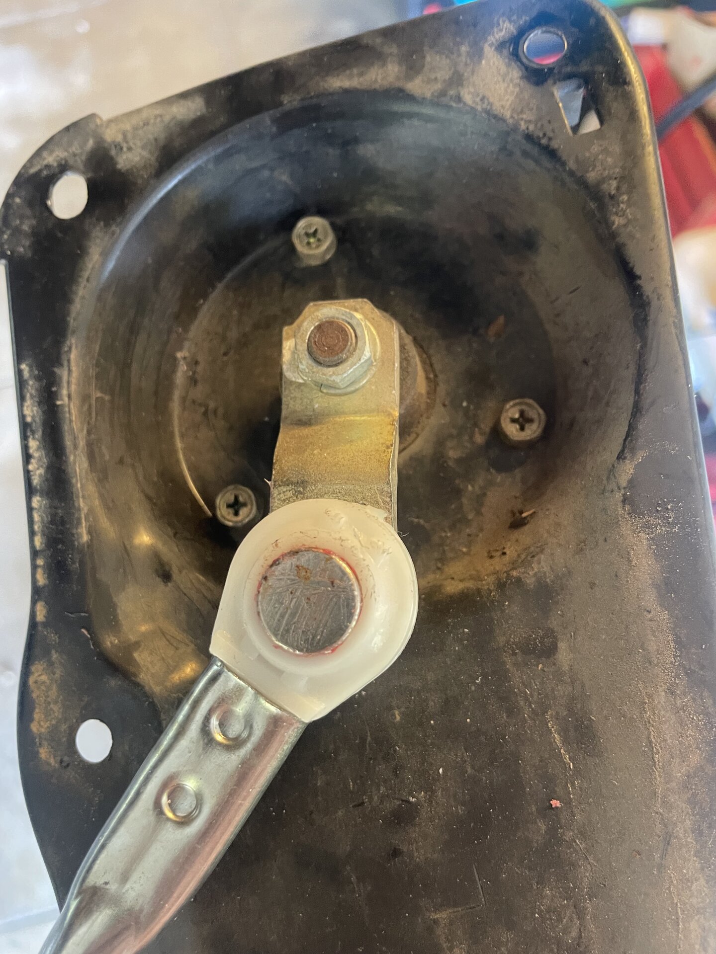

Trouble is the plastic bushing that connects to the motor on the new part does fit (I think)
I haven't tried real real hard to push the new plastic cap onto the ball but I think the flat upper part will interfere?

Well if anyone else runs into this here is what i did -
I filed the dome portion of the new style bushing cap until it was open just slightly larger than the flat top of my motor arm pivot ball. I also put a chamfer on the top part of the hole to let the arm tilt freely in case of deflections when operating.
I added a bit of bicycle (skinny road bike size) inner tube to keep the grease in place
Seems to work just fine and should get me through this winter

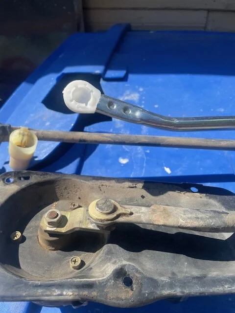

I still haven’t found any image reference for my particular motor arm setup and could probably avoid this by finding another arm with just a ball mount.

I saw this but the description is lacking info about the rebuild process. Do they do anything for the pivot bearing/bushings?
And the pictures are of (I hope) a non rebuilt unit. I'm going to take a swing at making something that won't rely on plastic bushings before I go that route.
