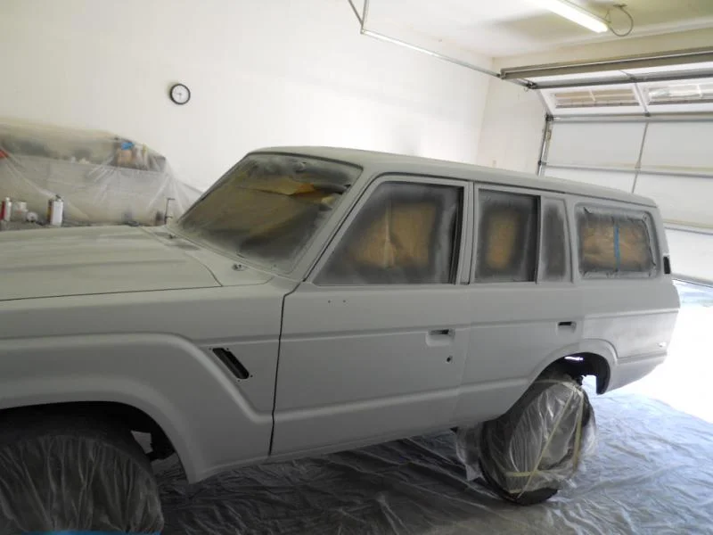

Another 85 fj60 Blue #2??
Awww...You suck. Lol! Now I know why you haven't been up. You want to drive that thing.
You just make it look too easy. We all watch you and think, "Wow, it only takes that long?". Meanwhile, it's taking me weeks to build an engine.
Very nice dude... wish I had a garage like that (let alone a wife that would be willing to help, who knows maybe she will!)... Hopefully you watched your flash times on the primers, but with only having a couple sags you seem like you were pretty good.
I had a time window and I took it. Also, playing the.."ITS FATHER'S DAY" card helped too... HA! Hope to see ya soon I-man.
Awesome Job man, how did you like the epoxy primer from Eastwood?
It laid down really nice.. I was kinda surprised for a 99.99 kit.
G, I love my shop. The wife is the BOMB.. helped me paper, tape and tack rag the cruiser too.. I waited 30 minutes between 1st and 2nd coat, 45 min between 2nd and 3rd coat. It sagged because I was trying to build up over a couple of the repair areas. I went over one to many times at too slow a pass. My bad... Like I said the sags are really small, one is about 4" long and the other even shorter. An easy 5 to 10 min repair.

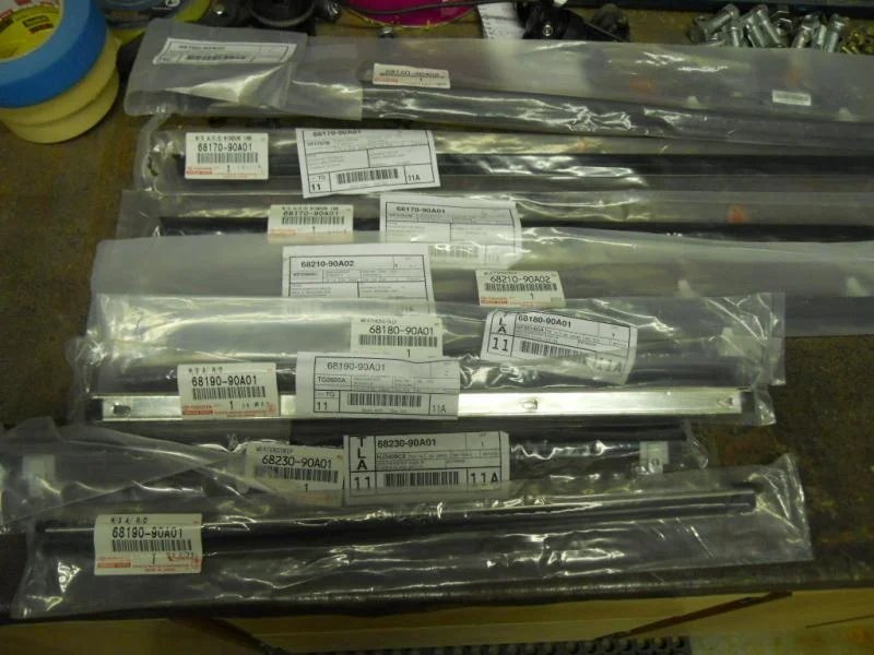

Got home to a couple of packages.. FatMat sound deadener and my Toyota window seal weatherstripping. I'll post pics later.
The window seals are indeed black rubber for the exterior but, have the chrome strip for the interior :mad:. I rolled the dice hoping they would be solid black as well.
I figured when I saw Onur and Dan not having luck with the black only interior ones I would too. Anyhow, I got new ones inside and out. HAPPY HAPPY!:cool:
Time to get out the etching primer and satin black paint again. NO CHROME ALLOWED!!!

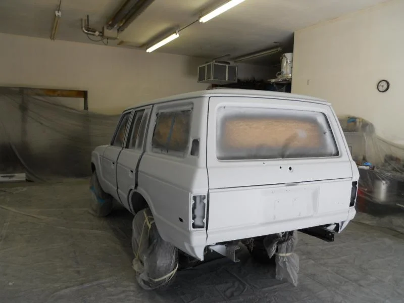

Well I let the epoxy cure for three days and I wasn't too happy.. Too many sanding scratches didn't get filled in.. I was afraid they would show thru on the basecoat so... I ran and got some urethane filler primer and shot 2 coats this afternoon. I will sand down with 400/600 and then reduce another epoxy coat for a sealer before I shoot the BC/CC...
This is how Blue Marley looks now.... But, I'm planning on shooting the basecoat this weekend.. :rolleyes:
