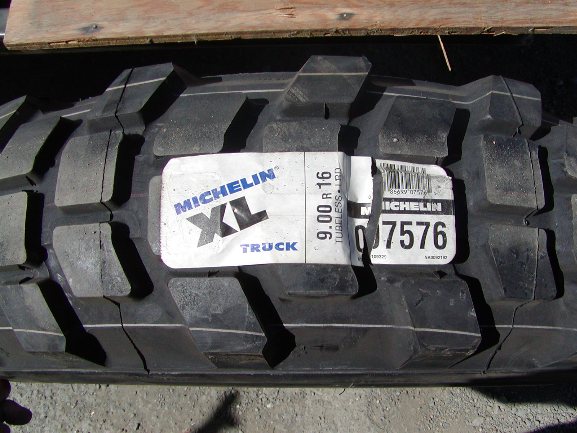

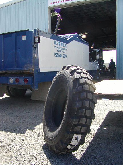

The 9" wide and 11" wide XL tires are directional, and even when brand new look like pizza cutter trailer tires.
There's ALOT more tire here...
As there should be, LAV's run 20" tyres and the picture of the XL above it is of a 9.00x16 XL. The overall width difference betwixt a 11.00-16 XL and 325-85-16 XML both mounted on a 16x7 rim is a whole inch.
You cannot mount an XML on a 7" rim.
Look at the XL tires. from the side angle. They are a rounded peak with basically 2 straight tread blocks for tread.
The LAV above is running the 16" rim tires. The 20" rim version is like a 46" tire.
If you measuse from sidewall to sidewall - the 11.00 is 11" and the 325/85 is 13".
The Tread on the XML sticks out past the sidewall bulge. The XL definately does not.
