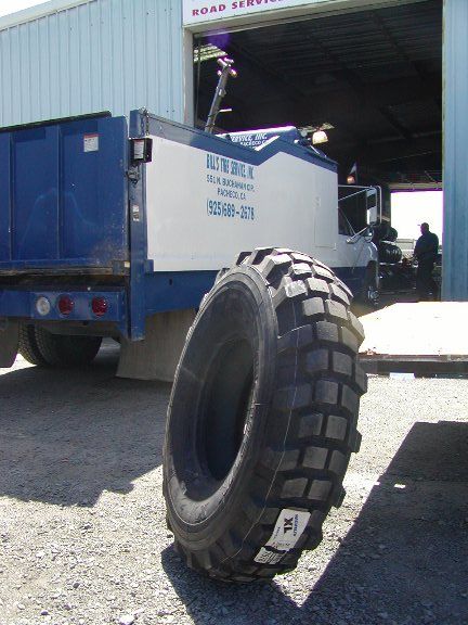

The chain link tread pattern on the middle of the tire dose not seem like it would have all that much traction. I'm sure lot of people will be watch how these work out for you and Codyrx7.
still looks cool though.
You mentioned "military tires" and someone else said "Michelin XML's". I tried zooming in on the pics, but I still can't see exactly what tires those are, can you confirm what they are?
325-85-16 Michelin XML's are pictured, Alkaline had 11.00-16 Michelin XL's. I have had both 9.00-16 and 11.00-16 XL's, grooved and ungrooved and they are no match for the 37" Iroks I run now except in treadwear.
The 9" wide and 11" wide XL tires are directional, and even when brand new look like pizza cutter trailer tires.
