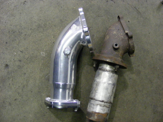

After doing my 3" exhaust at home and using the factory elbow off the turbo I wasn't happy knowing that I still had a portion smaller than 3" and still had the less-than-smooth insides of the factory elbow.......so I spent the money and ended up getting a 3.5" dump pipe from Beaudesert. It's quite nice.
Here's a couple of comparison photos...

Interested in more info about the Baudesert elbow. Did they build this one custom for you, or is it considered an off-the-shelf item?
I have a GTurbo Grunter Extreme going into my 1HD-FT equipped FJ45, and we will be building a custom 3" exhaust...this would certainly remove the factory bottle-neck.

I'm also interested in some more info on the Beadesert downpipe, looks like a really nice piece!
http://beauexhausts.com.au/
Their website doesn't really list products so I ended up using the "quote" form and going back and forth with them a couple of times before I managed to order something. Being on the other end of the world makes communication a bit tricky.
They call it 3.5" and it reduces to 3" just before the supplied mating flanges. Not cheap, I paid over 300 CAD shipped from Australia including ceramic coating. Basically an off-the-shelf item but the ceramic coating was an option. Keep in mind, that price was from almost 5 years ago...
