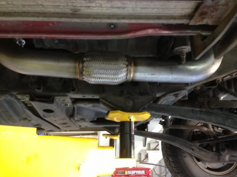

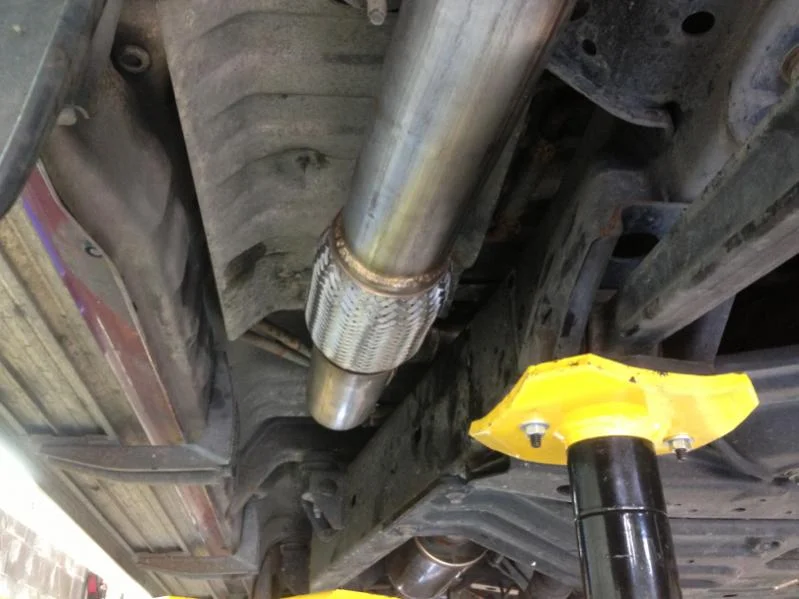

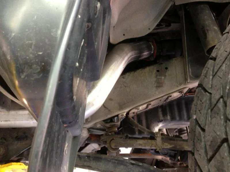

WOW I pick my 81 up today from m-tech. They are doing stainless 306 mandrel exhaust with a straight thru magnaflow all tig welded with new stainless turbo flange and flanged section under the truck just incase it needs to be removed for other repairs . I'm embarrassed to say what I am paying but I'm praying to god it is mint. They do have a mandrel bend machine in house so there should be only 7 welds I was told. We will see . Ill post pics later today so others can judge quality of work.
New stainless flange, cut in house on there CNC plasma cutter
Nicely tig welded to the new ss flex pipe
Well tucked in
