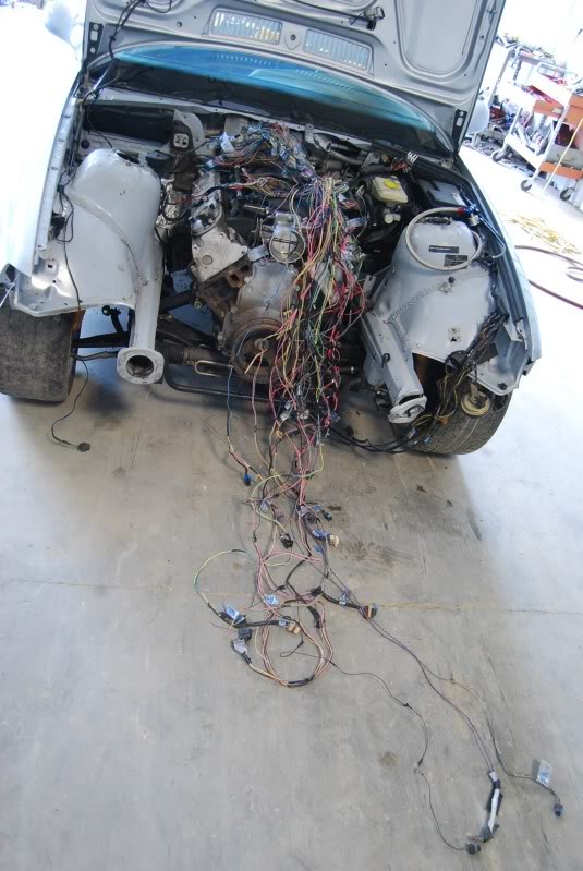

Pic of the exhaust and radiator. I didn't realize it was the early style manifolds with the egr on them so I hacked them off and welded that up, and I hacked off the stupid looking flanges and opted for some V-band flanges. I'm also going to have a 3.5" exhaust with one or two mufflers depending on if momma likes it... Basically I will have 3" downpipes with flex sectionsthat merge into one 3.5" pipe down below the engine and all the way out to a 4.5" polished tip.
Why? Because I can. No other reason.
If you look on the drivers side, I had to extend that pipe out and it still needs more adjustment, so I just tacked the pipe for now. It is tight by the frame and steering shaft, since I have it at home and not at work, it will probably take me a few trips to get the angle of the dangle just right. I'll get down pipes on it and just drive it to work to finish the rest of the exhaust.

nice! keep up with the momentum and finish this great project! There is not an 80 owner who has not thought about this swap. me included!

Have you figured out how to hook up the starter? I was tracing my starter wire in my harness and it splices into 2 other wires.

I'll do my best to really get the wiring documented.
That's cool, but what we are hoping you'll do is create a plug and play harness for these engines :grinpimp:
