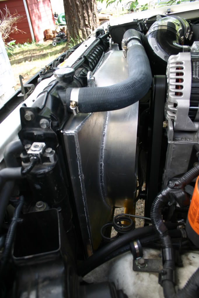

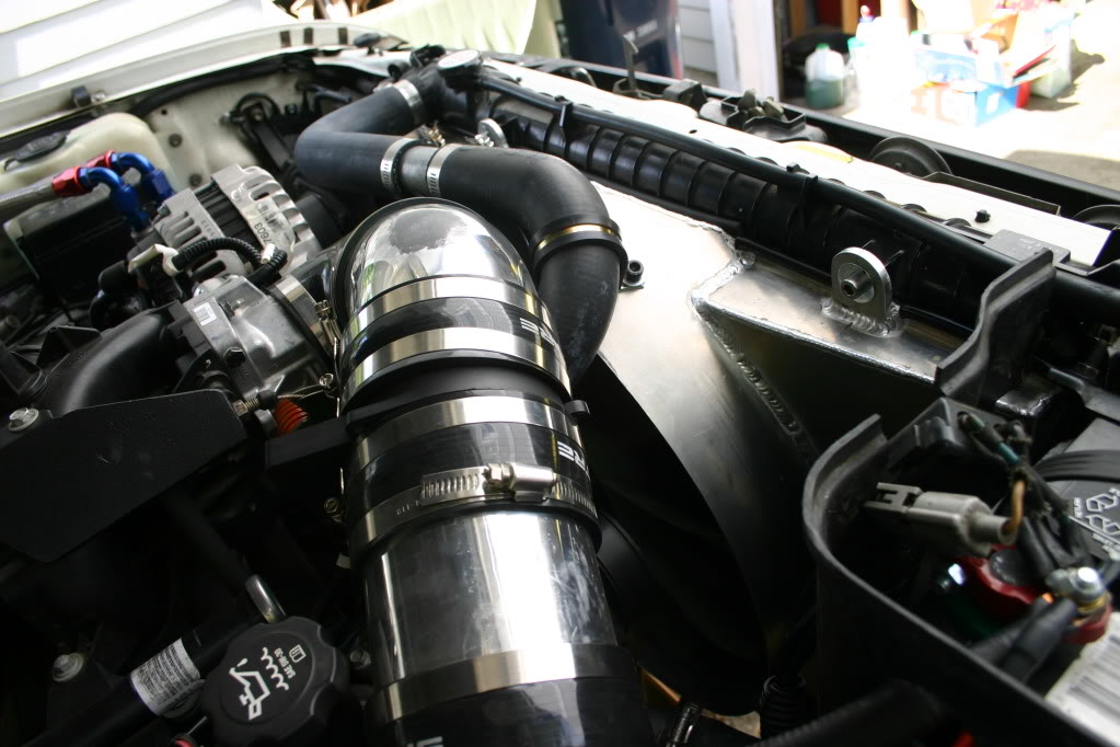

I wonder. Do you guys think this fan will be enough? I'd rather use this than the electric fan. I wonder if I can fill this fan with the thicker fluid?
The fan should be fine. If you talk to Ron Davis guys, they'll tell you to run a stock fan, over an electric, any day of the week. I run an LQ9 (6.0L) with the stock fan and a factory 80 radiator and don't have any problems...however, I did have a shroud built. Here are some pics...
OMG. That's like two days worth of welding!!! That's exactly what I wanted to do, however, the current radiator has a hole in it, :doh: so I have to buy another one.
