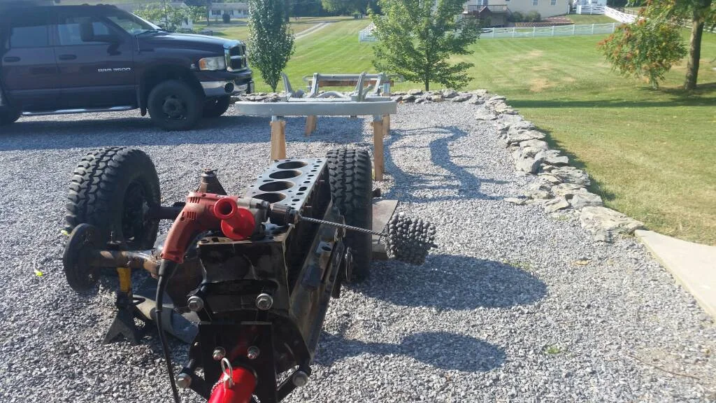

So there are 4 different Harbor Freight stores within a few hours of my house, instead of just driving to one and getting a spray gun to shoot some paint I ordered one online. Well apparently they like to ship from across the country, California to be more precise. Really put a delay on things here, been doing small things, axles are stripped and ready to paint, I honed the engine block today and spent a lot of time cleaning it up afterwards. Took it to the local machine shop to install the camshaft bearings, and balance/ polish the crankshaft. The camshaft was sent to Delta Camshaft in Tacoma a couple weeks ago, went with a KC grind after talking with them for a while, I am waiting for it to come back in the mail this week. Then to run it up to the local machine shop to verify the cam bearings and cam all work like they should.
Block this morning before I made a hell of a mess!
