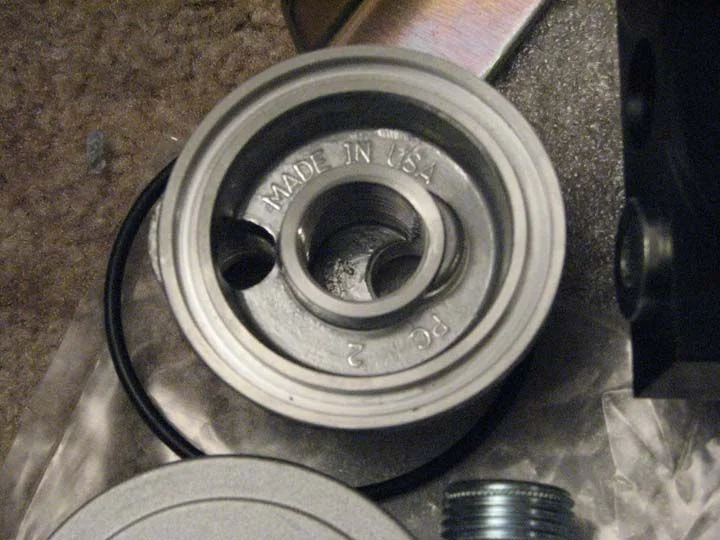

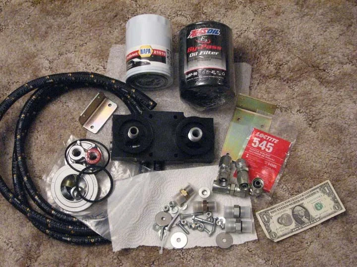

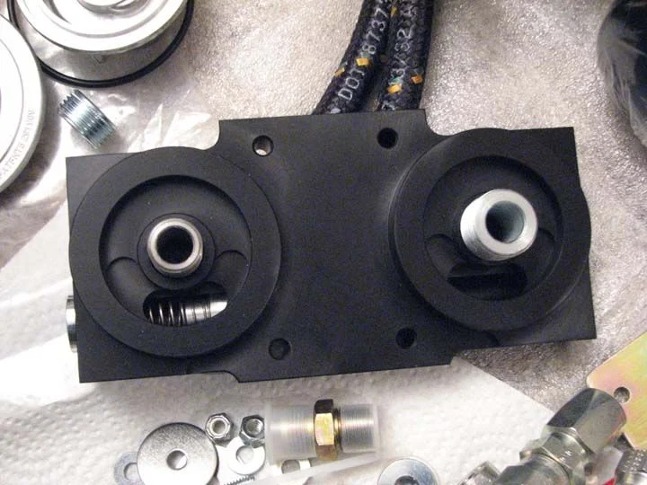

Well, my 62 got a care package from Amsoil today. :grinpimp:
BMK-13 dual remote filter kit and a couple of EaBP-90 by-pass filters (the smallest of 3 available).
I am liking what I am seeing so far. The kit is very nice, all the hardware looks high-quality and the instructions are well put together. Some of the fittings even have plastic caps on them to keep them clean!!:cheers: The filter is HUGE and as heavy as 2 of the WIX/NAPA full flow filters I have been using. :cool:
I'll get it all installed over the holidays when I am at my folks' place and can use their heated garage. Not sure if I will change out the oil when I do it, or just top it off so I can check on how well the by-pass filter clarifies the oil. (I'm leaning towards the latter)
