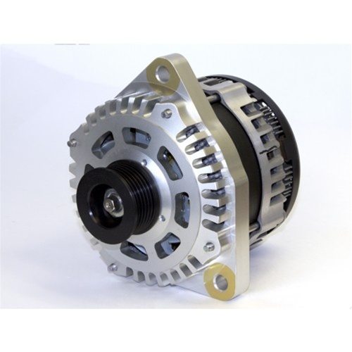

Lester 13983ND240: 2005 Lexus GX470 Base 4.7L V8 285CID Alternator
240 Amp Custom High Output Alternator OEM Built in the USA
$439.00 $339.00
The 240 Amp Pure Power alternator is the definition of gold standard in high output alternators and is the perfect upgrade to help give you the extra power your looking for. The Pure Power 240 Amp is our flagship model and will not disappoint you.
