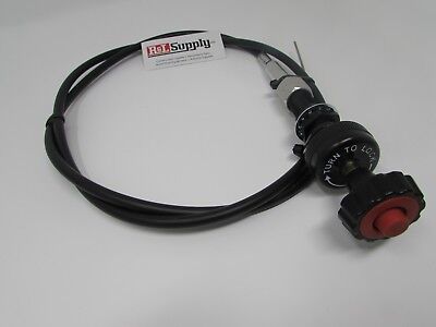

All in all, the oem hand throttle is flimsy so I went with a toro cable used in one of the earlier posts in this thread. It’s much better.
I bought this choke cable using the link and my install is nice and clean. BUT the darned thing won't hold when I try to set it. Any advice would be appreciated. I left a question for the seller also. Thanks a lot!
Does the knob have an arrow with the word “lock” printed on it?
Well, that bites.
I was unable to find the locking throttle cable I used on Amazon, which would have been my preferred seller. Had to resort to fleabay...here's a link:
For the cable stops I was unsure of what size would be required, so I bought two sizes (from Amazon): Dorman 03337 (1/16") and Dorman 03338 (3/32"). Unfortunately, I don't recall which I ended up using.
Best of luck.
Post #31 of this thread contains very useful pics and info.
