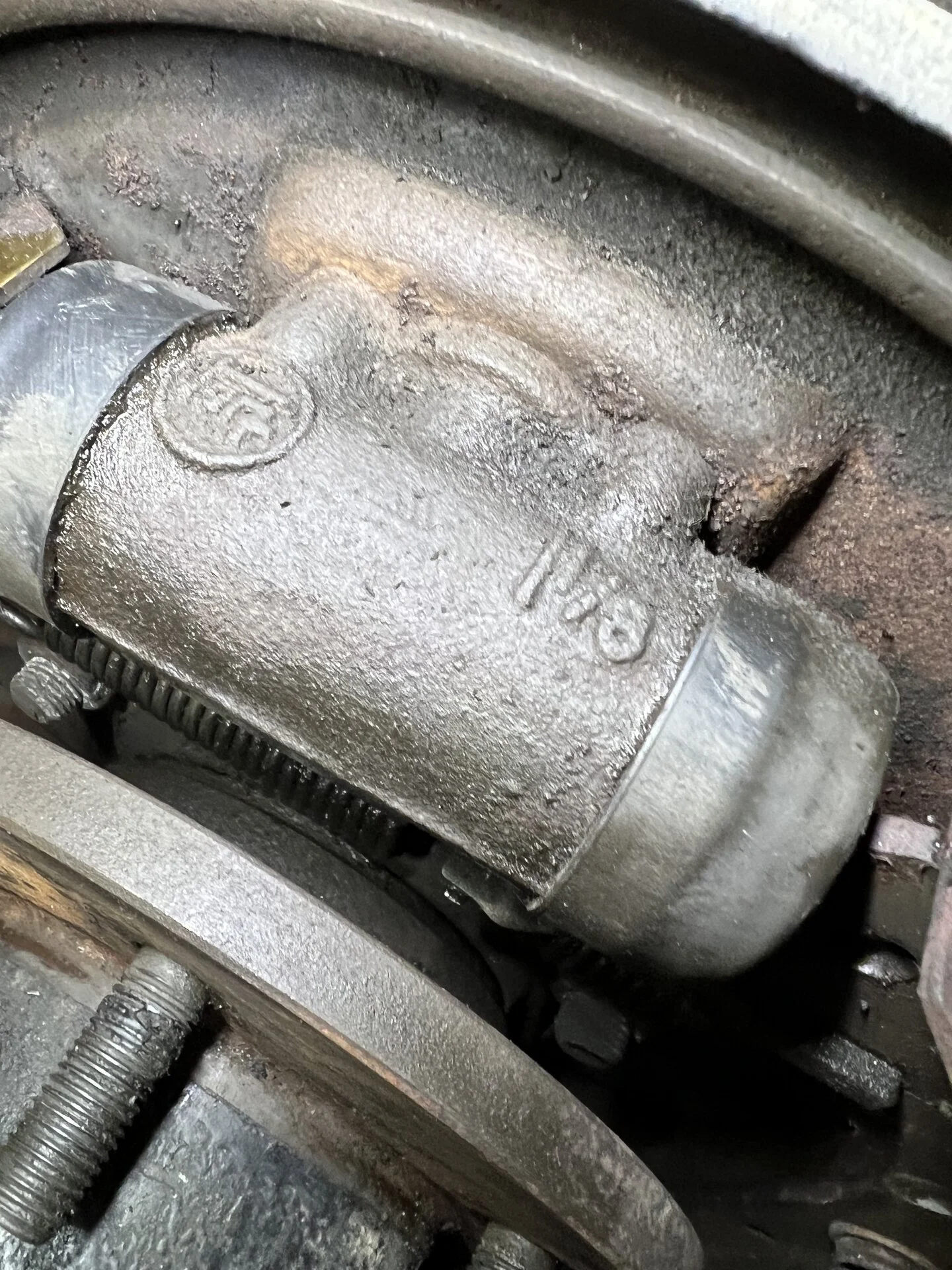

Apparently they were leaking when he removed the rubber boot. I never saw any leaks on the floor so it maybe minor. In fact, I was happy with my brakes...but I think the mechanic wanted me to contribute to his retirement fund. Problem is that he's the vehicle inspector in order to get plates.

Maybe weeping slightly, hardly a big deal yet but good to get them done.

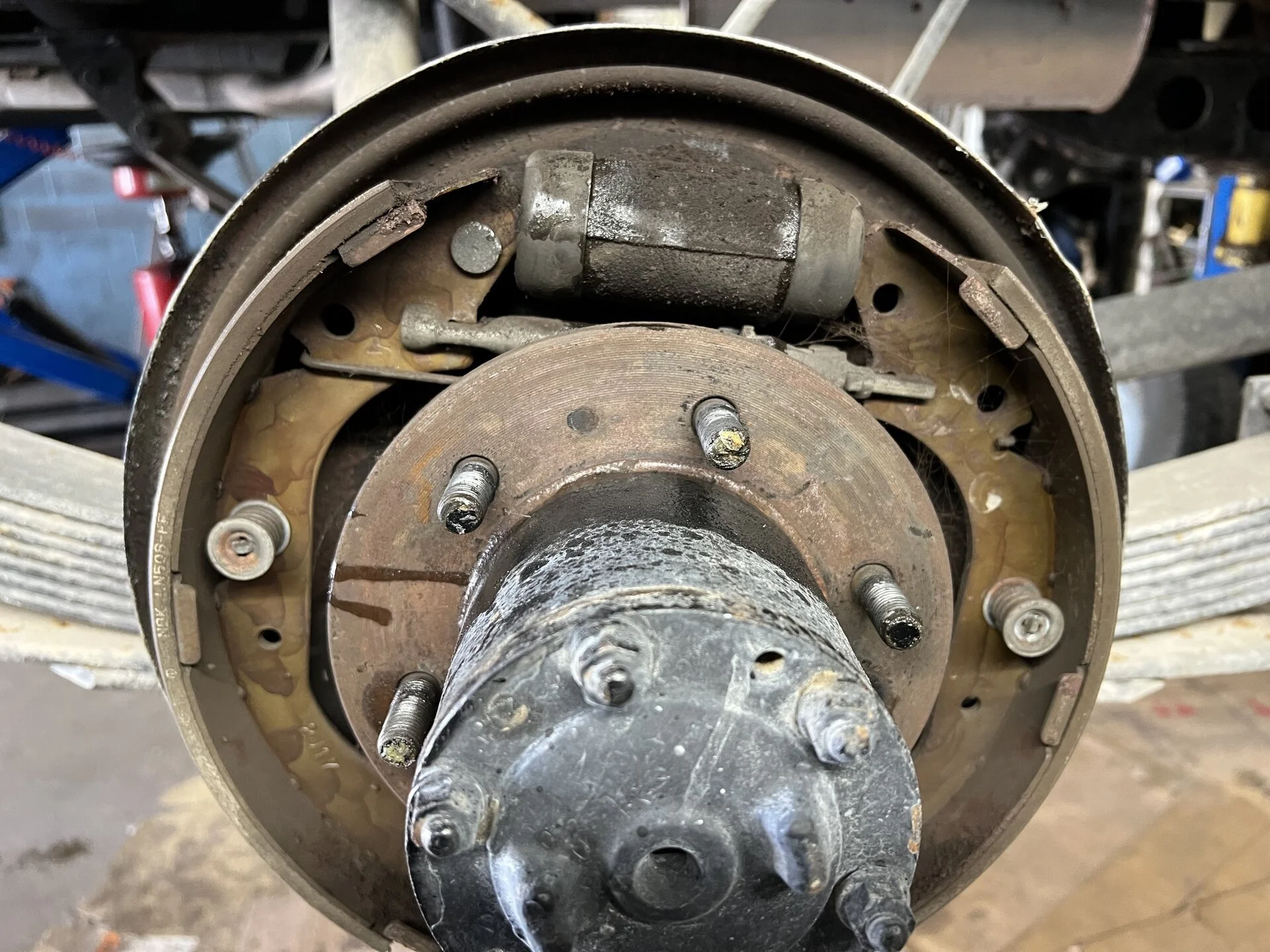

After seeing several youtube video's; I decided to change the drum brake cylinders myself. For the record, for a 1983 FJ45; the bore size for the cylinder is 1 1/8" [28.57 mm].

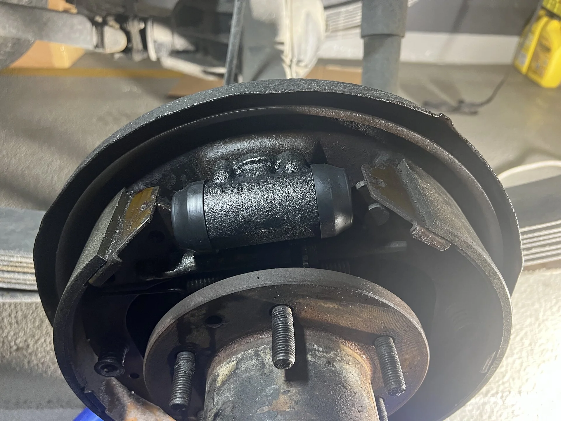

After a heavy dose of brake cleaner fluid; changing the cylinders was easy.
then I tightened / re-adjusted the spindle for the brakes. The wheel does about 1 rotation before stopping. Took it for a test drive and applied the brakes, both in forward and reverse. But it felt the same...as if there are no brakes. So I thought maybe there was air in the system and it had to be bleeded.

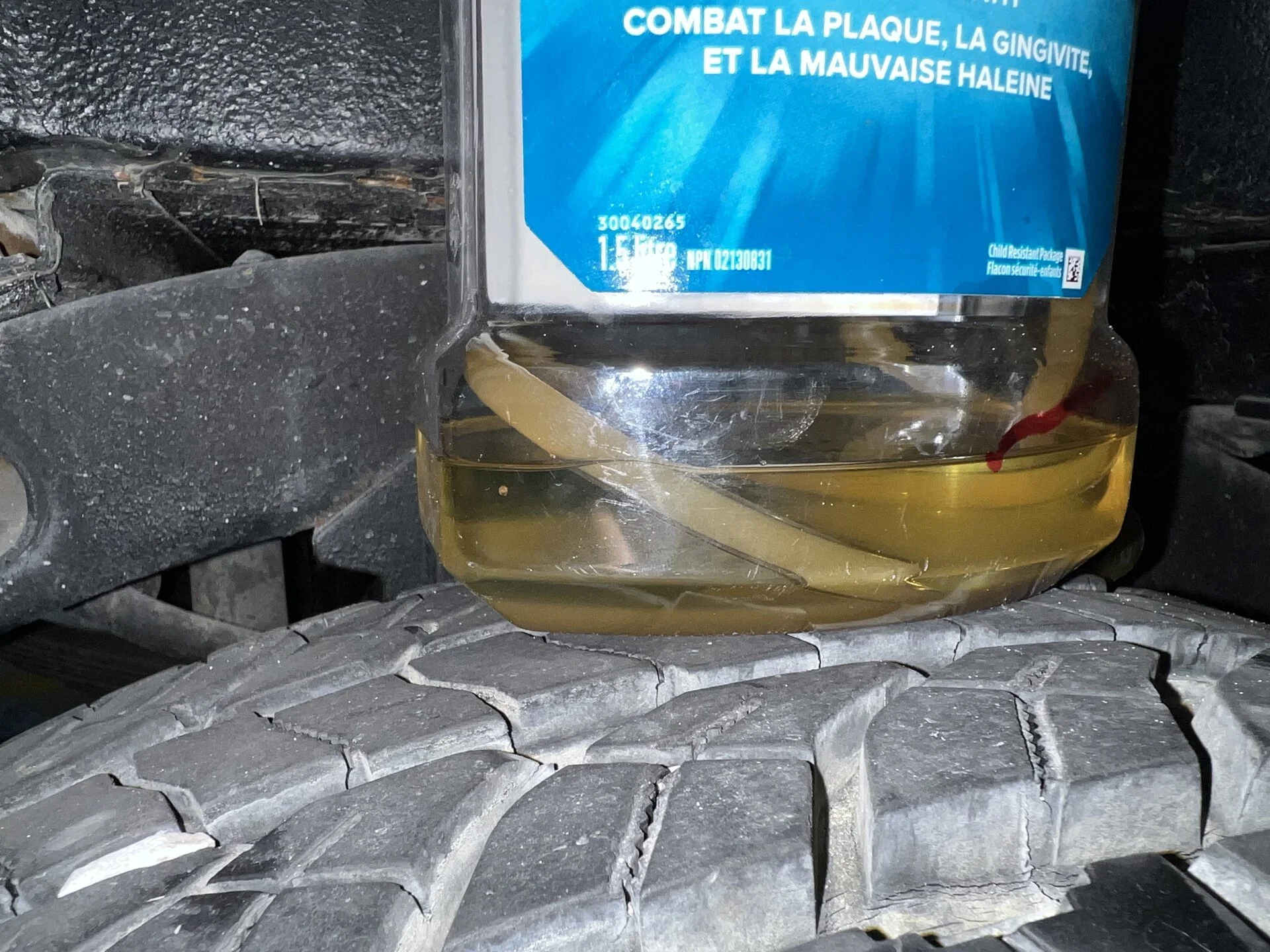

Started the process, and noticed my old brake fluid appeared very "milky" in colour.
The picture is not very clear, yet the bleed hose appears solid and the new fluid in the bottle is clear. I am using dot-3 brake fluid.
I am now thinking that I should flush the entire system; but am not sure if this would solve my problem of no brakes.
After a heavy dose of brake cleaner fluid; changing the cylinders was easy. View attachment 3445613
1) You should change your fluid periodically because it sucks up water from the air and then becomes prone to brake fade - especially with drums. So yes, flush them all out with new fluid. And don't shake the bottle first!
2) probably need to readjust. They do need to be quite tight initially and yes maybe a bit of air in there still.
Adjust the shoes to the drum with the wheels bolted on. Put a bottle like that at all 4 corners , with fluid over the hose end in bottle, open all 4, let gravity bleed, fill MC, let it go for awhile, keep refill MC. I like to clamp both soft lines and give MC a push to be sure the MC is proper, if it squishes down with both lines clamped its bad.

Are you sure the pistons in the wheel cylinders aren't frozen? With the drum half on the shoes, have someone press on the brake pedal - you should see the shoes move out. On my 72 the fronts are single acting so the shoe moves only at one end. The rears are double acting so the shoes move out at both ends.
