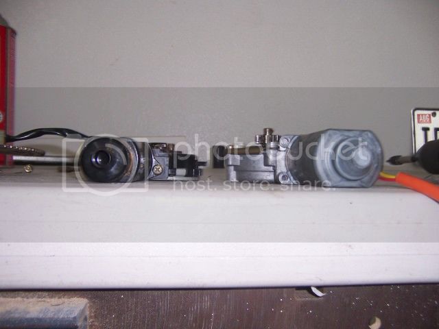

I was at the wrecking yard today so I picked up a Explorer drivers side window motor to compare with the Land Cruiser. Short answer is that the Explorer motor is not a direct fit, every dimension is larger. One may be able to make it fit on the regulator with some machining but I am not sure it would clear the window even then.
