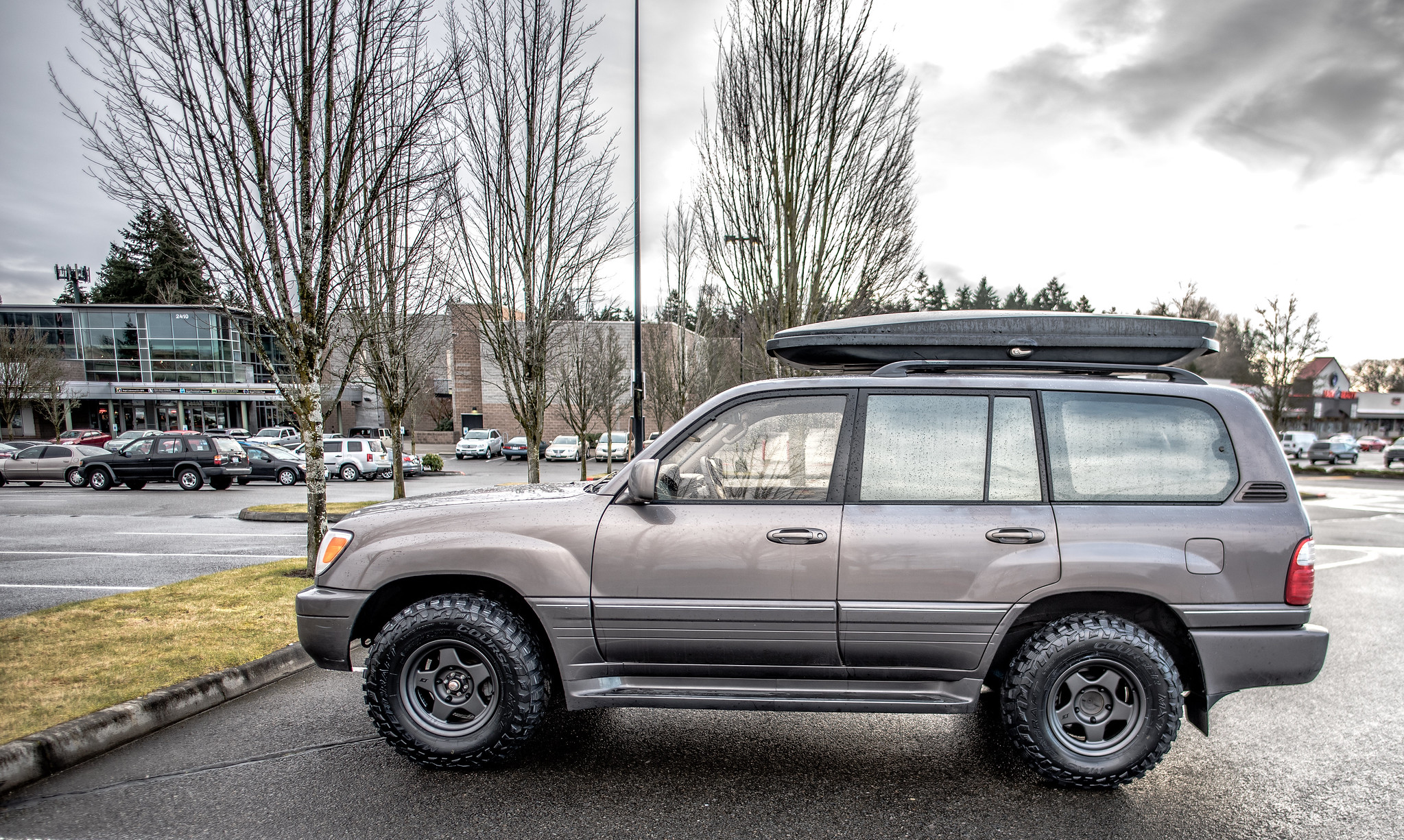

any chance you can gimme a pic of the 295's on your ride ?
... oh and you are saying you run 295's with a stock suspension 100 series LC ... or an LX (is their a difference in standard driving stock suspension height?)
thanx
I didn't post that but I just put 295/75/16 KO2's on mine (with new wheels that have +10 offset) and the fit-ish. Drives fine but rubs on the pinch weld up front when turning. Going to work on that this weekend and see if i can fix it but drives fine with AHC on high so i ordered the slee AHC override since it looks better that way anyway and gives more clearance.
EDIT: That pic is with AHC on H, here is one with AHC at N
