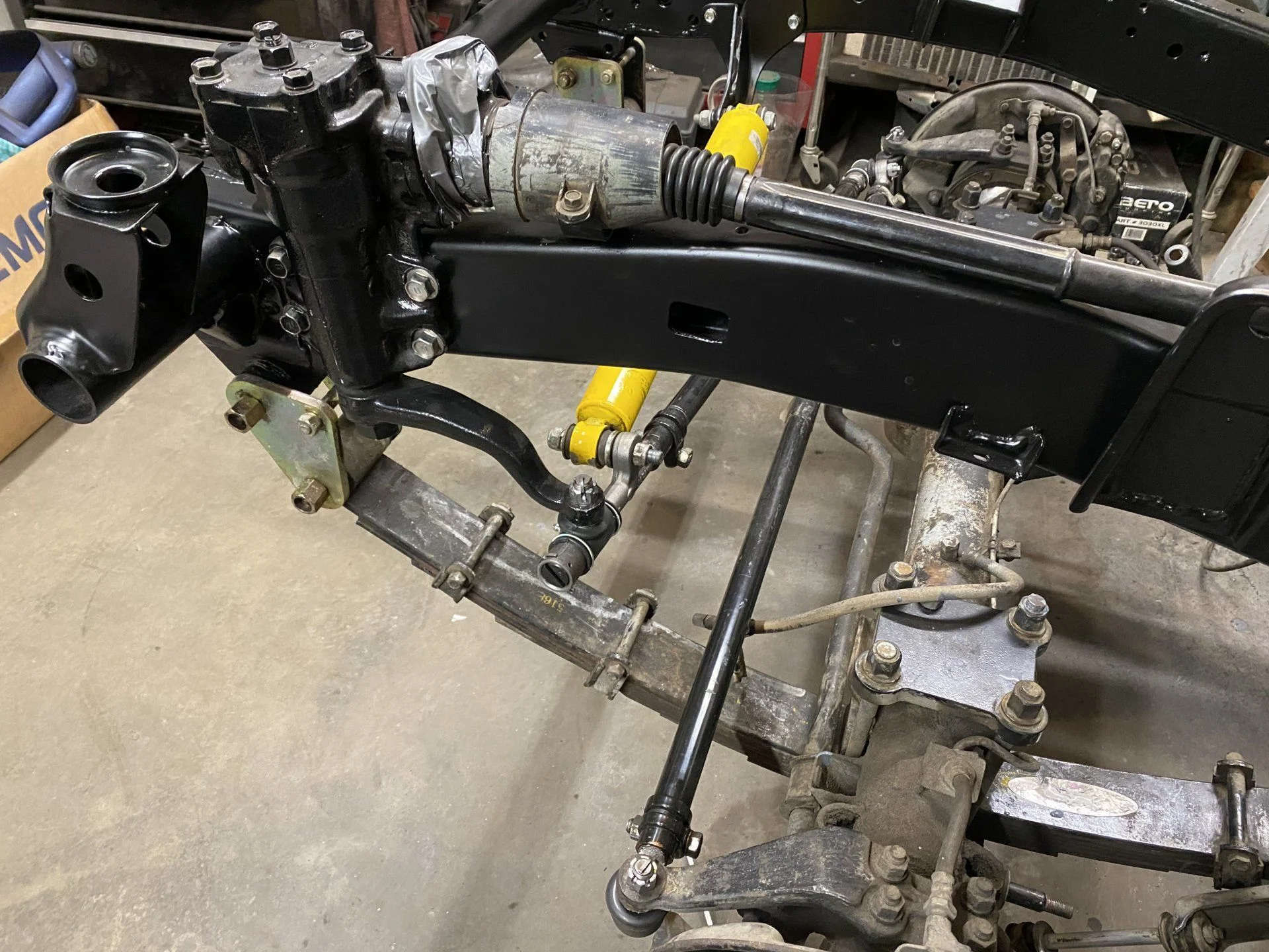

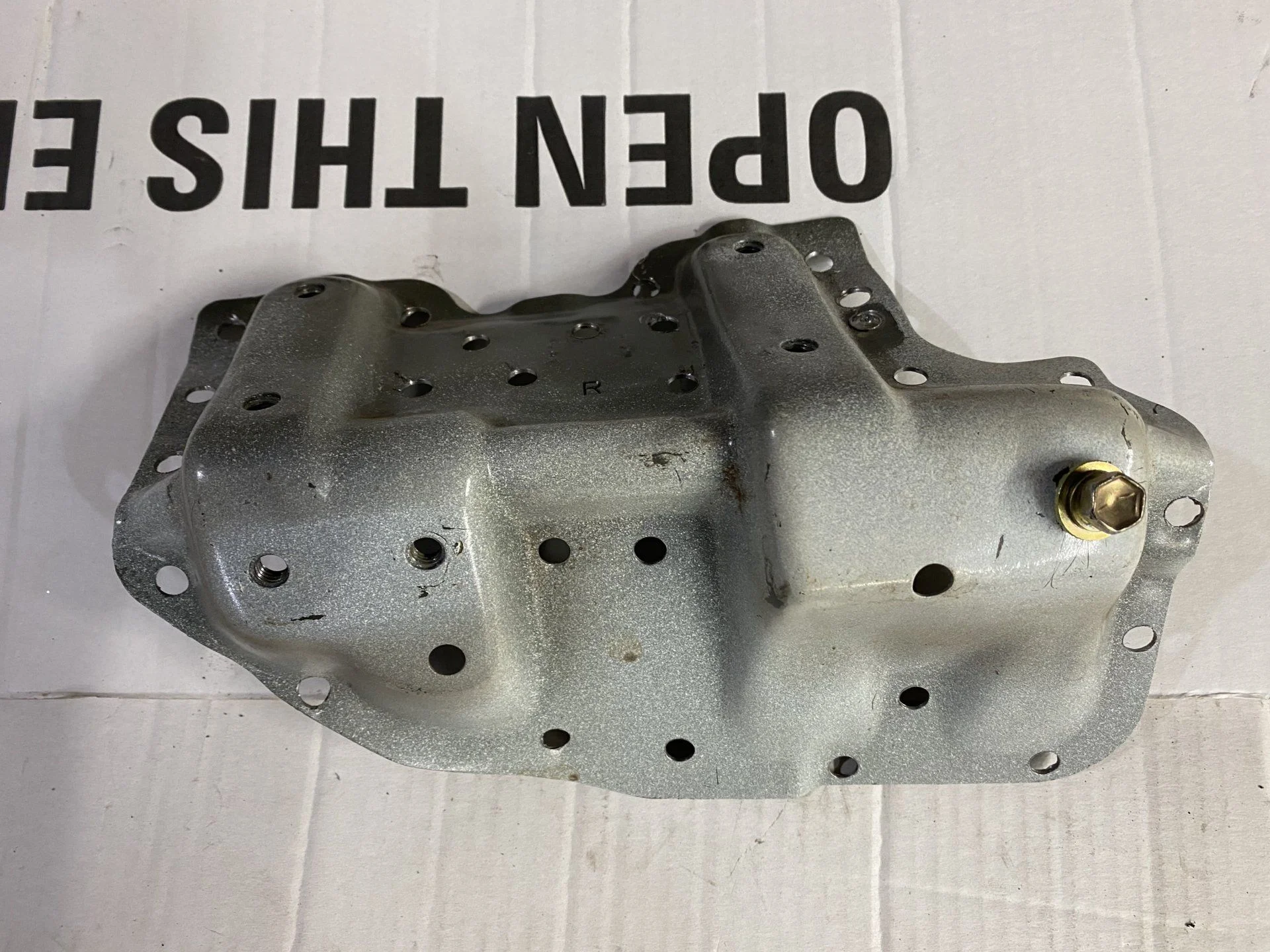

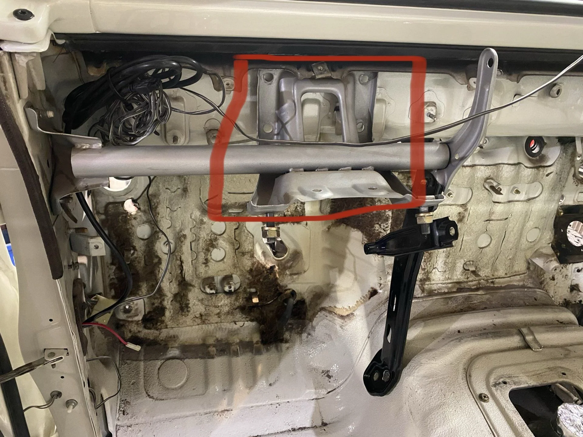

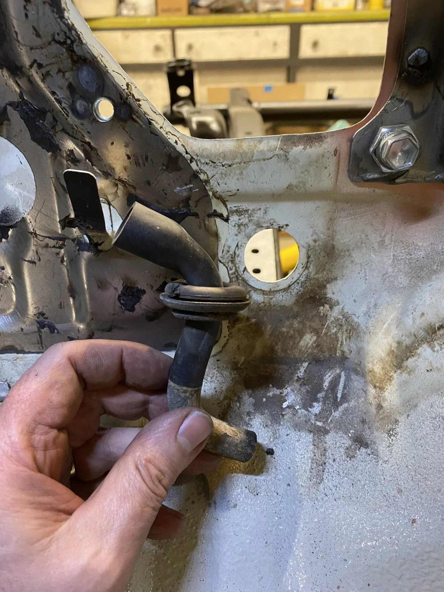

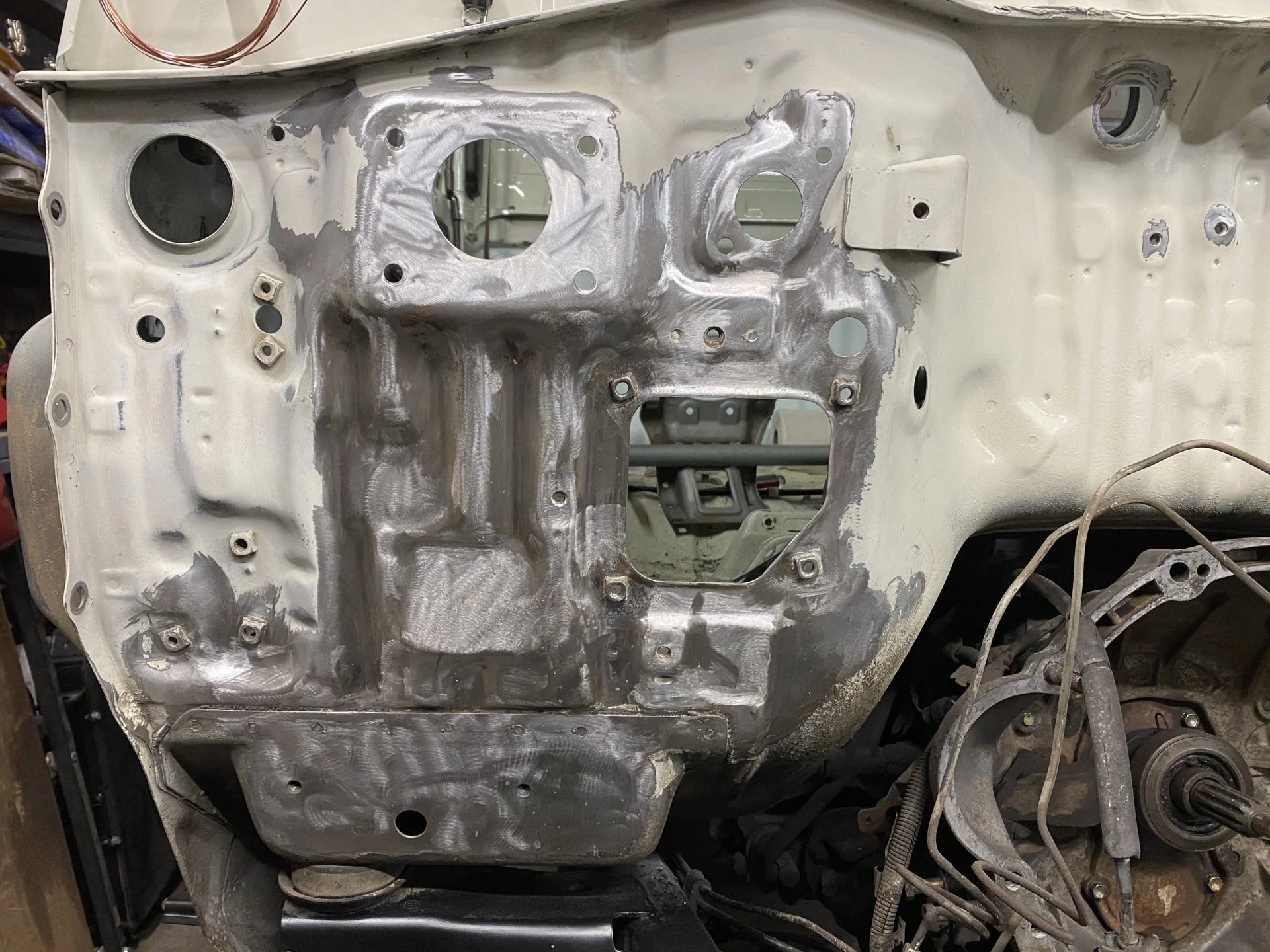

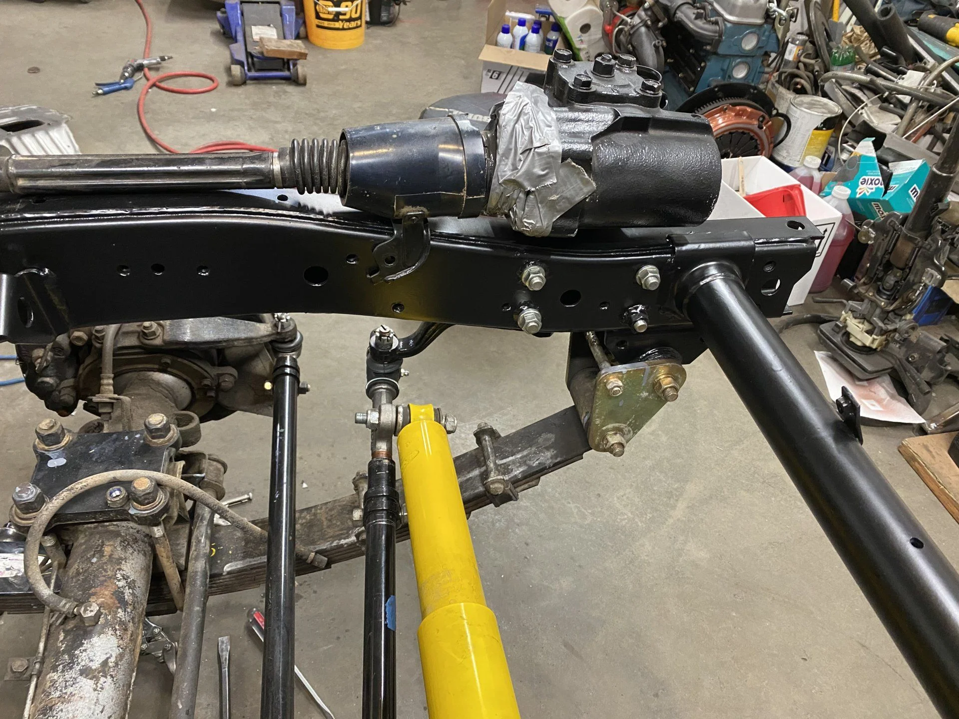

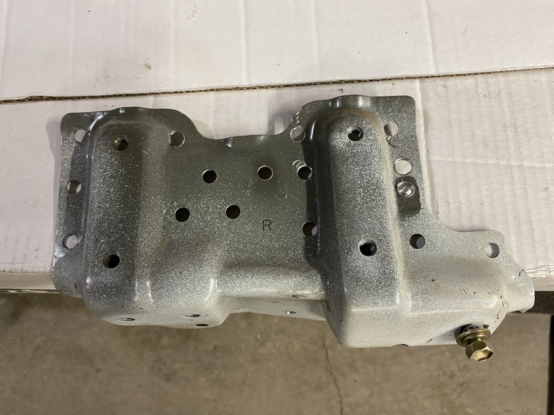

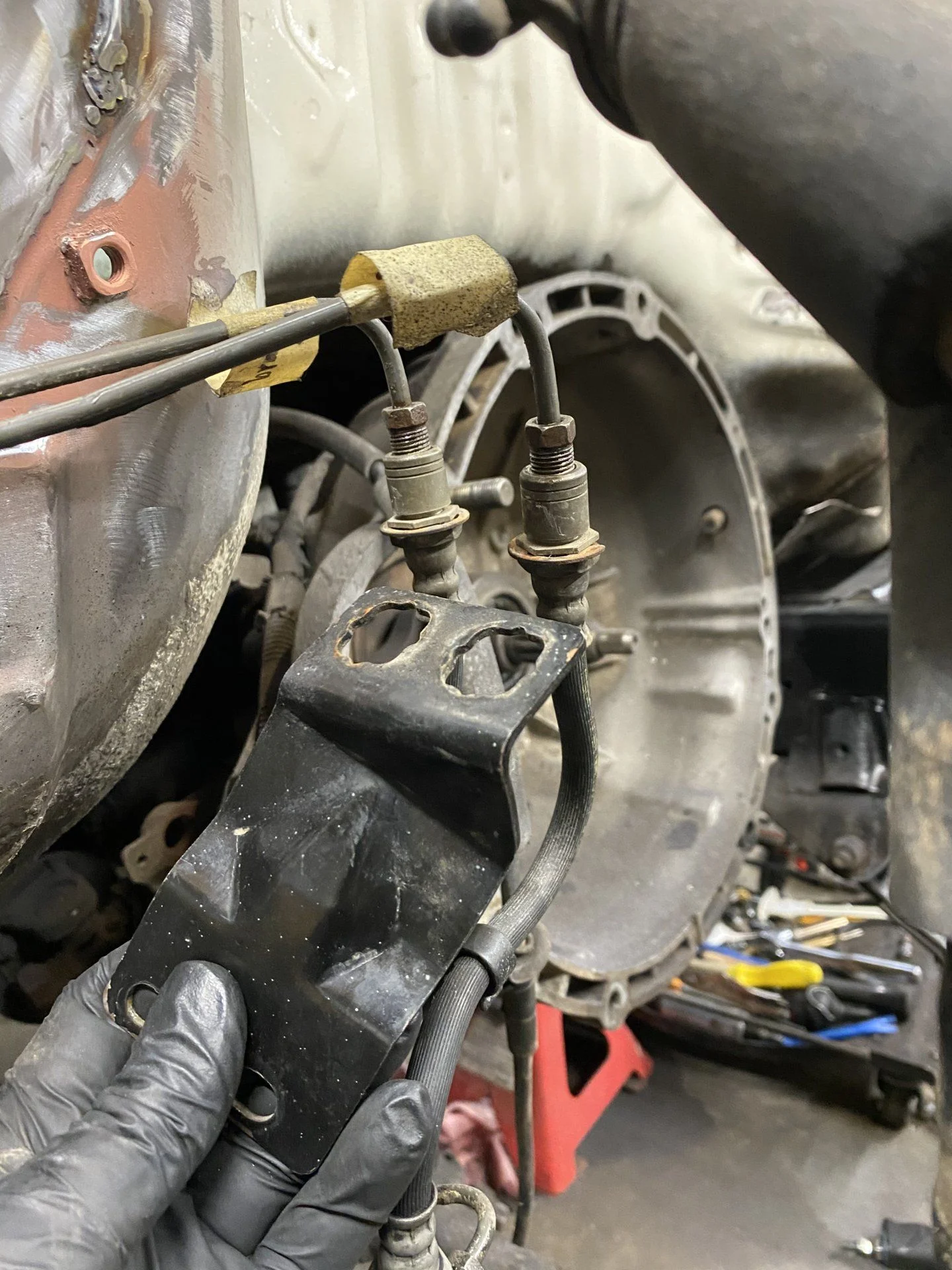

So that piece you’re in need of for the steering column. I’m trying to figure out what it is.
Is it just the piece that goes under the column to bolt it to the support bracket which is fastened
to the round pipe?

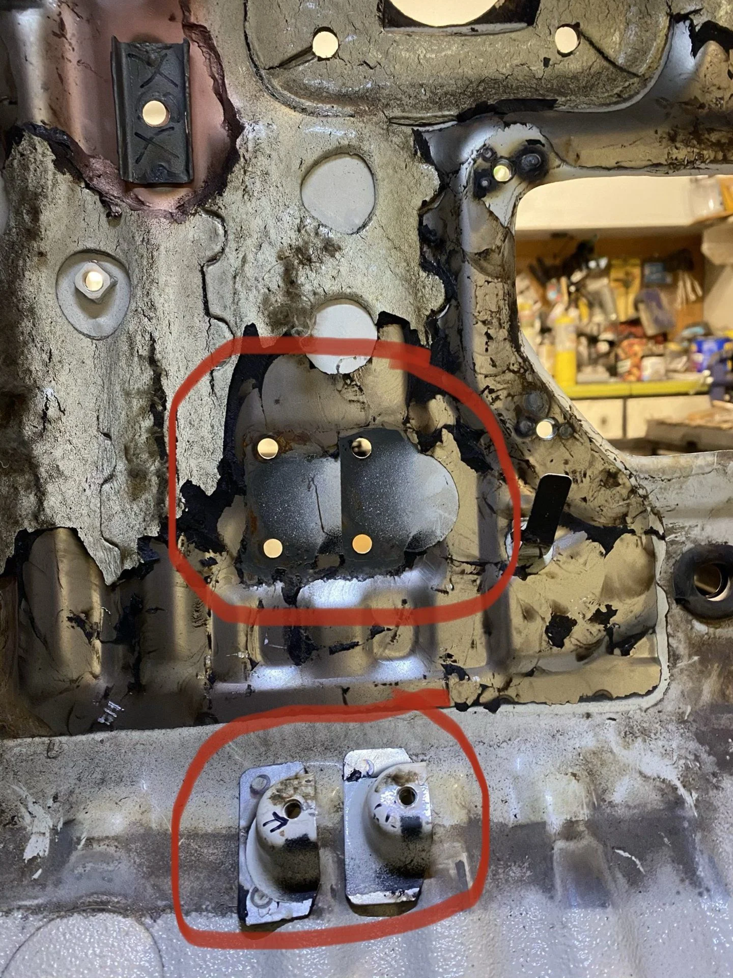

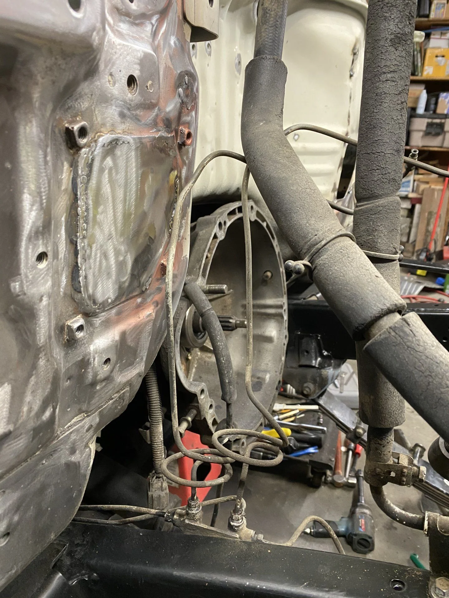

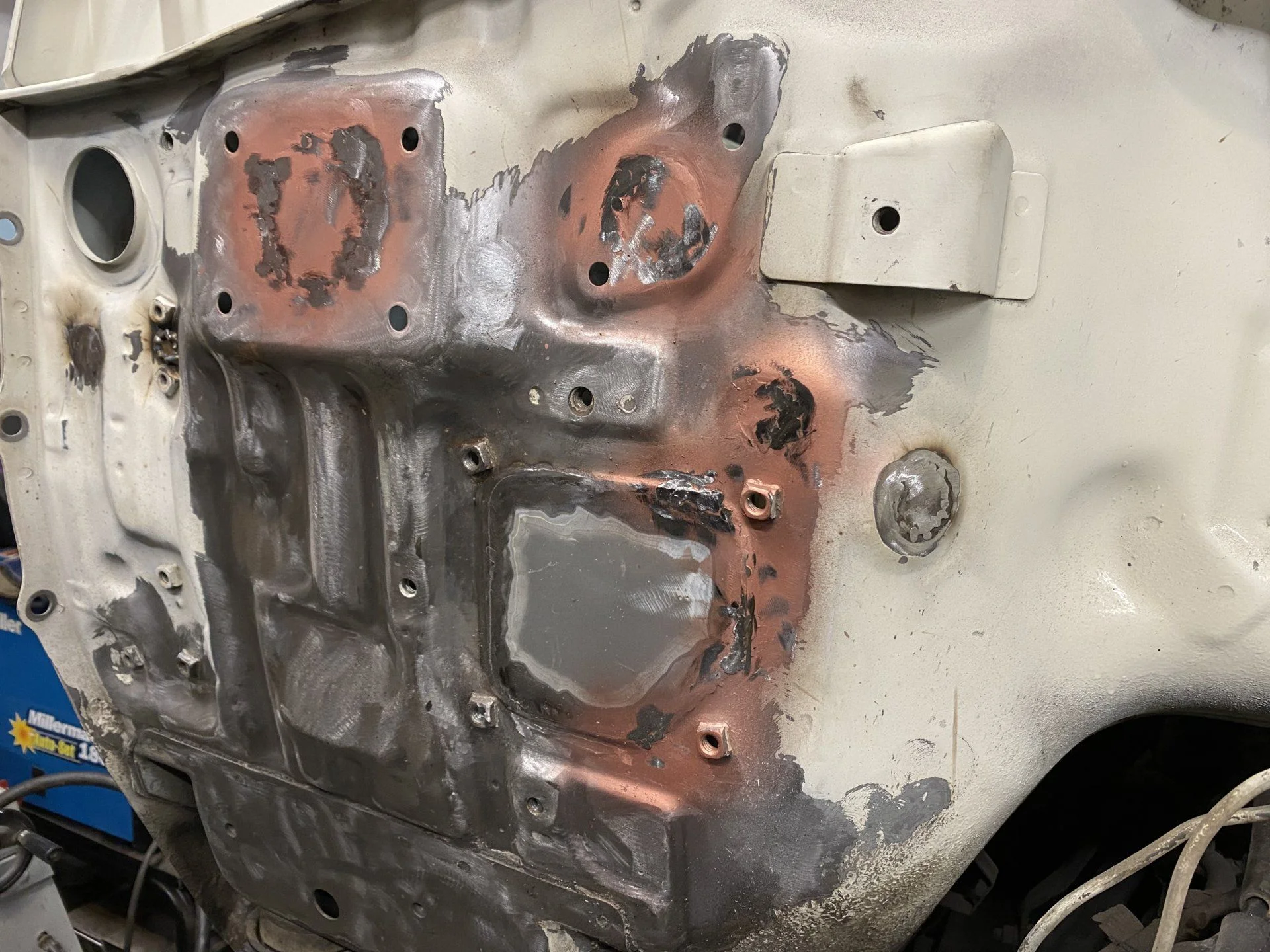

The spot welded piece that is behind the steering support, where this support is bolted up to in the red circle. I think there are six bolts that bolt to this piece.

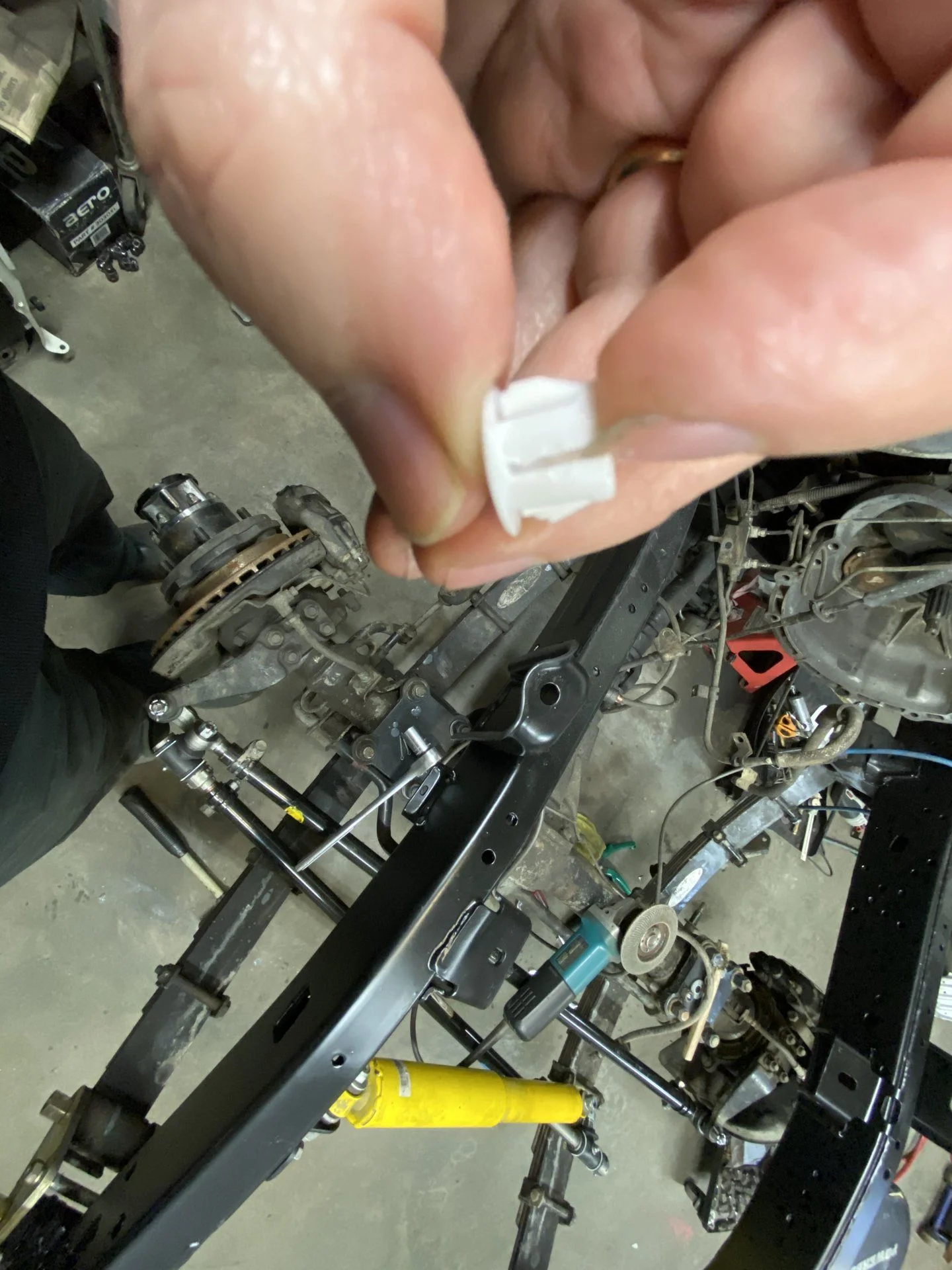

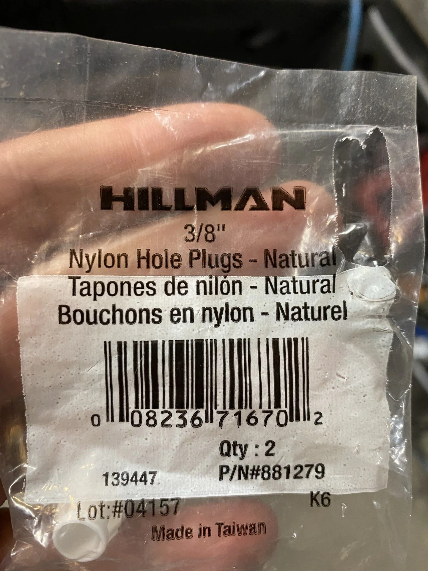

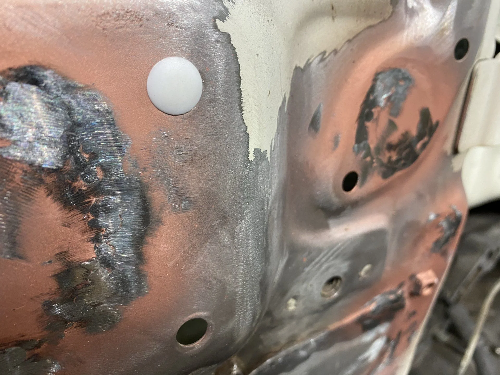

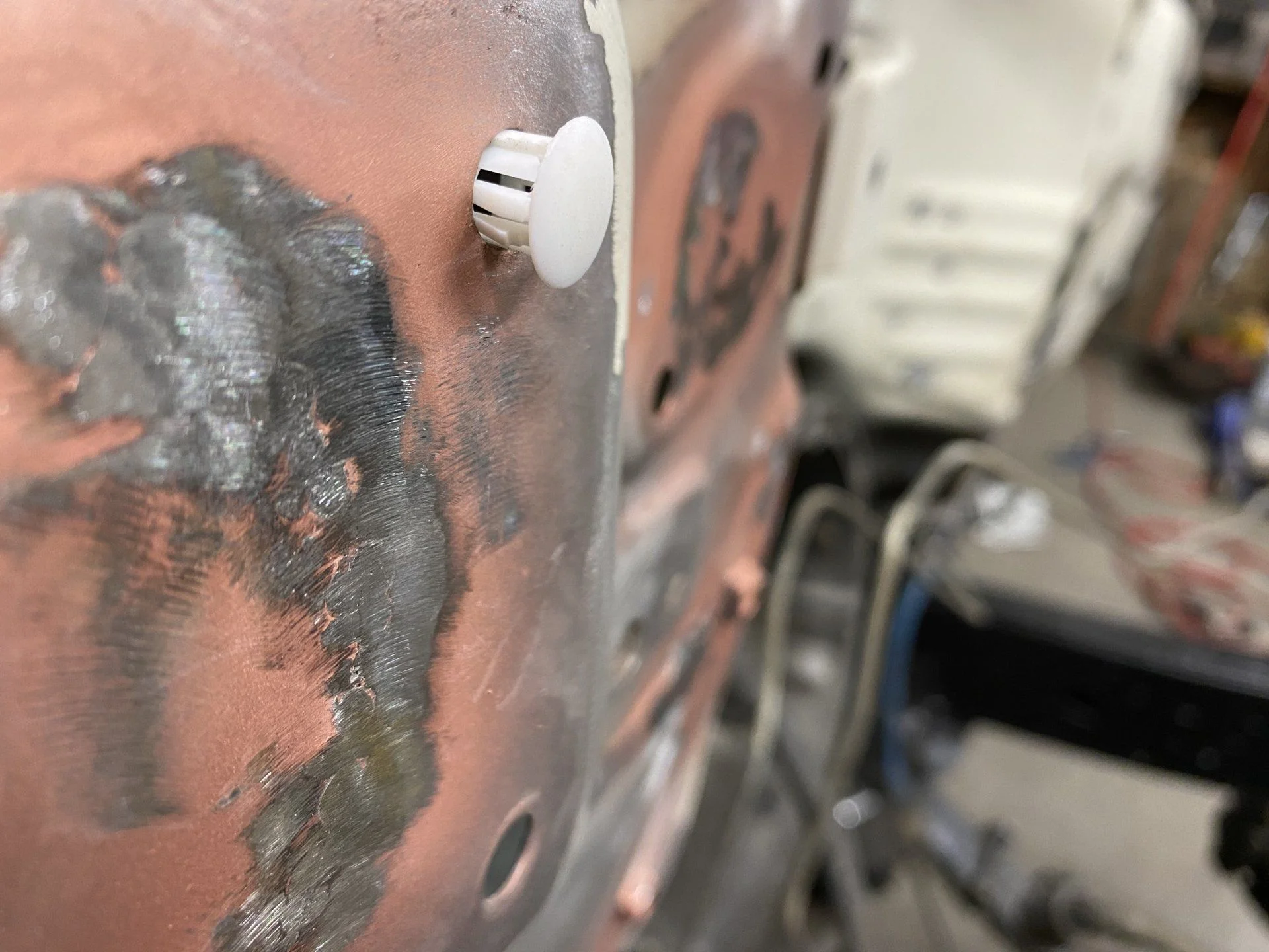

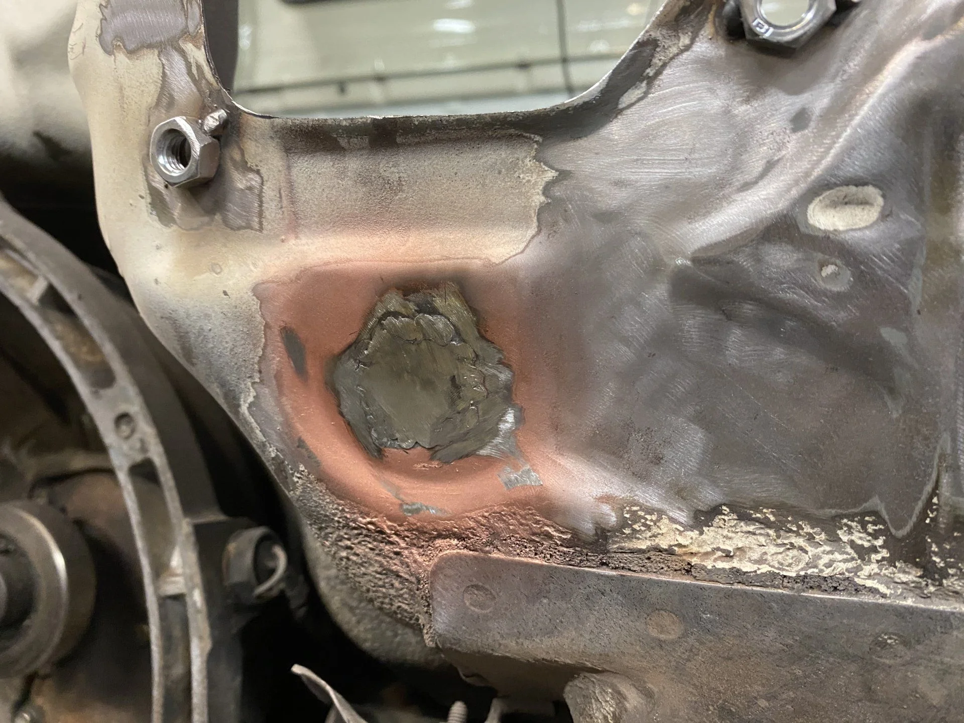

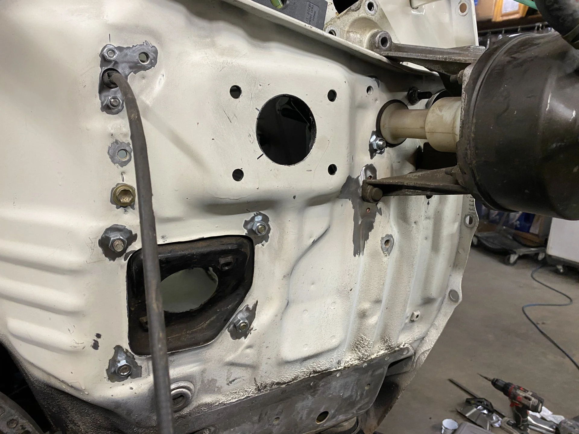

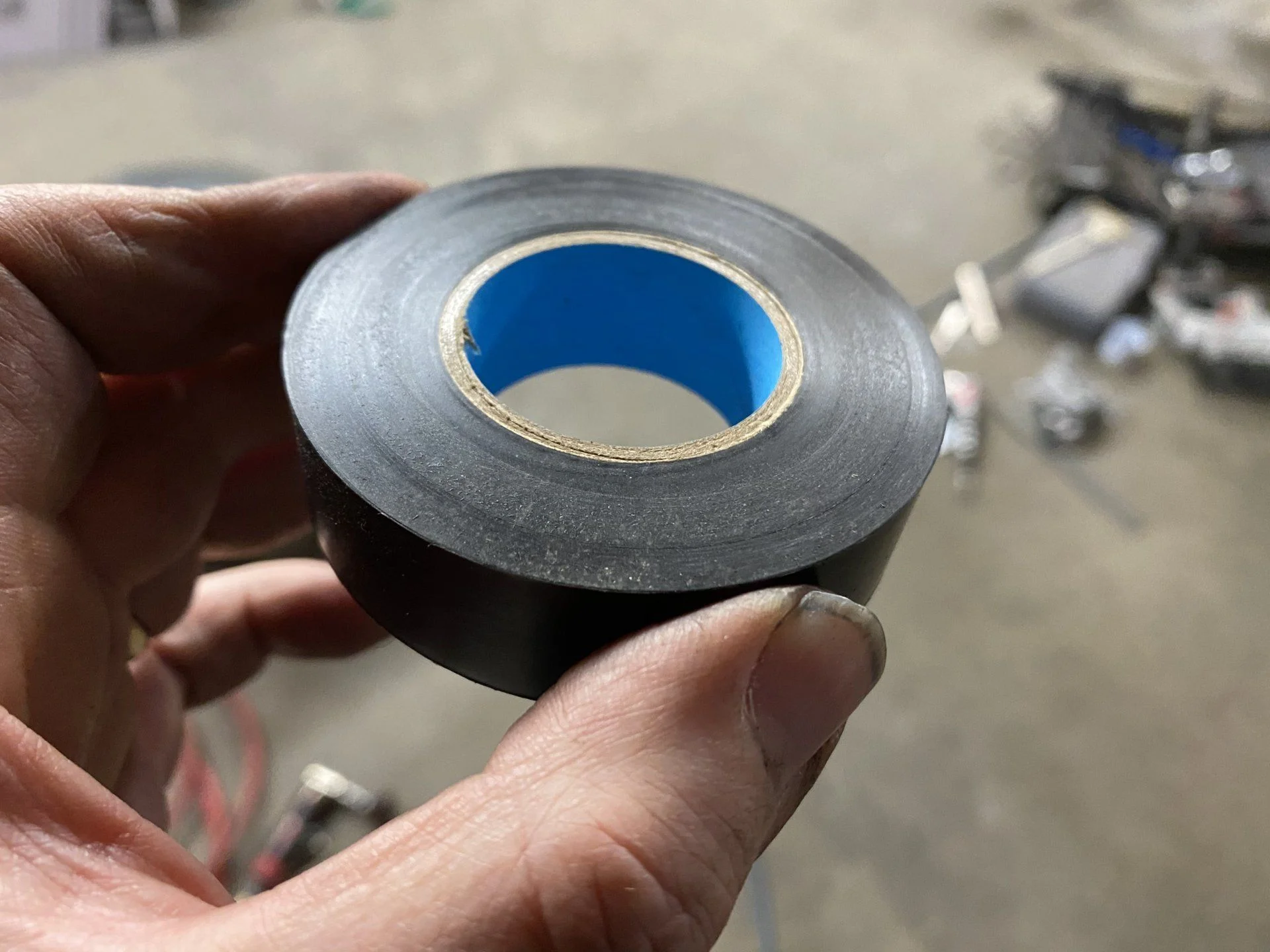

I think I found a good alternate to welding all the bolt holes closed. I will use these plastic plugs from Lowe’s. I had to slice a little out of the sides to get enough collapse to get it in. Probably will use a little silicone or super glue to make sure these stay snug or not rattle.
Is that the structural duct tape?:hillbilly:
