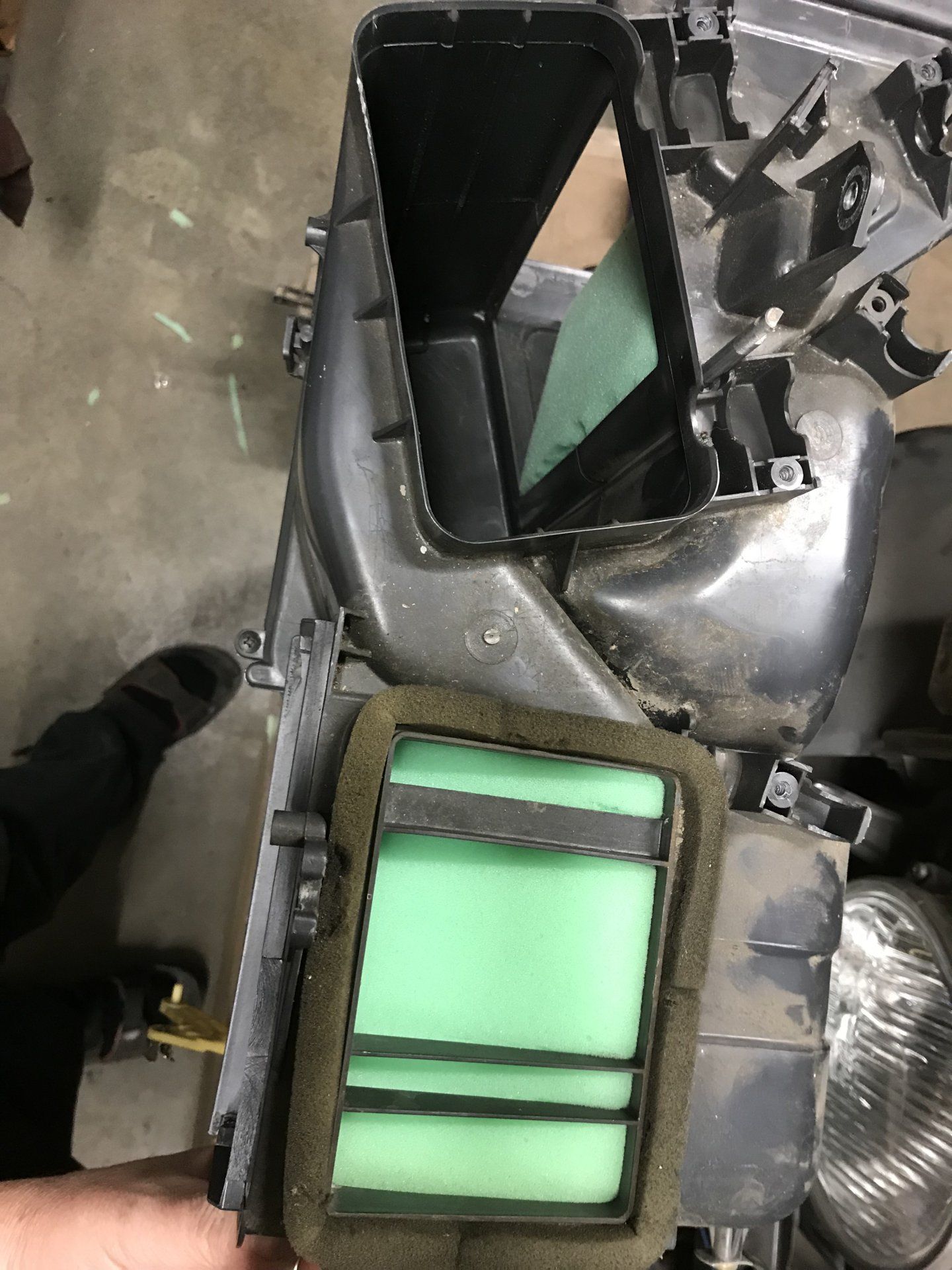

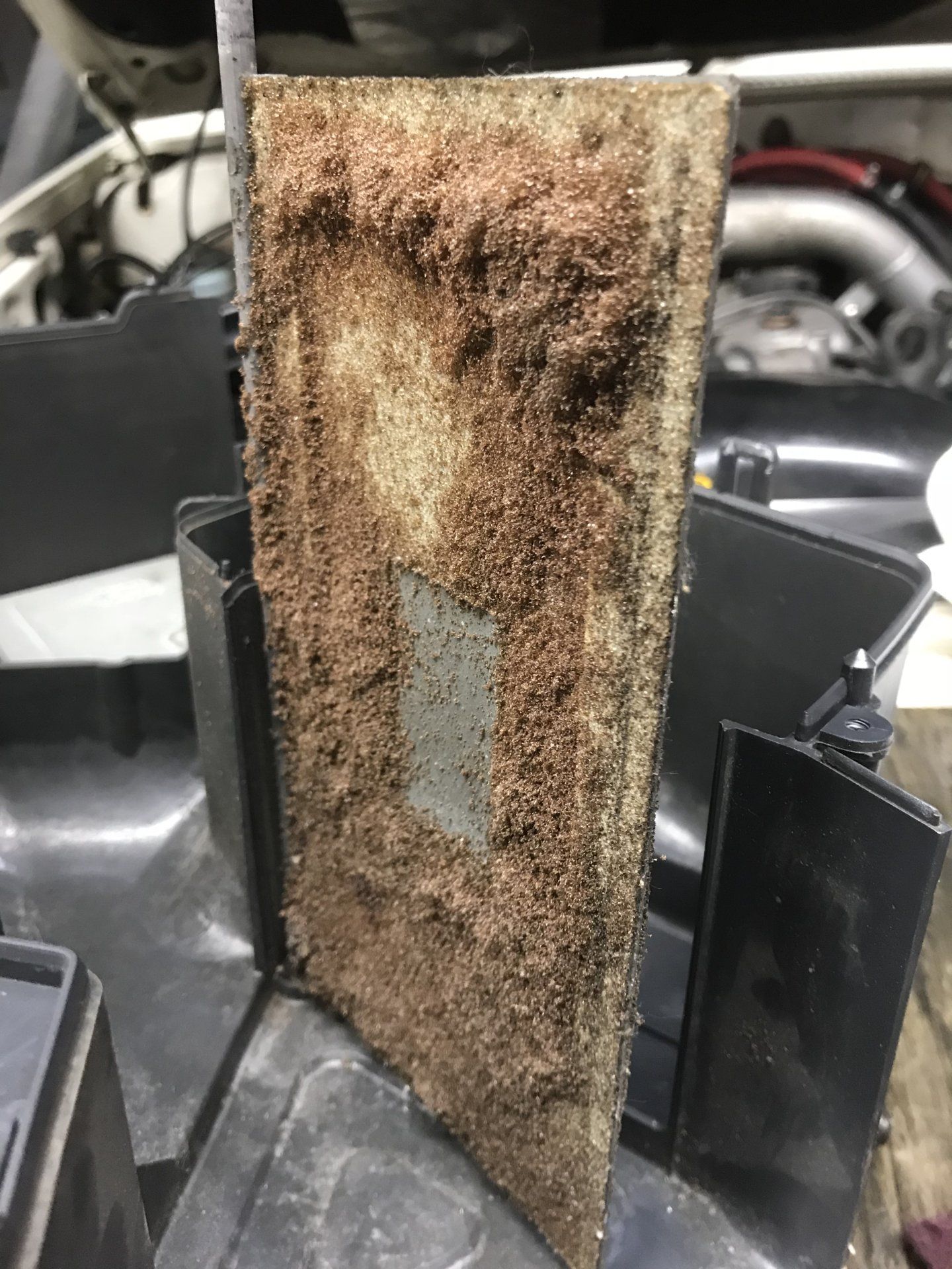

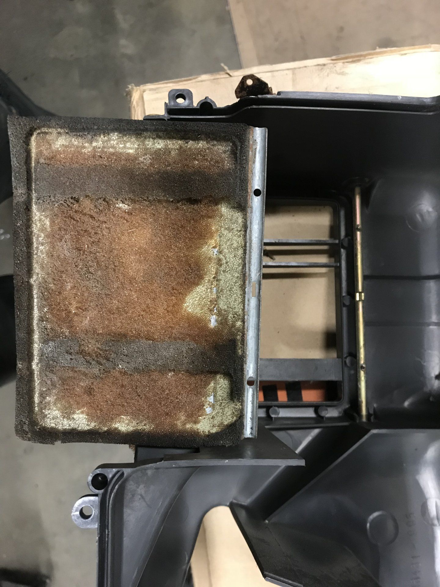

So, been trying to figure out why me espar coolant heater keeps throwing a over temp code. Seems like it will run when engine is running so thinking there is some blockage or obstruction but could not find any obvious, except that’s I could not tell what shape the original heater core was in. So since I had a spare heater box from a lhd lj-78, I took it out and looked it over and ran water through it and seems to be in good shape so decided to swap this one with the original. Before tearing into the dash I also replaced the old foam used on all the doors in the heater box.
