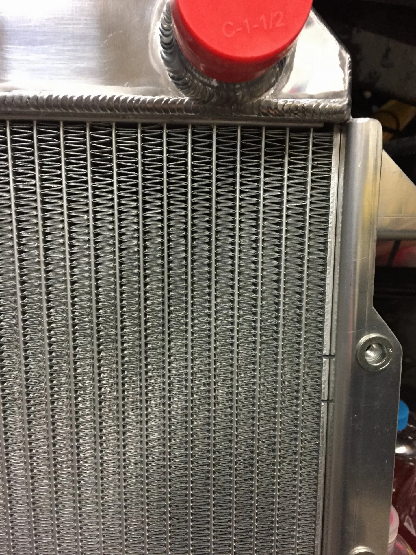

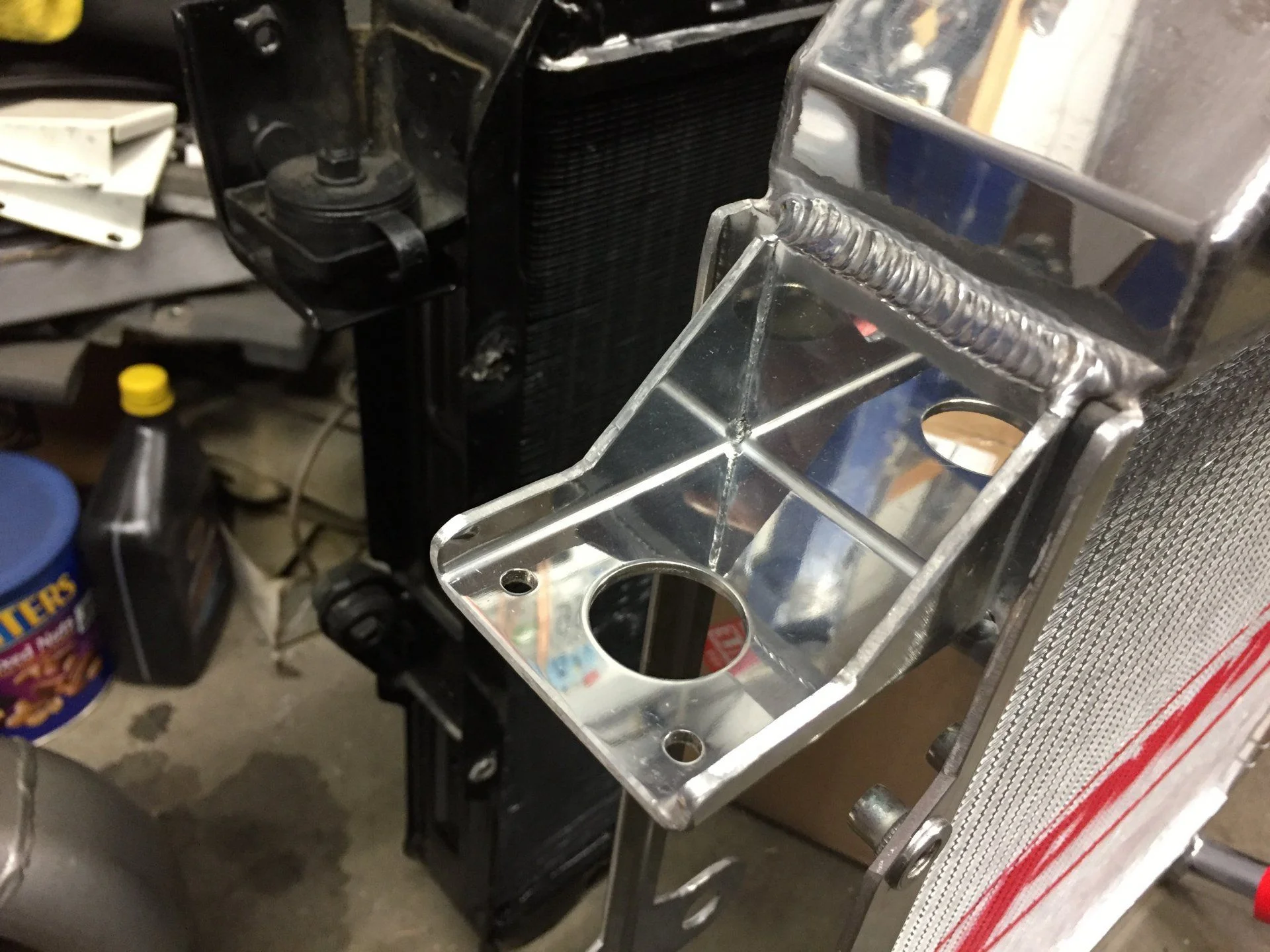

Whats the matter with the old one? Looks like it needs to be welded in.
My rad started leaking again after getting another pin hole fixed. So about 6 weeks ago started working on a replacement radiator from PWR Australia. Got it lengthened 2" and had them install a pipe in the header tank half way across the top for the inlet pipe. Got here today. Nicely packaged.
