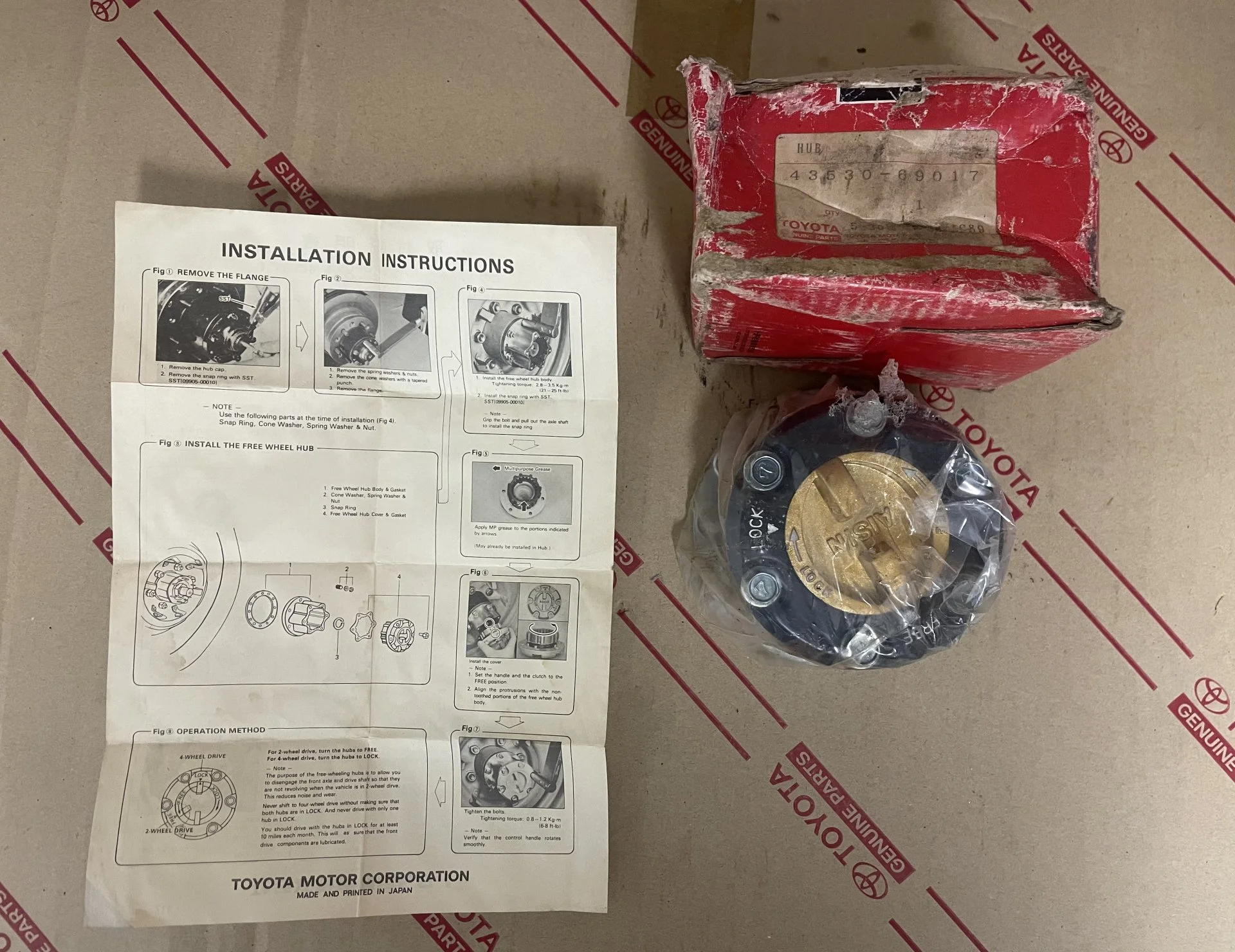

Does anyone happen to have any Aisin “long body” hubs for sale? I've got a '77 front axle I'd like to put them on.
Good luck .. I have one . That I keep for a spare for my 8x. 8x guys will give their right nut for them . Im always looking for them. I have installed reg hubs on 77s before more times that I can count. 2 ways Cheapest it to rework the Birf I have cut new grooves in for the clip with a steady hand and cut off wheel. then trimmed the end. Now days I use the lathe. Find a set of mini truck birfs and switch them. . I have a good set of used reg hubs. $120 for the pair. Sadly all my mini birfs aren't for sale. I use them for disk brake conversations. Mini stuff is getting hard to find.

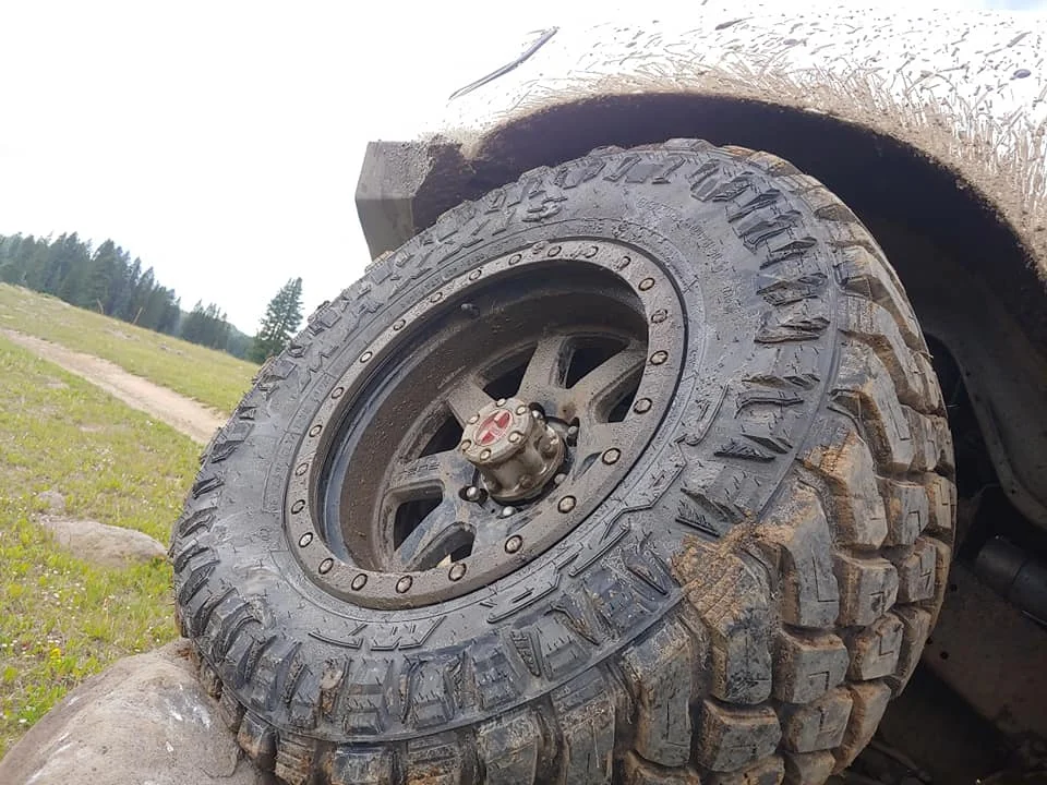

I broke a set o those 1st trip out they are china made repops. Cost my 2 birfs and tore up my housing pretty bad.

Ad says they are repops, Did you read it?.OP asked for Aisins . I have Aisins on my 8x now. I wheel the s*** out of it. not a problem. I cracked the housing 1st run on the repops fro city racer

From what I experienced. I would say no. I broke the housing not even near a bolt or even a pressure point 1st run. Took me a few yrs to fins REAL Aisin long hubs. I beat them like they owe me money not a problem. The metal in the break was very pourse. like most cheap castings are. I would run an AVN before what Citey racer offers as a long hub. and for the record most of the stuff we buy from them is pretty spot on

I’m working with them on the knuckle rebuild kit. They do not have a new long body locking hub.
Wondering if enough people request a quality aftermarket long body free wheel hub cruiseroutfitters might be able to have them reproduced??
