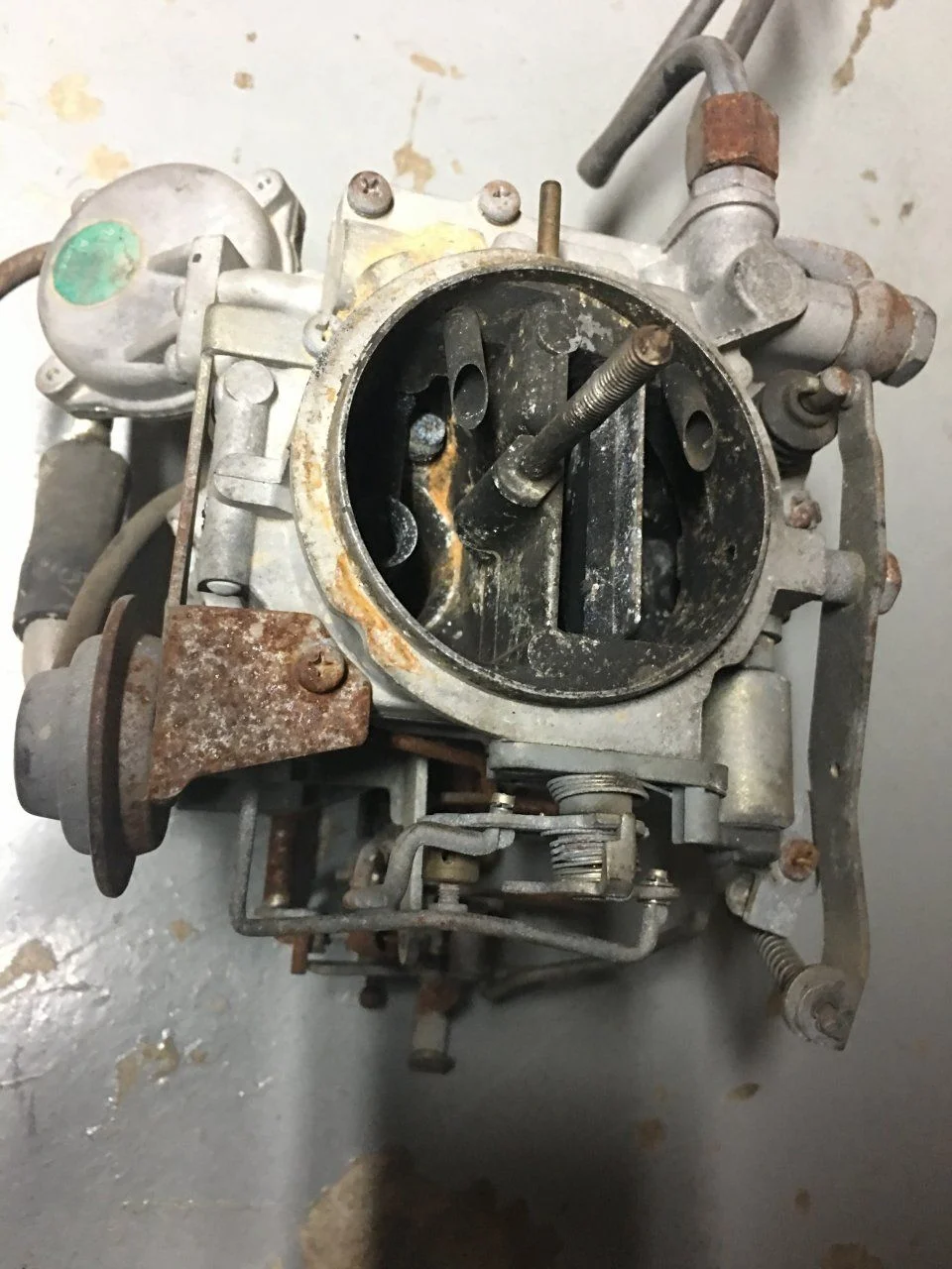

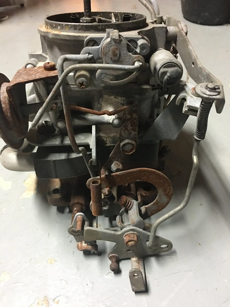

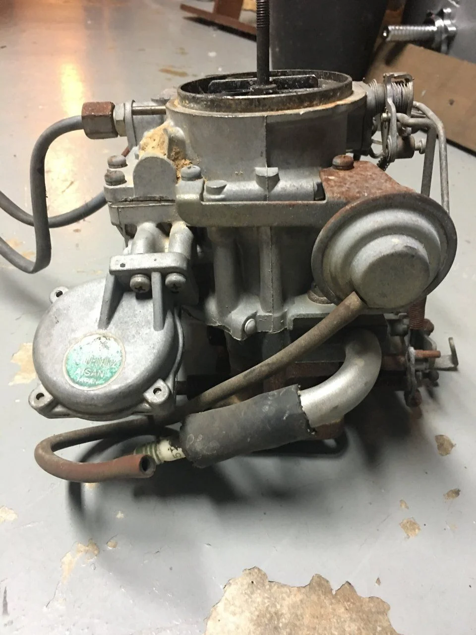

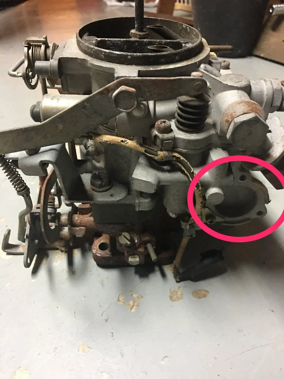

I had a friend give me a stock carb (currently have a Weber).
I'm chomping at the bit to rebuild it and learn to tune it. It's going to make a great winter project. Really appreciate your videos! Thx for serving mud well.
I do have a few questions.
Is there something missing (see location circled).
Also.. the date code leads off with a 1. Do you know if it's a 71 or 81? Not sure if it matters or not...
That carb is a 1976 federal 2F spec, built in august 1981 to be sold as a service replacement part.
It will work on a desmogged 1978 2F.
Good luck.
Makes sense. I had looked through the pics on the sor site to date the carb and also thought it was a '76. I was thrown off by the date discrepancy. Service part makes sense!
Thanks @FJ40Jim and @Pin_Head!
