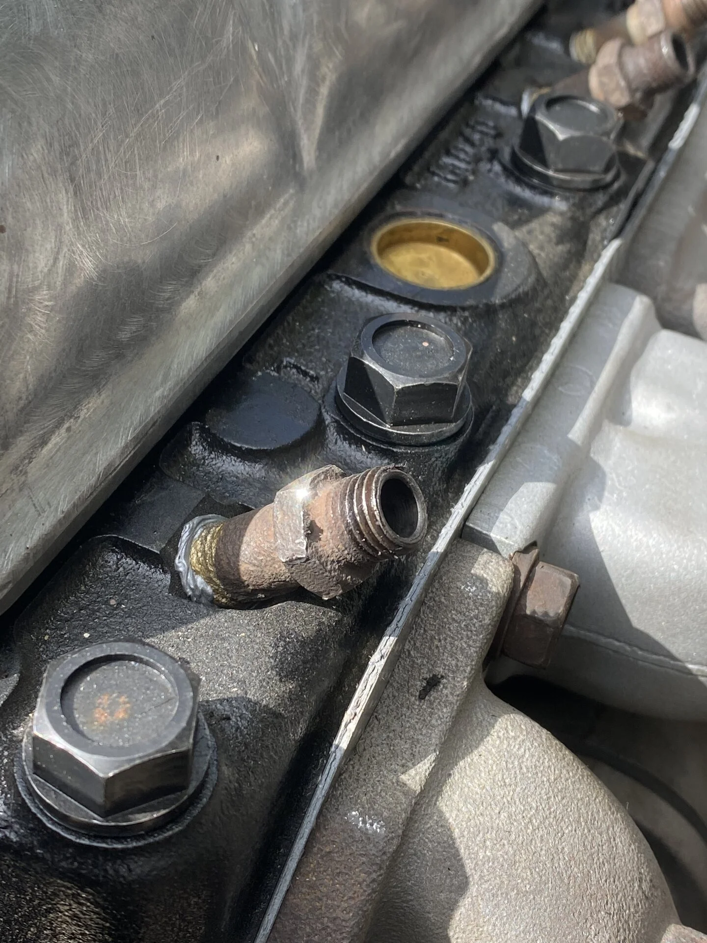

Good question!! Been trying to find out for awhile now. Nothing in the FAQ I could find. Is that antiseize around the injectors? Was tempted to do that to but with the temperature I decided not too.

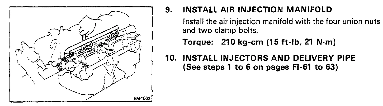

This is for the FJ62, but I assume it's similar on the 2F?
Thank you for sharing! Only thing this instruction is missing, is the torque required for the air injector nozzle “The fitting that screws into the head”. This looks like the torque value for the compression fittings. Those fittings are attached to the air rail and screw onto the top of each air injector nozzle.
