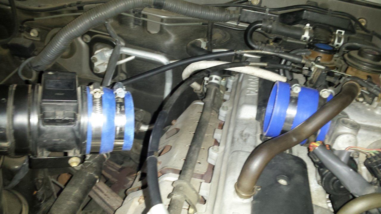

I got all the tubing from advanced, A 45 deg and straight, Used the OEM coupler on the air filt MAF end. i also had to raise the two front mounting legs on the air filter housing to line up the housing to the intake. I just used some Energy suspension sway bar link bushings (red) and longer bolts.

View attachment 938824View attachment 938825
did you have to photoshop in the sparkle? :flipoff2: Looks nice
Why would you put a rigid piece piece of pipe between the top of the engine and the air cleaner bolted to the fender? The engine moves under acceleration and engine braking, the rigid pipe should break the mounts off the air cleaner or something else will give.
Not to mention use metal that will get hot and increase your IAT. Even though it's after the maf the exhaust mani and engine will heat soak the part.
