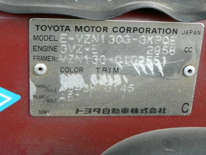

If I'm reading this correct w/ this info HERE
You have factory 4.88's with a 4 pinion limited slip?
