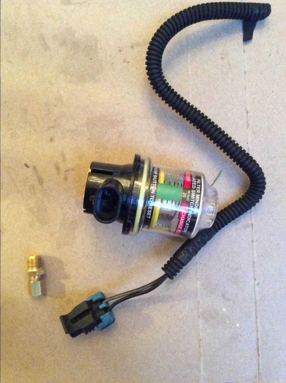

I ordered one last October from EBay with the electrical connector. I picked up a few male connectors at the wreckers today. The elec connectors are used on some GM vehicles in the engine bay for various things. I'll install the filter minder tomorrow, but it will likely be some time before I wire it up. I should have figured out the wiring when I had the dash out. :doh:

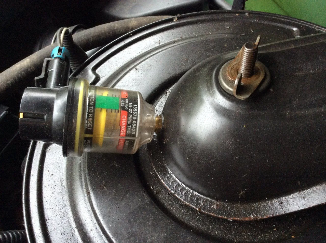

I'm still running the cleaned filter, installed 9/13. It's sitting at 8, not going to do anything till it shows over 20, so a couple more years?

I haven't checked but I assume the electrical signal is simply on-off. I purchased this version with the idea of one day wiring it into the clogged filter lamp. There are some links in one of the earlier posts with details. It's a bit gimmicky, but what the hell.
Installed mine yesterday finally. I'll try to wire it up to the dash light this spring.
It came with a Metri-Pack connector?
No, I picked the connector up at the pick-n-pull. Checked it yesterday, and it has actually moved!
I thought I would post an update. The filter minder shows that the filter is clogged, so I removed it and inspected it. It looks less dirty than my previous filter, but I decided to clean it as per the instructions. I installed the old one, and will monitor what the filter minder shows.

After replacing my filter and resetting the filter minder last year it has moved again. I will take some pics tomorrow.
