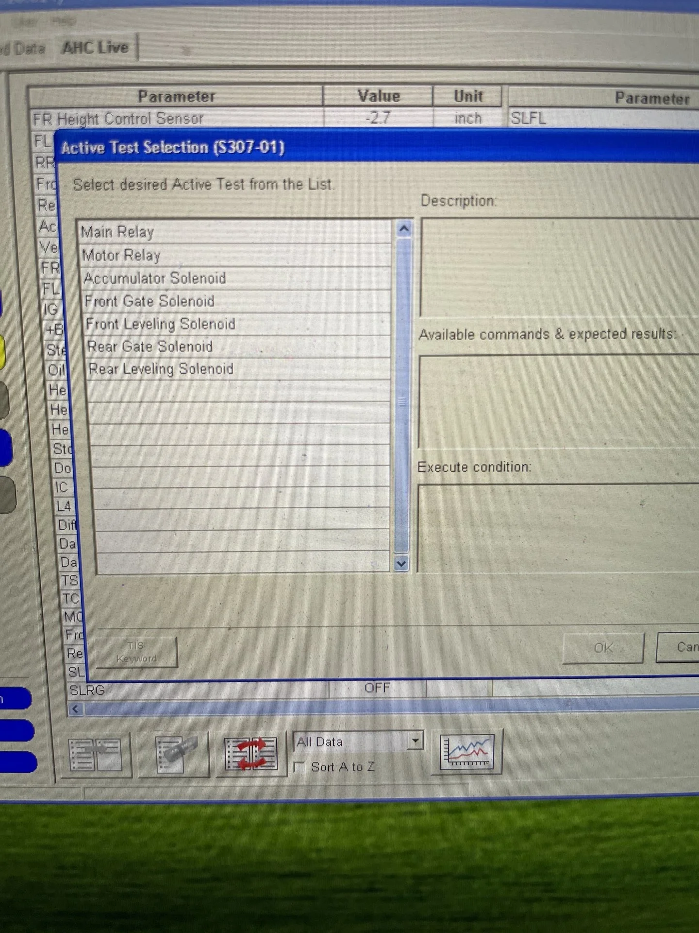

Is there an active test (go into the tab on the right) that allows you to manually run the pump? I forget and I don't have my new laptop running Techstream yet.
Next option for me would be to manually jumper the pump on, but hopefully you can manage that via Techstream.
