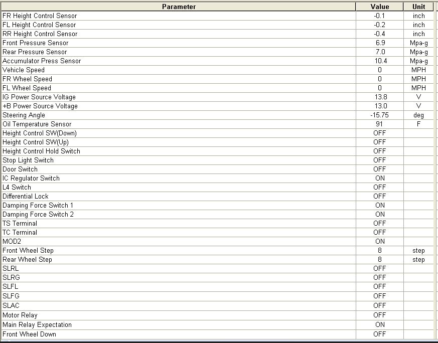

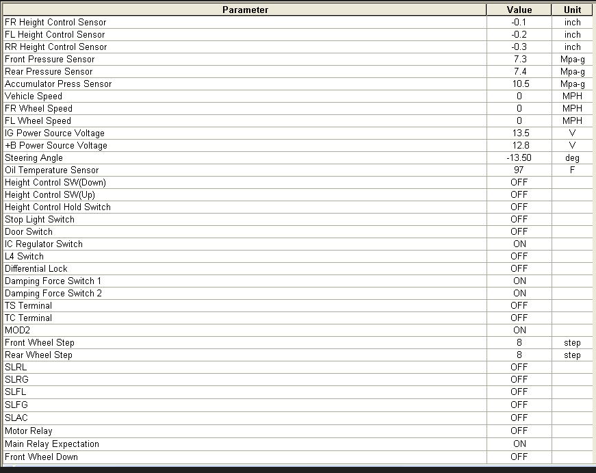

I used your video on YouTube, thank you for putting that out. I did not unplug the pump temp sensor but did get the Codes and data below.
Readings after 1st L to N cycle
Readings After 2nd L to N cycle

I'm not sure about a clicking sound, but the pump will squeal and screech when it has air in the pump. I would try bleeding each corner and pay very close attention to bubbles. If you see bubbles you might have a dead globe releasing air into the fluid. That will give you partial function of the system, but it will be loud and unable to lift at times.
Another user recently had new-ish globes fail oddly fast. Perhaps there was a batch with poor rubber or something during the pandemic. Those are normally 5-10 year parts, but we've seen some fail much sooner than that.
1762 is the most common code and appears in all kinds of situations.
Where is the grinding noise coming from? Engine bay, from the AHC pump or below the driver front door, around the accumulator and valves?
It's doubtful the torsion bars were the root cause of the issue, your pressures seem fine.
