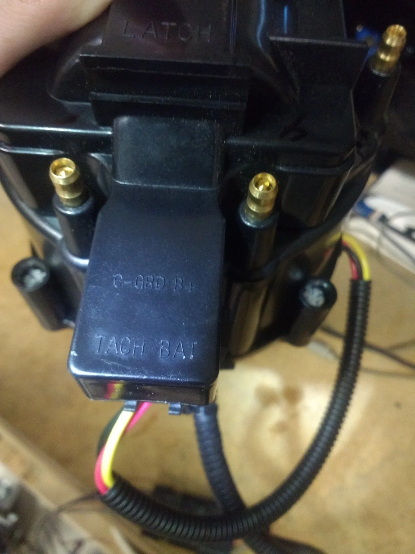

Jumped the gun a bit ...there is an adapter plug that matches the harness, so I just need to splice into that.
There is a 'tach' and 'batt' connection that I don't know what to plug into it. Is the batt plug constant or switched 12v? I'm guessing 12v switched. Is the tach connection just for a tach or does something else go there?
