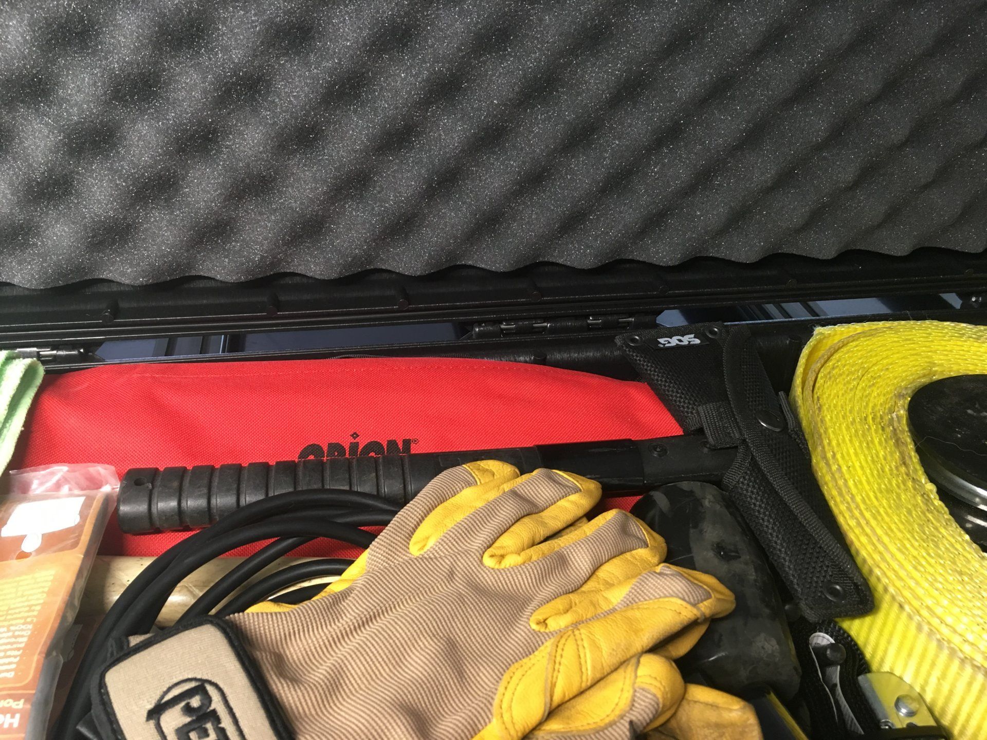

I have it mounted with 4 carriage bolts through the case to the prinsu rack. Put some silicone on before the 1 1/4” washers to make it waterproof. I have heard about thieves unscrewing the crossbars and taking everything.
Almost forgot the most important item. The throwing axe.
