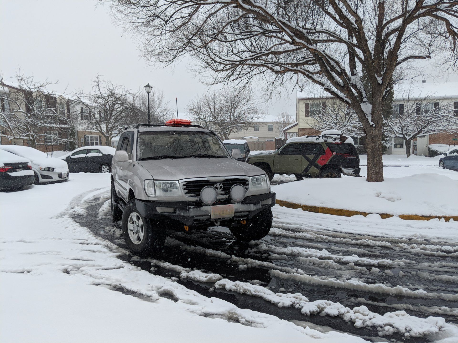

Haven't been out on the trails yet with the lights but I've turned them on in some back roads with no one else and they are bright! I do need to re-aim them however. There is a slight purple/pinkish hue with the lights. Hoping the weather warms up a bit more consistently here and I'll be able to get out onto some trails again.

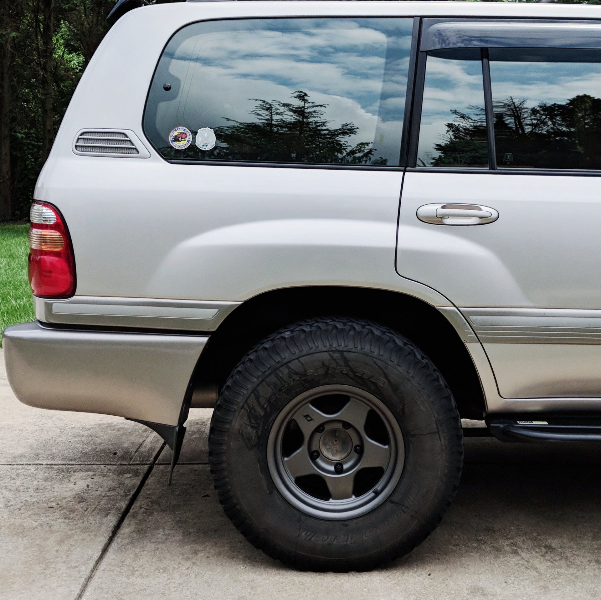

Installed Trail Tailor extended sway bar links.
Easy installation. Just parked on a flat surface and crawled under the truck.
For the rears I had to undo the boxed in mount. (and yes salty winters here. Will get the underbody sprayed down ASAP!)
and be careful with the 2 small bolts holding each mount. They'll probably take some persuasion to get out.
