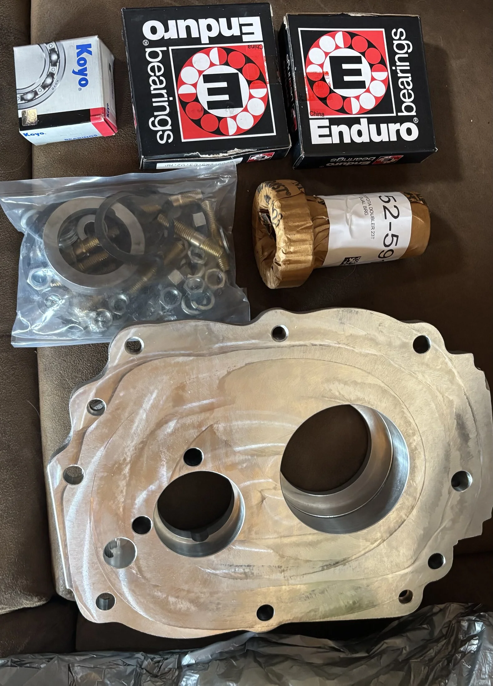

I believe this is the bearing (x2) that I replaced the Chinese bearings with. They are also available from Koyo. 6209-2NSE/RS/2RS Nachi 6209RS Bearing Made in Japan | eBay - https://www.ebay.com/itm/130377112829
Double check before you order this. It's been many years but, I did save it in my eBay watch list so I'm pretty sure it's correct.
Note; I looked at the website and the parts list. It shows 209RS as the bearing but you can clearly see 6209RS on a pic of the bearing.

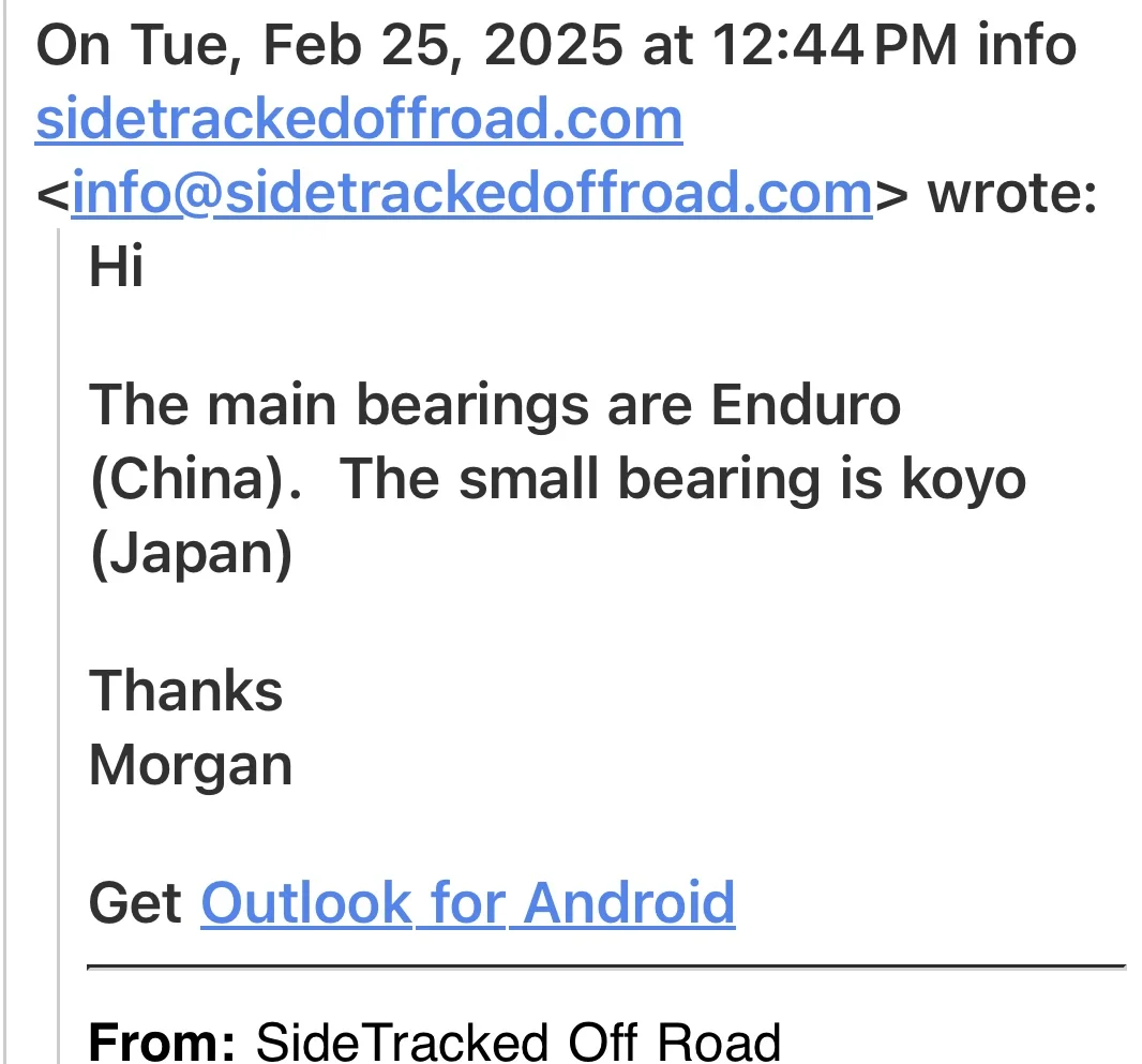

Thanks! I have contacted AA to confirm.

Got a reply about AA TX2 bearings.

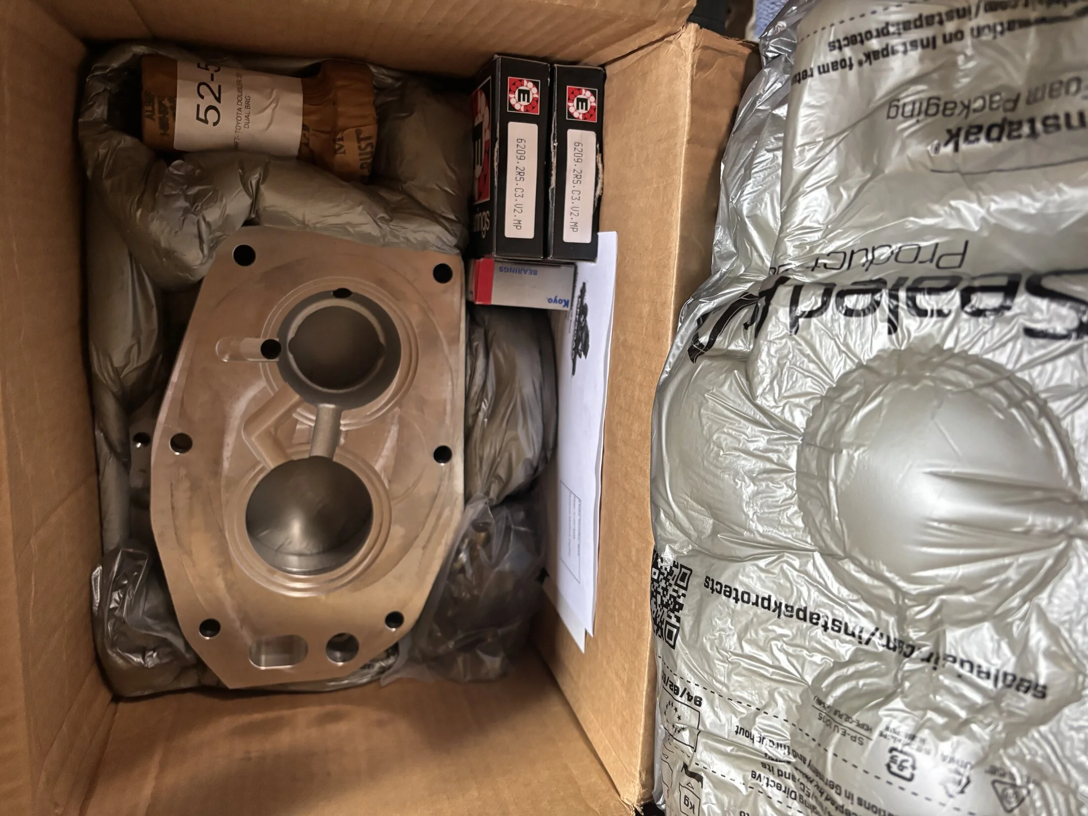

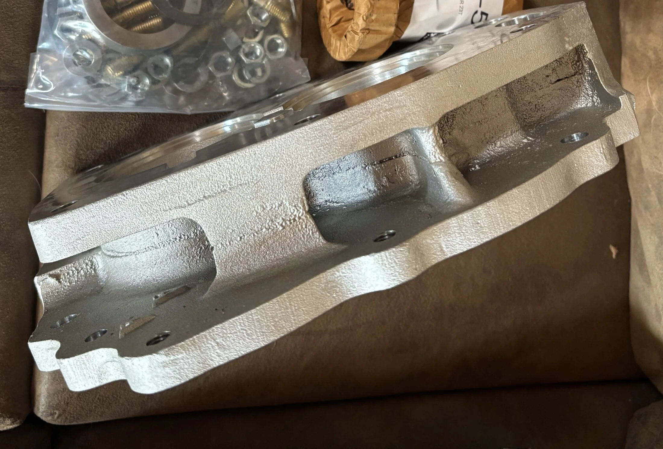

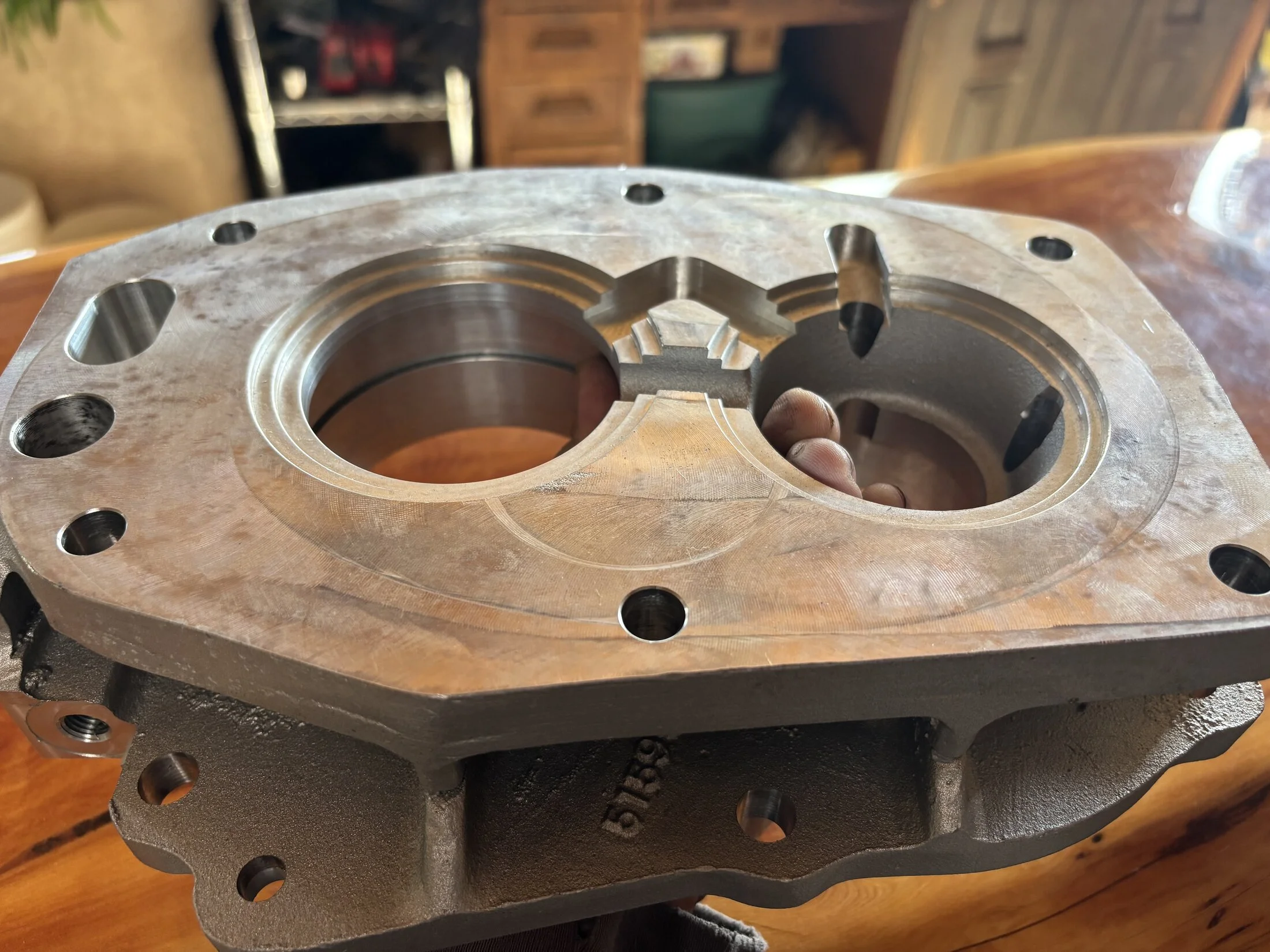

I received my AA Tx2 23 spline from sidetracked offroad For 405$ free ship and no tax. Packaged very well!
You can see the lack of quality attention to detail leaves something to be desired. The first is 2 Chinese enduro bearings, I will replace with Japanese Nachi bearings I got from an eBay industrial warehouse supply, 2 for 55$
Second is rough casting and machining surface. The price was right thou, I hope it lasts as long as @aztoyman’s does in his awesome Rig!
Definitely not as pretty as the Marlin or even the TG adapters. I was underwhelmed when I first saw mine. Pretty sure I got it on sale for under $200 back then so I wasn't going to complain too much. So far so good in my truck.
It seems a lot of the failure complaints of any brand was the coupler splines shearing so I packed mine with ???? Something, Grease, anti-seize, assembly lube?? I wish I could remember.

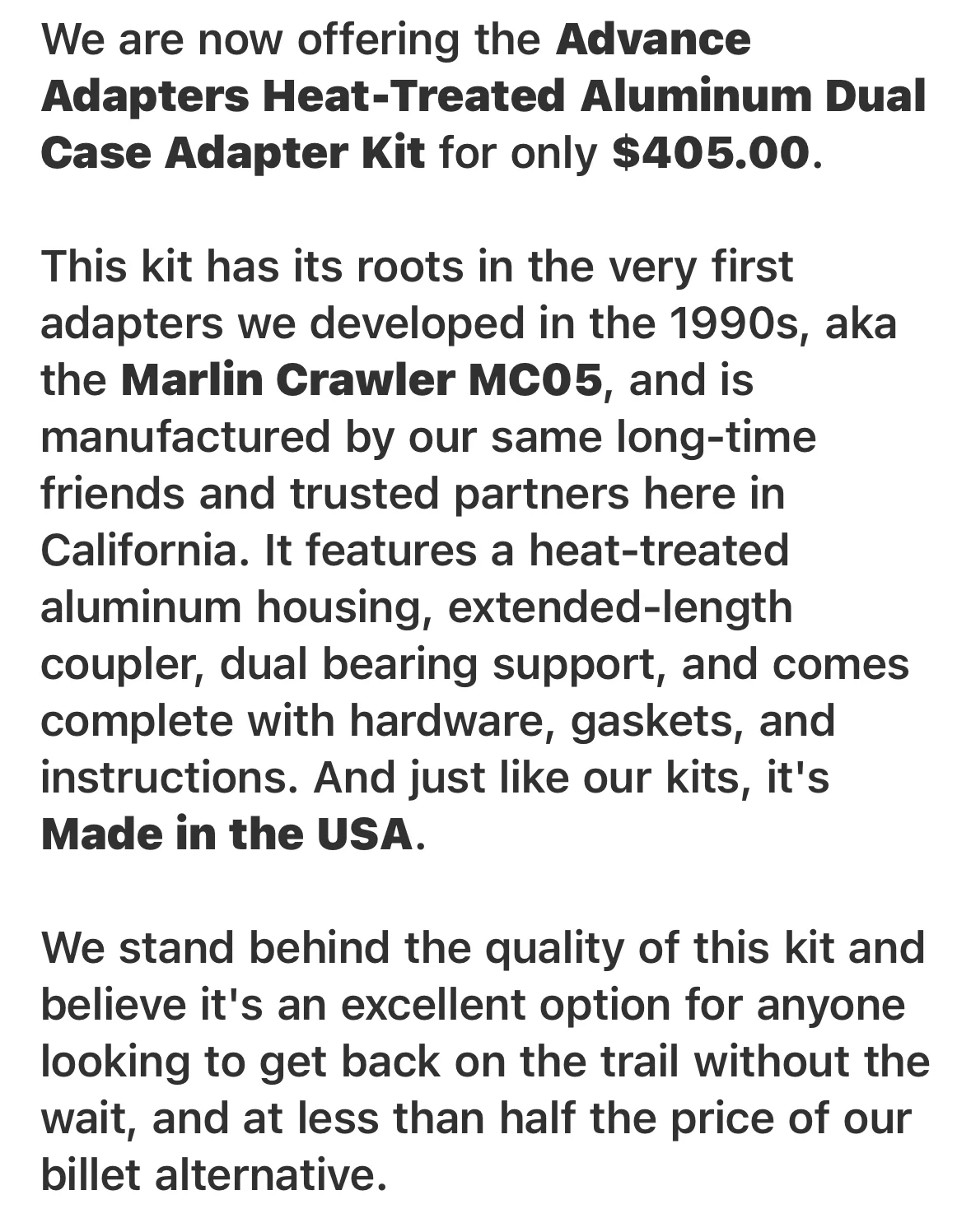

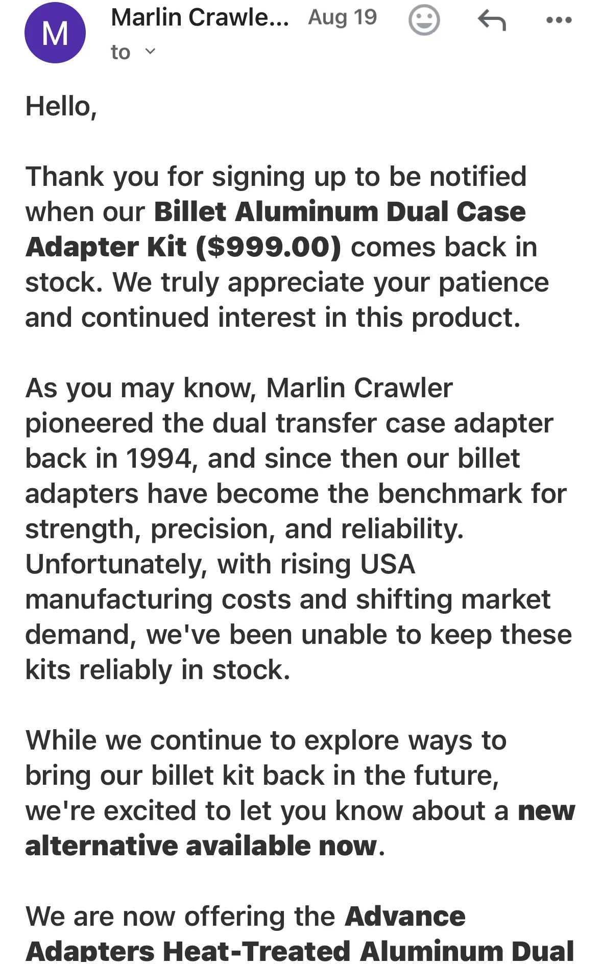

Interestingly enough Marlin is now offering an AA adapter with a longer heat treated coupler going between two spaced bearings (their words). It’s listed for $405 while AAs website is now listed at $415.
I've had mine a LONG time. The only thing I didn't like was the two bearings were China made so I bought Nachi to install. It was about $200 ish back then and pretty sure I caught a Black Friday or X-mass sale for about $180. That tells you how long ago that was.
Update! I guess we don’t need the comparison anymore, MC stands behind the quality of TX2
Marlin is now a dealer for AA and sell the TX2. 405$ plus shipping. No Shiny red or billet at over 1000$ smackers! I made the right move buying AA kit 6 months ago! Thru AA! Cut out the middle man!
