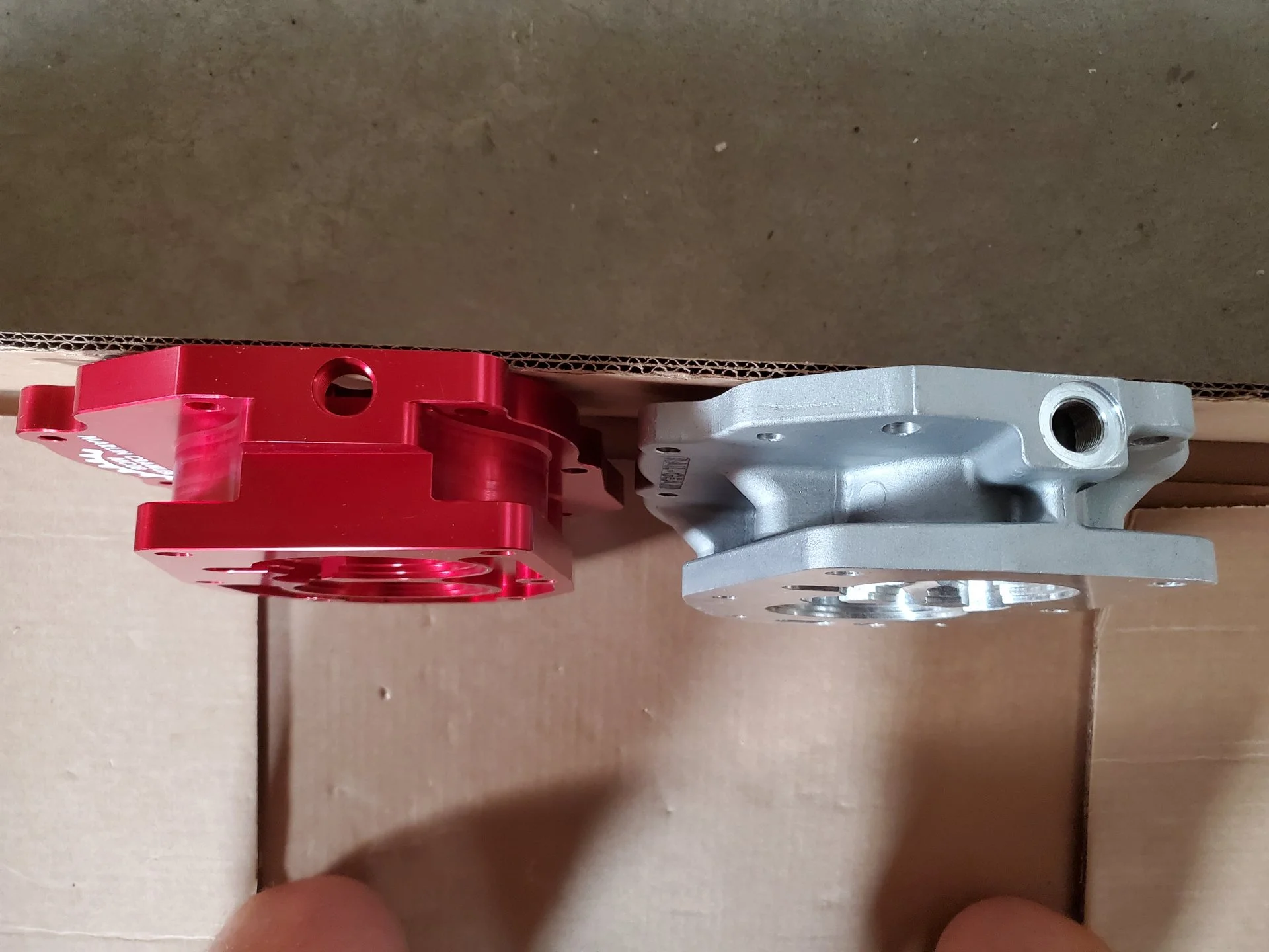

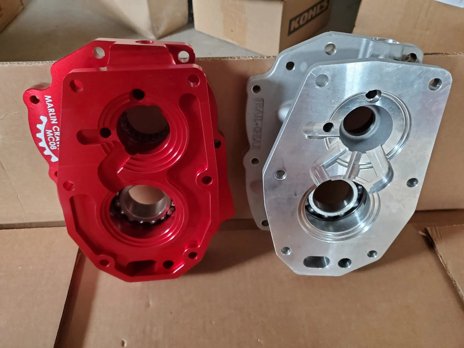

Here is a side by side on the latest MC08 and the Trail-creeper.
