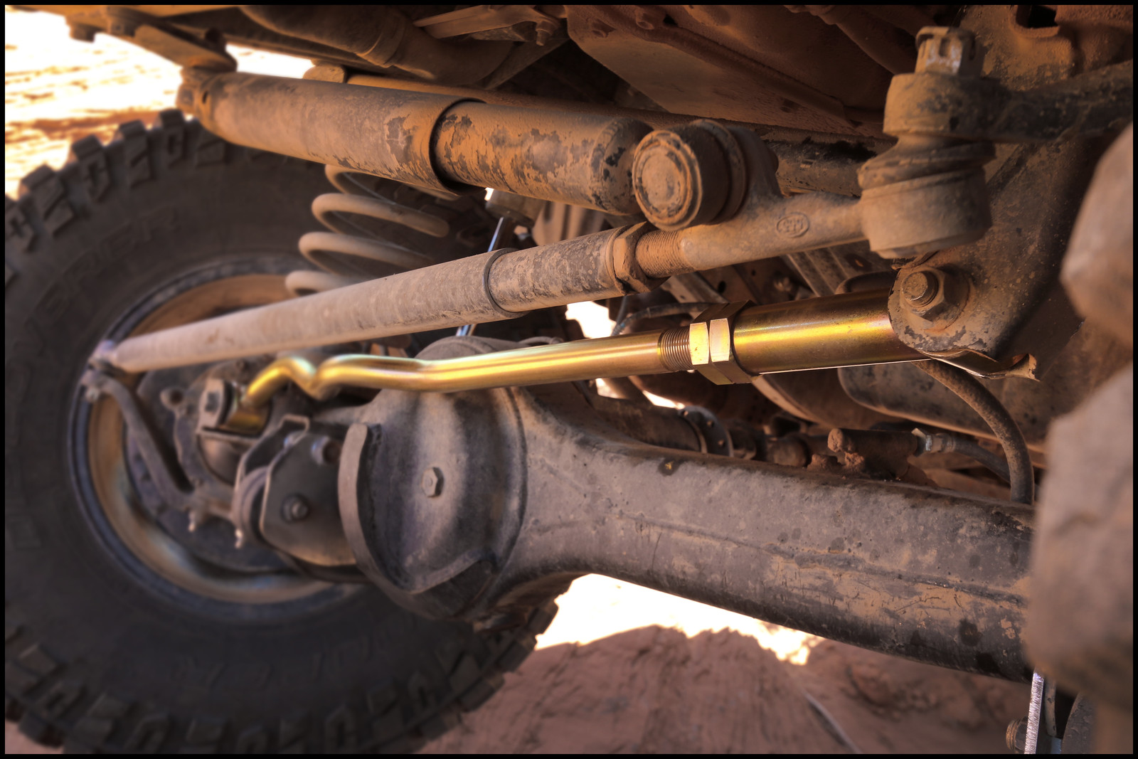

Dont forget Blackhawk adjustable panhards. They are part (optional) of the Slinky kits. Factory bushes and double jam nuts. One more option to add to the list. Production versions are black powdercoat.

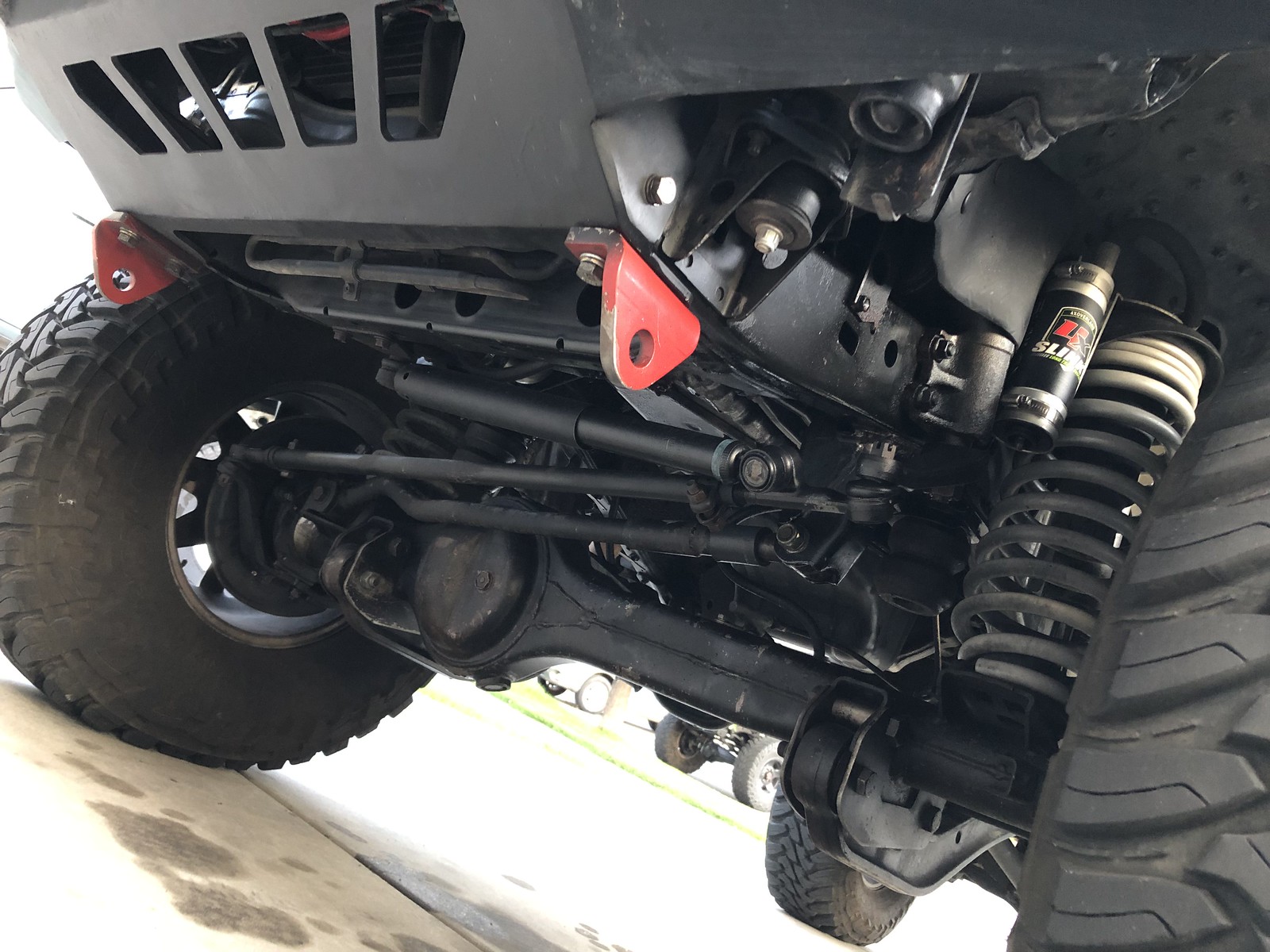

Adam, did you have any axle clearance issues with this bar when you moved the axle forward 1.25"? (specifically your diff armor plate there...)
That image that was in my earlier post is not my truck and does not have the axle moved. Here's a shot of my truck with the axle moved. It looks much closer in this photo than it actually is.
Untitled by Adam Tolman, on Flickr
1.5" seems to be about the farthest you'd want to move the axle. It might work with as much as 2" forward but the draglink will start having clearance issues. 1.25" worked well for me to get the clearance I needed as well as getting the axle centered in the wheel arch, and didn't cause any concerns with steering link clearance.
The diff armor like the one in this photo wouldn't have any clearance issues with the axle moved 1.25"
BH_Panhard by Adam Tolman, on Flickr
This type of diff armor can work with minimal clearancing WITHOUT moving the axle forward. If you move the axle forward, this will NOT work.
