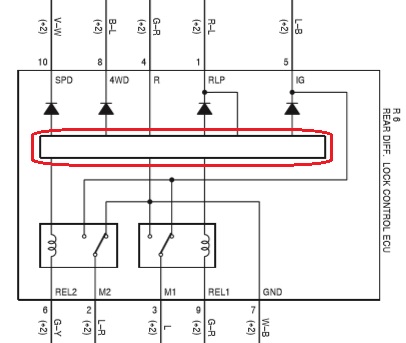

Update: discovered my battery went dead after sitting for two weeks. On investigation, I narrowed it down to a 50mA parasitic draw from the diff lock ECU. I am wiring the diff lock circuit directly off the battery through a 20A fuse, and not from an ignition switched source.
I do not know what is happening internal to the circuit circled in red, but I suspect the leak is from wiring +12V to pin 8 of the diff lock ECU (to defeat 4WD safety). So until I can find an ignition switched source, I will simply remove the 20A fuse until I need it.
If anyone is using the factory ECU, be aware of this.
The Diff Lock ECU has an IC chip (circled in red) and I am not sure what it does internally. It has two safeties, one to make sure the XFER case is in 4LO (pin 8 labeled 4WD), and another to prevent the locker from engaging above 5mph (pin 10 labeled SPD). The 4WD safety seems to only require 12V to defeat. The SPD safety is a PWM signal from the combination meter. I am not sure if simply applying 12V or GND will defeat this one. I left the pin disconnected and it seems to work properly so.... Anybody know what it needs?

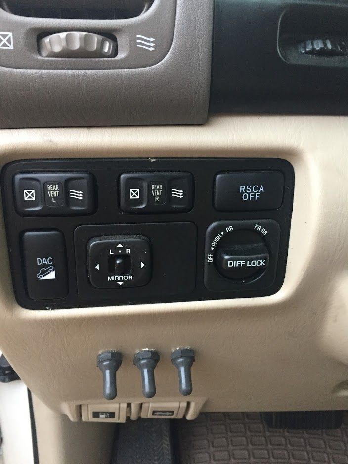

04 with arb’s.
DAC (DA Compressor) button controls the air compressor.
Engage in milliseconds and work like a champ.
Only challenge is there are no lights that indicate on and off.
04 with arb’s.
Those switches look to be in a bad position
The gray ones? They are no longer in use and were there prior to my ownership.
