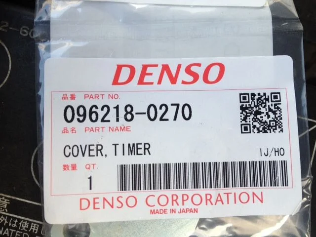

If you are planning on removing Automatic Cold Start Device (ACSD) and putting on a blanking plate here is the Denso part #096218-0270
Cost is around $2.50

Bosch part numbers for the same:
-blanking plate 1461074312
-viton o-ring 2460223001
I bought both at Western Turbo in Winnipeg.

Pretty easy job from the passenger wheel well. You'll dump a bunch of diesel though.
I have had a few mechanics like John at Radd, and John at ateb both say you will need to re adjust the timing of the pump after you remove this. It will be out of spec.
No you don't have to adjust anything as the ACSD only changes the timing when the engine is cold. If you adjust the timing you are changing it from where it needs to be when the engine is warm.
