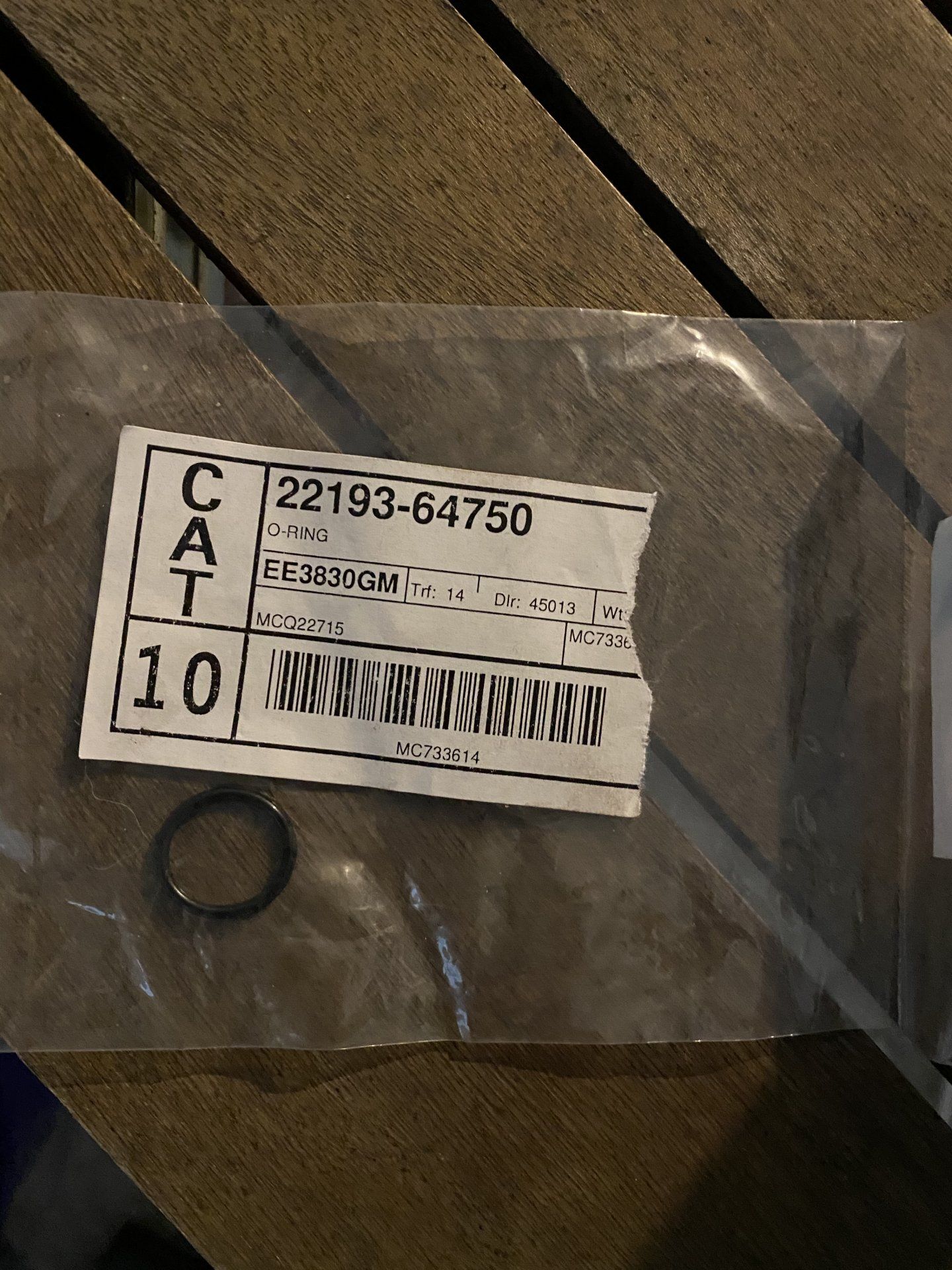

Much more expensive (and probably unnecessary to go this route), but the Toyota OEM parts for the blanking plate and O-ring (fits 90-92 HDJ81 / 1HD-T)
2261256350 - plate (~$23)
2219364750 - O-ring (~$3)
Still widely available.
FYI, not sure if they just packaged the wrong o-ring in there, but the 22193-64750 I received is not the right sized o-ring.

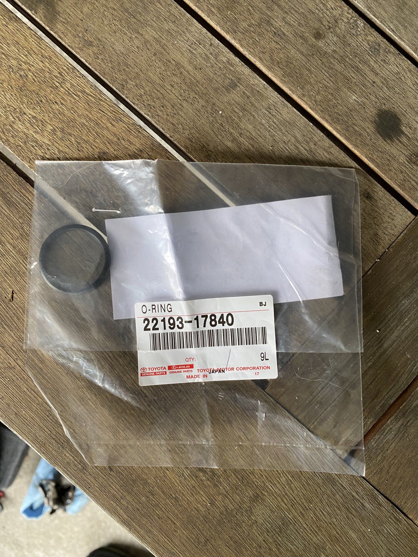

I ended up just picking the correct o-ring from the Toyota dealership (part # 22193-17840). Probably overpaid by 3x, but still cheaper than getting it shipped.

The plate will fit, but the O-ring may be different. You could buy both O-rings if you're unsure (the one I listed and the one acarlton listed).
Or you can just cross reference on Partssouq using the item numbers to see if they work for your specific pump.
For a 50 cent o ring, its a no brainer. The existing o ring is probably 25 -30 years old. Possibly a pre viton material
The o rings are not special toyota o rings. You can get them from any fuel injection shop
