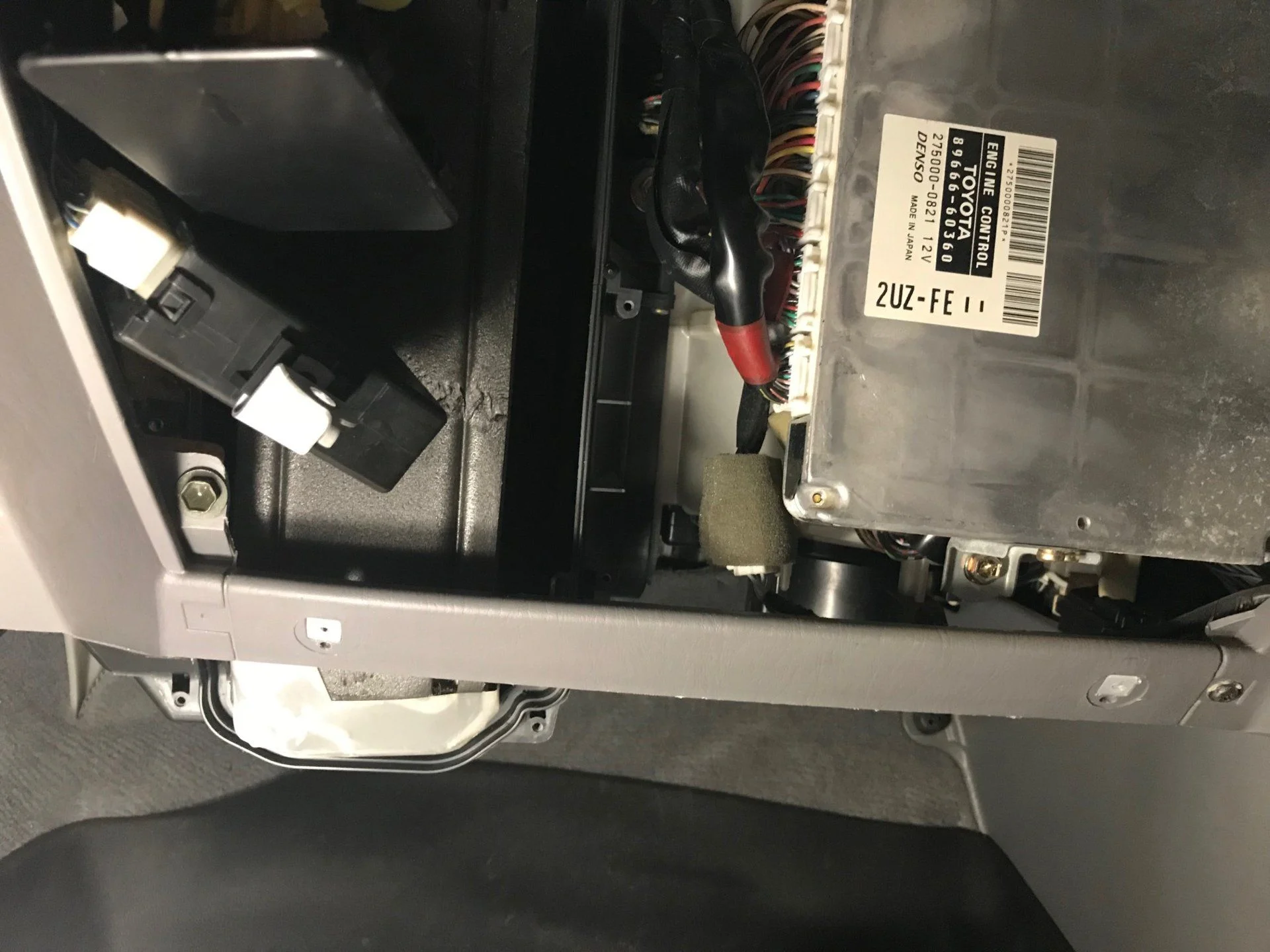

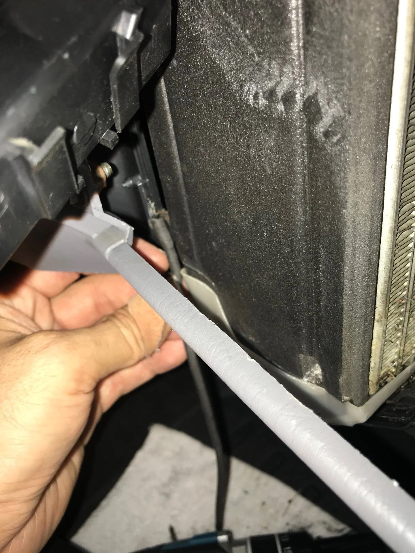

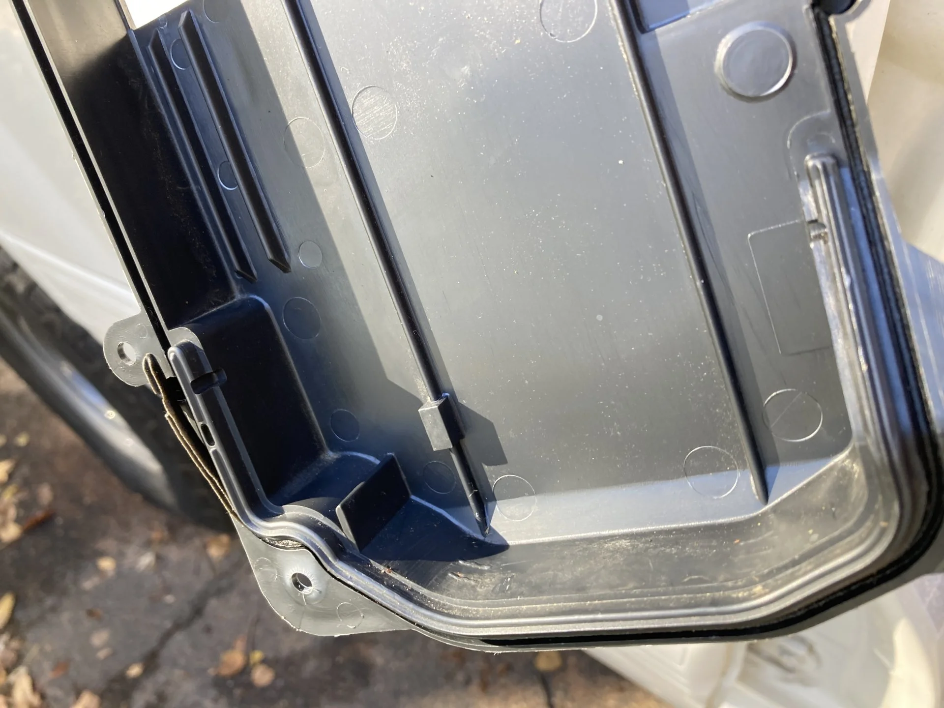

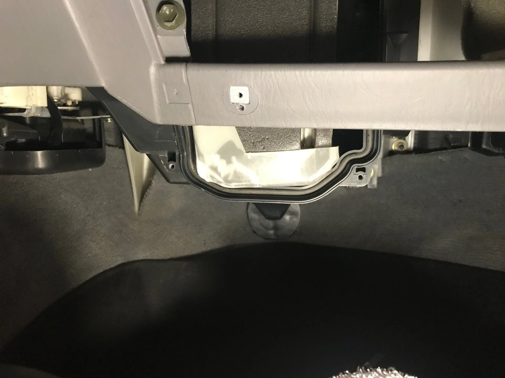

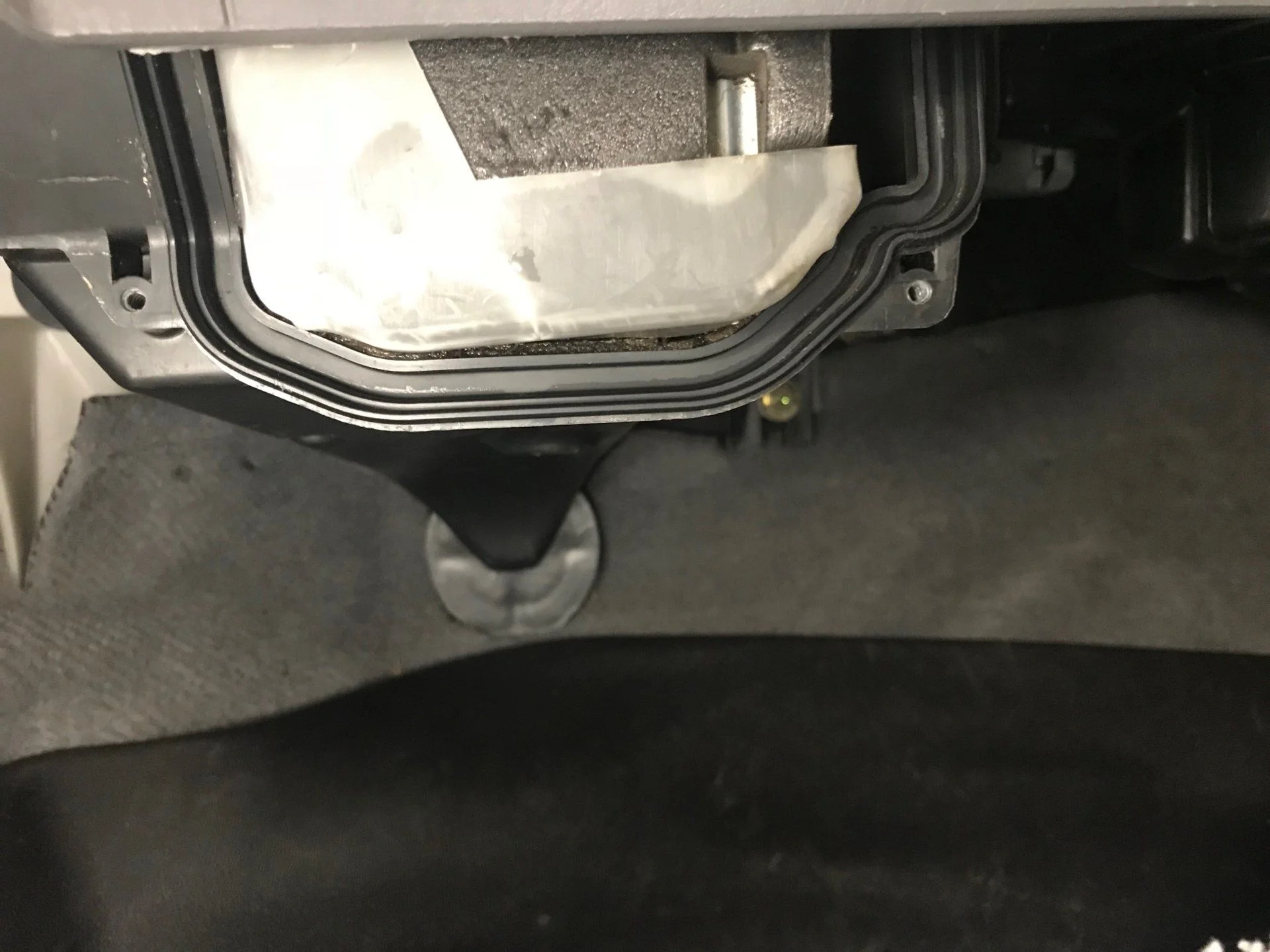

Here are some shots of what that looks like, did this last night and hoping to never see wet floor again:

I ordered the gasket, but can’t seem to duplicate the issue. Thanks for the pics though.

If your A/C is working fine, it isn't the evaporator. The drip is coming from the bottom of the evaporator cover as mentioned above. Pretty easy fix, if you have the will to do it. 30 minutes to an hour, taking your time.
Take the part number listed above to the dealer, or you could use some type of form-a-gasket from a autoparts store, but the correct way to fix it is with the "cooler packing" listed above.
Here's quick instructions I shared with someone else a month or two ago...
To get to the evaporator, remove the glove box first, two screws underneath. The evaporator cover is a pain to get out. 8 screws hold it on. Two in top corners, 2 bottom and 2 each side. There is also a bolt in the lower left corner going through the edge of the dash, a metal brace behind it and the bolt is up against the evaporator cover. Remove antenna relay from cover and disconnect harness. Gently pull cover loose from the evaporator housing. It WILL NOT drop out. It takes some twisting, cussing and pulling. You will need to gently pull out on the bottom of the dash cross brace, where glove box attaches and the metal brace you removed the bolt from. I slid the cover down some to clear the top part and rotated it clockwise. Then pulled the brace out gently and lifted the cover out through the glove box hole.
While you have the cover off, vacuum out the debris in the evaporator housing, you'll see what I mean when you open it up.
The old gasket is in the groove on the evaporator housing. On the new gasket, one end is slightly fatter than the rest. That end goes up in the groove in behind the metal brace, left side. Can't really see it too well.... the gasket is friction fit and kind of hard to get it seated. I used a small controls, flat blade screwdriver to push against the gasket and seat it. My fat fingers wouldn't do the trick. The housing went back in easier than I thought it would.

I converted my evaporator housing to accept filters about a year ago. This summer my wife noticed moisture at the bottom of the housing. I ordered a new gasket and disassembled. And what did I find? That I'm dumb sometimes. I had put the gasket in the skinny groove IN THE COVER instead of the groove in the housing it belongs in. . .
Interestingly, there was no old seal in the housing--I'll bet it came off with old (no filter hole) cover I removed and I didn't even notice it. . .
New seal properly installed; old one removed from the place it doesn't belong to keep it from interfering with the seal. Let's hope for dry feet for the wife next summer!
