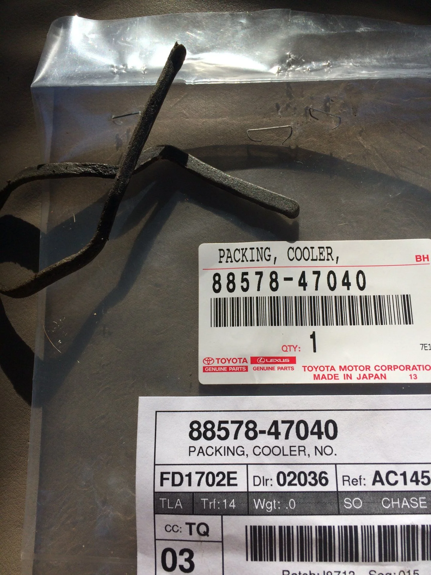

You'll need to remove the cover and reseal it. While you have the cover off clean it out and make sure the drain line is clear of debris. Also, if you don't have cabin filters it's worth the small cost to upgrade the cover to the 2 piece and add the filter option.
The replacement cover parts are 88891-60040 and 88891-60060 for the cover and 88578-47040 for the seal if you want it. Some people just use gasket maker. You can get cabin filters on Amazon.

I did it this week and it took me less than 30 minutes. I did purchase the seal from Toyota. If you do a search you can probably find instructions. Basically pull 2 glovebox screws. Remove glove box. Remove 3 screws holding upper trim piece carefully disconnect airbag sensor and plug from trim piece and set aside. Remove the power antenna relay 2 bolts. Remove 8 phillips head screws from around the evaporator cover. Disconnect clip on the left side of the cover. Carefully pull off cover. It is tight but it can be done without too much force. Install new Toyota parts and using shop-vac suck out any debris that is inside. Use a piece of weed eater line to clear drain line that runs into firewall. Reverse steps to reinstall.

If your A/C is working fine, it isn't the evaporator. The drip is coming from the bottom of the evaporator cover as mentioned above. Pretty easy fix, if you have the will to do it. 30 minutes to an hour, taking your time.
Take the part number listed above to the dealer, or you could use some type of form-a-gasket from a autoparts store, but the correct way to fix it is with the "cooler packing" listed above.
Here's quick instructions I shared with someone else a month or two ago...
To get to the evaporator, remove the glove box first, two screws underneath. The evaporator cover is a pain to get out. 8 screws hold it on. Two in top corners, 2 bottom and 2 each side. There is also a bolt in the lower left corner going through the edge of the dash, a metal brace behind it and the bolt is up against the evaporator cover. Remove antenna relay from cover and disconnect harness. Gently pull cover loose from the evaporator housing. It WILL NOT drop out. It takes some twisting, cussing and pulling. You will need to gently pull out on the bottom of the dash cross brace, where glove box attaches and the metal brace you removed the bolt from. I slid the cover down some to clear the top part and rotated it clockwise. Then pulled the brace out gently and lifted the cover out through the glove box hole.
While you have the cover off, vacuum out the debris in the evaporator housing, you'll see what I mean when you open it up.
The old gasket is in the groove on the evaporator housing. On the new gasket, one end is slightly fatter than the rest. That end goes up in the groove in behind the metal brace, left side. Can't really see it too well.... the gasket is friction fit and kind of hard to get it seated. I used a small controls, flat blade screwdriver to push against the gasket and seat it. My fat fingers wouldn't do the trick. The housing went back in easier than I thought it would.

I completed this improvement first thing last summer after noticing the same issue (dripping on passenger floor). The thread I was referring to suggested the cooler cover already had the 'Cooler Packing' (88578-47040) installed. So I didn't order that piece, and just ran with the 2 cover pieces @Simplespirit mentions above. The drip persists, so I need to go back and install the Cooler Packing (88578-47040) aka 'seal' it would seem, sound correct?
Last question - if I understand the system correctly, with the seal installed the only place the condensation can go is out the drain line correct? While I'm at it should I attempt to clean or clear the drain line, and if so how do I do that? Rig has 155k, I'd honestly be surprised if it was clogged but would rather take a comprehensive approach.

I'd replace that seal, make sure the drain is clear under the truck and keep going.
To clear the drain under the truck all you need to do is wipe the nipple with your finger, you can use a pipe cleaner to remove out the tube if needed. But doubt you need to do that.
