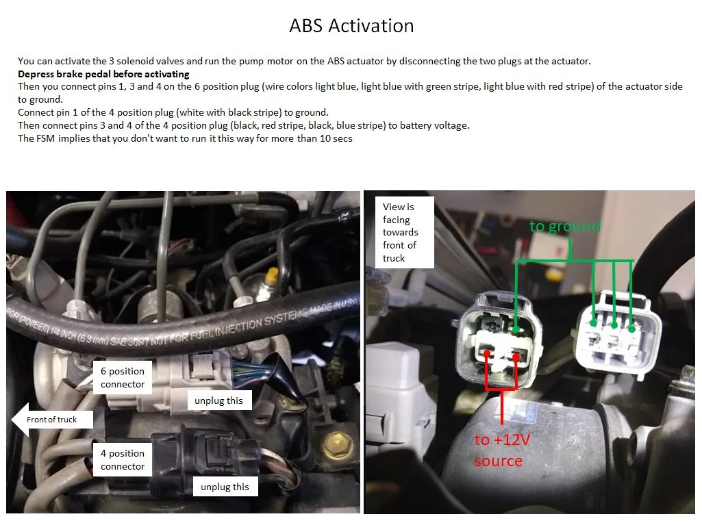

I replaced front calipers, pads and rotors and a brake line on the right front. I replaced pads and rotors in the rear. I went to bleed the system and couldn't get rid of the air. Started in the right rear, left rear, LSPV, couldn't get any of them to bleed without air. I blocked off the master cylinder and can identify that that is good, the brake pedal gets rock hard. But reconnecting to the ABS, its sponge city. I have been using a Harbor Freight Pneumatic vacuum bleeder unit connected to an air compressor. I have also tried the two person method. I tried jumping the ABS as in the attached photo from another thread here. I heard a motor and about three seconds, I had to disconnect because the relay (gray box on the back fender side ) was smoking. I am guessing the ABS is bad but is it the module or the pump...both? Anyone ever buy these used? I know there are a lot of folks disconnecting their ABS but I don't want to do that. Any thoughts?

Just finished jumping the ABS pump and thought of this... are you also supposed to crack the lines going into the pump? I assumed jumping the pump clears the air out of the pump and to the rest of the system but wasn't 100% sure.

I didn't see any smoke.. so far it seems like this used pump works properly.

There is no reason to play games with abs while bleeding. You bleed according to the procedure in the fsm for the calipers and lspv, then take the truck to a gravel parking lot and activate abs a bunch of times to get the old fluid out. Then rebleed. Done.
