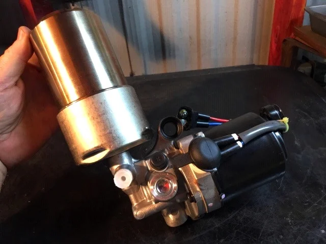

Yours is doing precisely what mine did before it quit altogether 2 days later.
My fix was to replace the motor and accumulator.

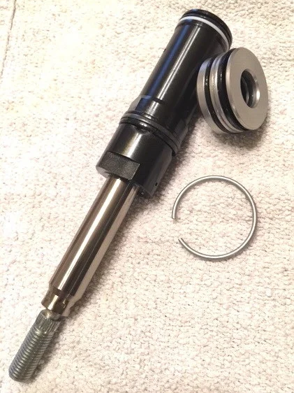

I replaced the motor and accumulator with new, as Flintnapper did, but also replaced the master brake piston assembly - just another $70 or so. Not much extra work once you have it all out anyway.
I replaced the motor and accumulator with new, as Flintnapper did, but also replaced the master brake piston assembly also - just another $70 or so. Not much extra work once you have it all out anyway.
Yes, rebuilt my 'Master' as well.

Yes, I suspected I would have to replace the accumulator can thing, pump and motor as one unit... given I've already rebuilt the motor - albeit with pretty poor aftermarket parts, I think, given how noisy the new parts were.
Do you have any link to where you got it from?
The cheapest I've found somewhere was around $800 AUD ($600 USD at a guess) plus shipping.
That's for everything in the photo, but doesn't include the master brake piston thingy.
The whole unit, with reservoir, master cylinder, etc, I could get from Japan, but it was very expensive, around $2800 AUD ($2100 USD?)

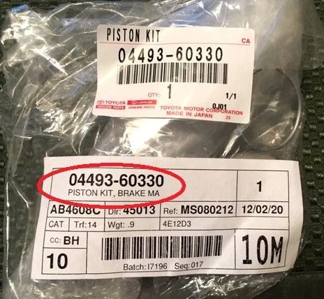

Thanks for the part number for the piston kit too.
Is that for an 2003 series UZL100 though?
Googling it, I see at least one seller refering to 04493-60330 being for a 1/1998 - 7/2002.
I guess I can check with my local Toyota parts place anyway.
