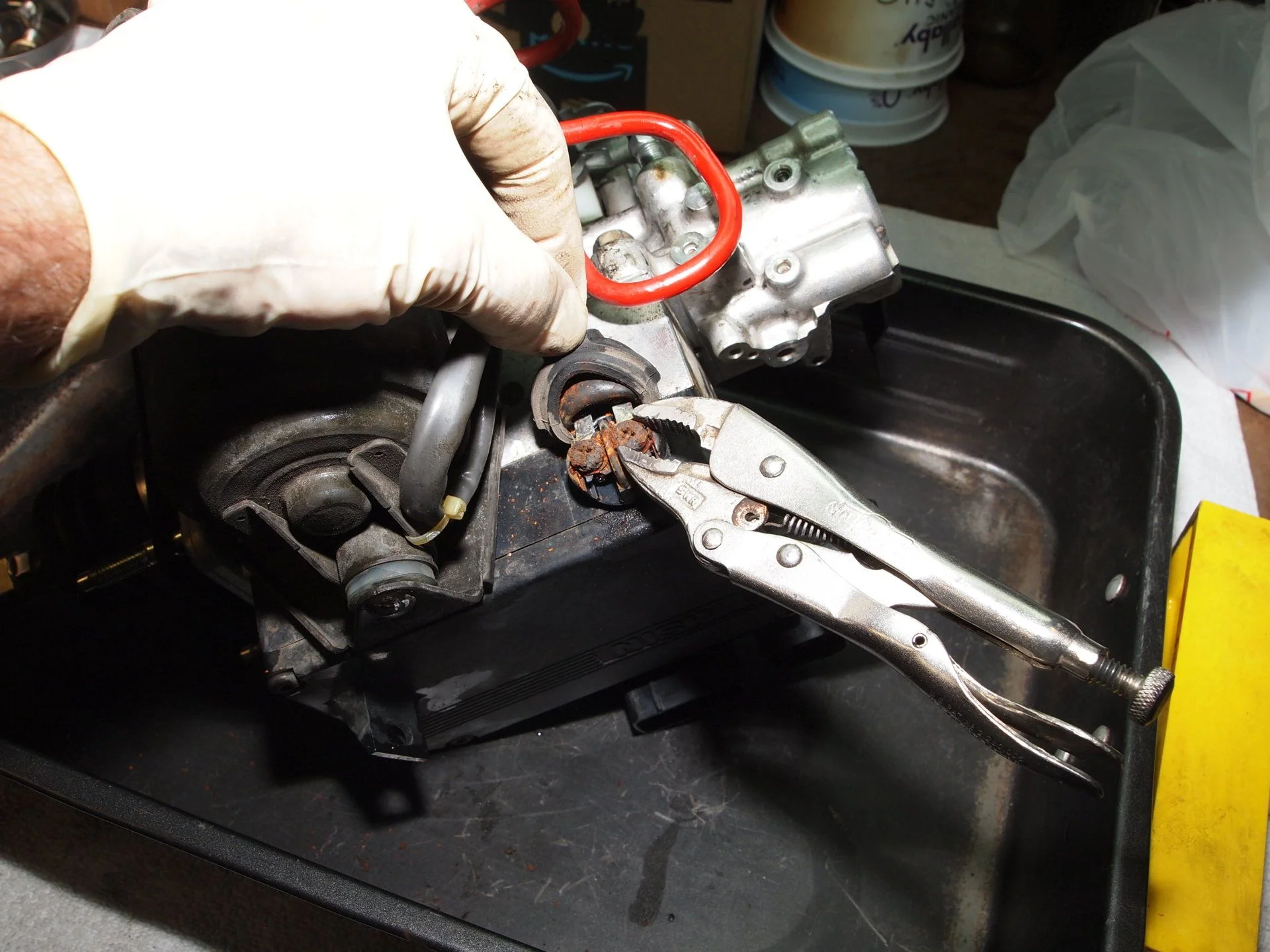

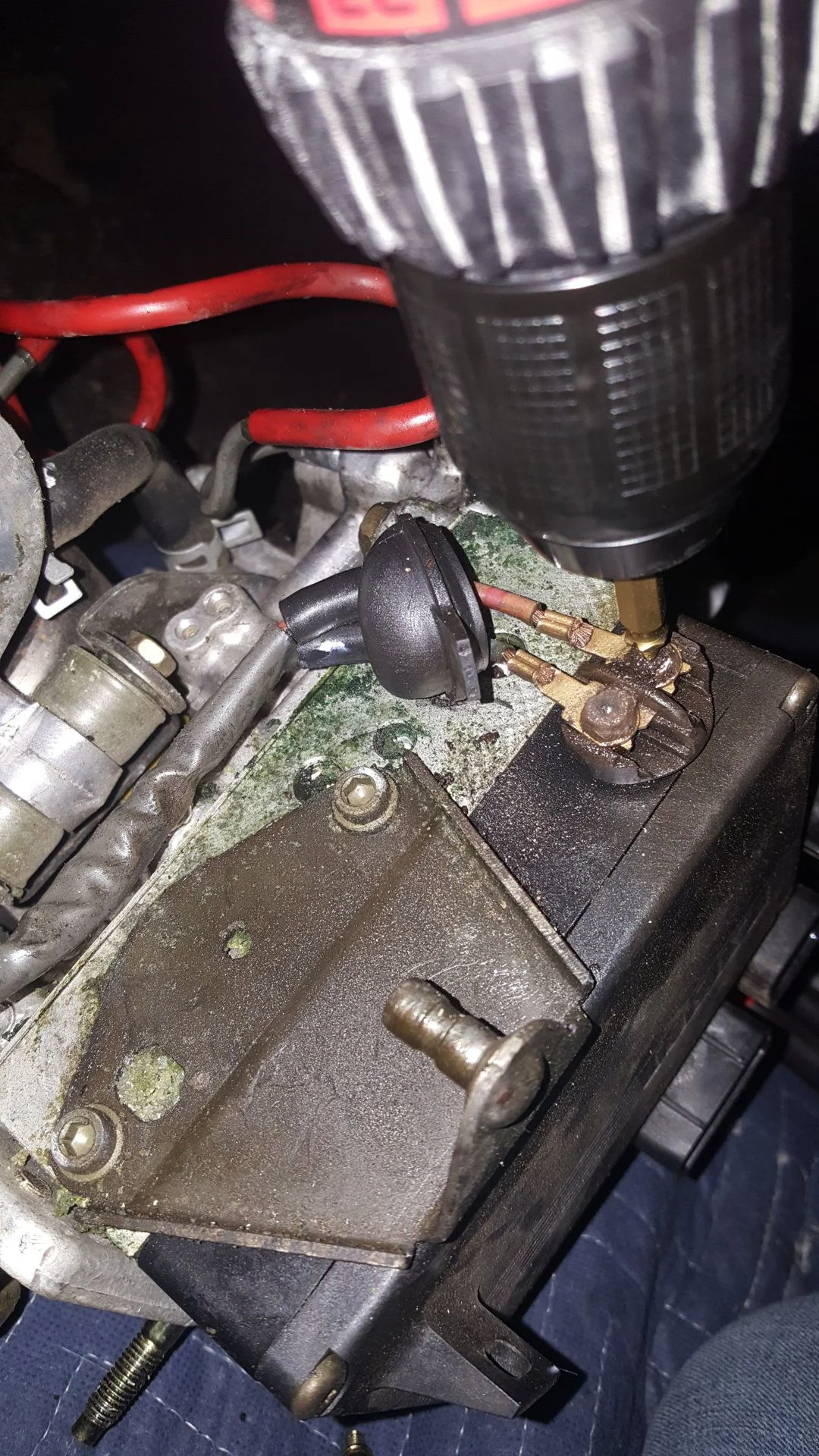

Just replaced my pump motor over the weekend. Found a wrecked 2000 LX and swapped in it's old (but functional) motor to get my LX back on the road. I am sending my non- functional motor out to that company in CA to get rebuilt. When it comes back, I am going to yank my master cylinder yet again and replace the used unit with the freshly rebuilt one.

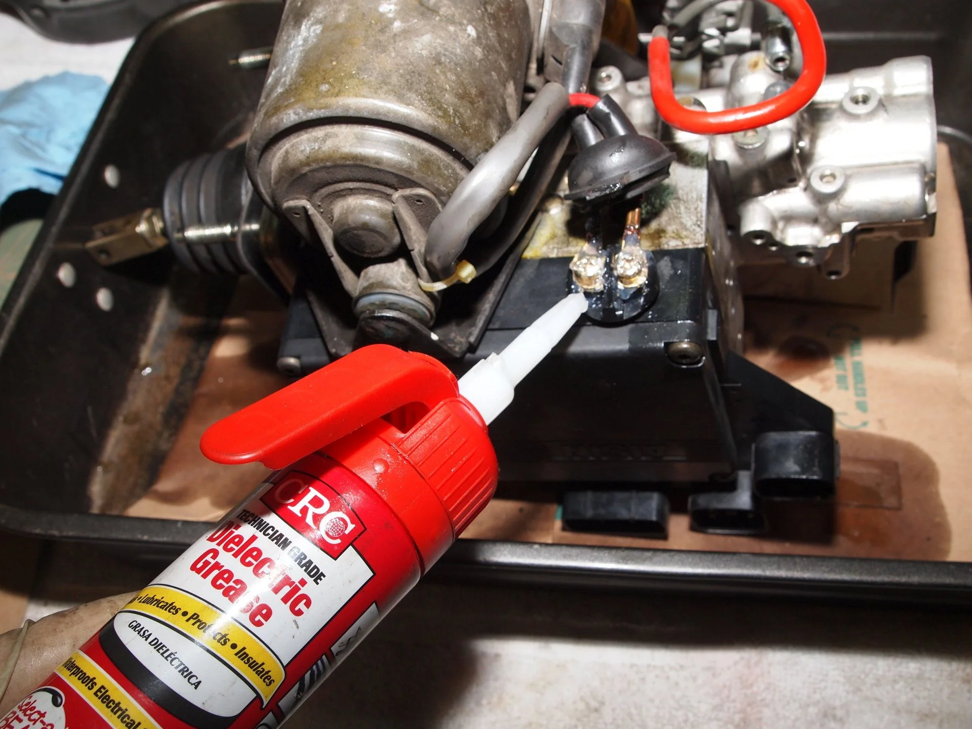

Also, the motor harness connector on the bottom of the ABS module was REALLY corroded. I installed new screws and nuts, but it was a real PITA...
Pics:
The two screws holding the wire on the bottom of the ABS unit rusting is interesting.
I recently replaced the ABS for a local mud members 98LC w/150K. I saw the same rust.
I clean up the wires and install them on the replacement ABS unit. I added some dielectric grease in hopes to give some future protection from rust.
It was a clean 98LC, not some rust bucket. I became concerned The King, The Unicorn & The black Knight my also have this condition.

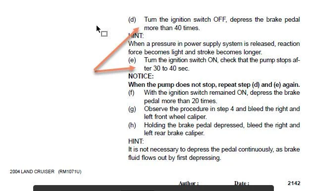

What does it do if you perform the brake booster test where you pump the brakes key off 30- 40 times (pedal will become softer) and then turn the key to the on position to time how long it takes for the booster to refill.

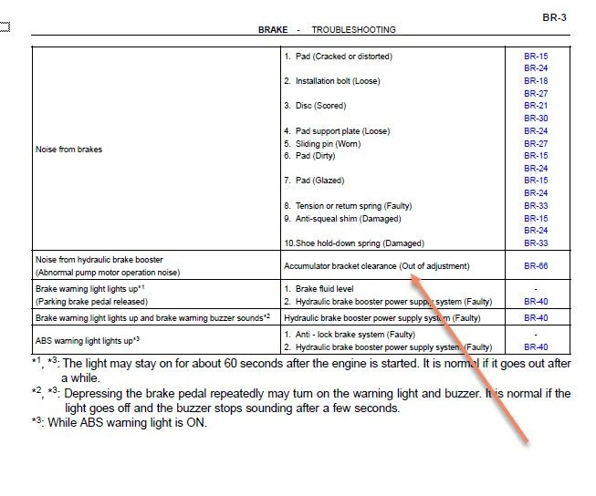

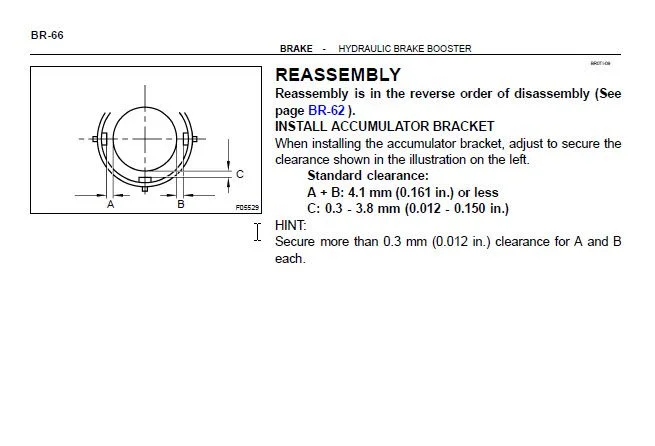

Also see some pages from the FSM that may help troubleshoot.....
Troubleshooting chart:

Thanks @SoylentGreen...I spoke to yam6 and they think it might be a fitment issue. In WickedPickle's post above, the FSM shows improper accumulator bracket clearance could be the cause. I'm checking this next and will update.
