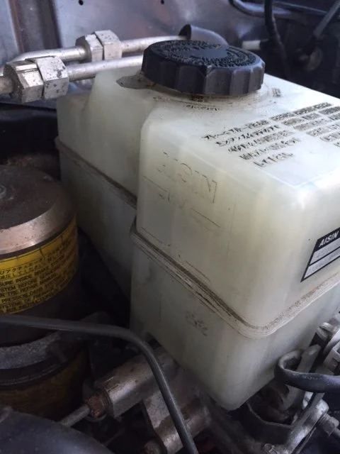

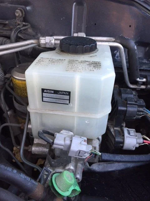

**Update
I went out and started the rig up backed up and applied the brakes... there was ZERO Brakes... pulled forward in the driveway and I had to use the E-Brake. I popped the hood and the Brake fluid reservoir is Bone DRY.
Reminder of how I got here: I was driving down a steep driveway last night that was sheer ice... slid a good 50 feet at a 30+ degree slope. I had my foot pressed very hard on the brakes and first the red Brake light illuminated and then I dove about a mile and then the ABS, VSC TRAC & VSC OFF lights lit up with an audible constant alarm sounded for the remainder of my 5 mile ride home.
Anyone have any ideas on best case scenarios & worst case scenarios in light of this new development? I am not mechanically inclined for this type of job. Are there any things I should mention to the independent shop that I am going to have it towed to? I am trying to avoid the dealership.
Thanks - Matt

I'm assuming doing that long slide, the abs system was going nuts as you held your foot on the brake, as it should.
Now after ABS gets worked hard and you have no fluid in the reservoir. I would check all the junctions that have anything to do with the ABS circuit. Take the MC out and inspect if you feel comfortable, or else have a shop look at it.
Your brake fluid is leaking somewhere. Quite rapidly I'd say if you are bone dry.

View attachment 1611285 View attachment 1611286
Should be easy to find leak. Clue is it happen after hard braking. I'm betting flexible brake line burst while ABS pounding away during ice slide. It's that or a seal blew out. Shop will see the leak.
