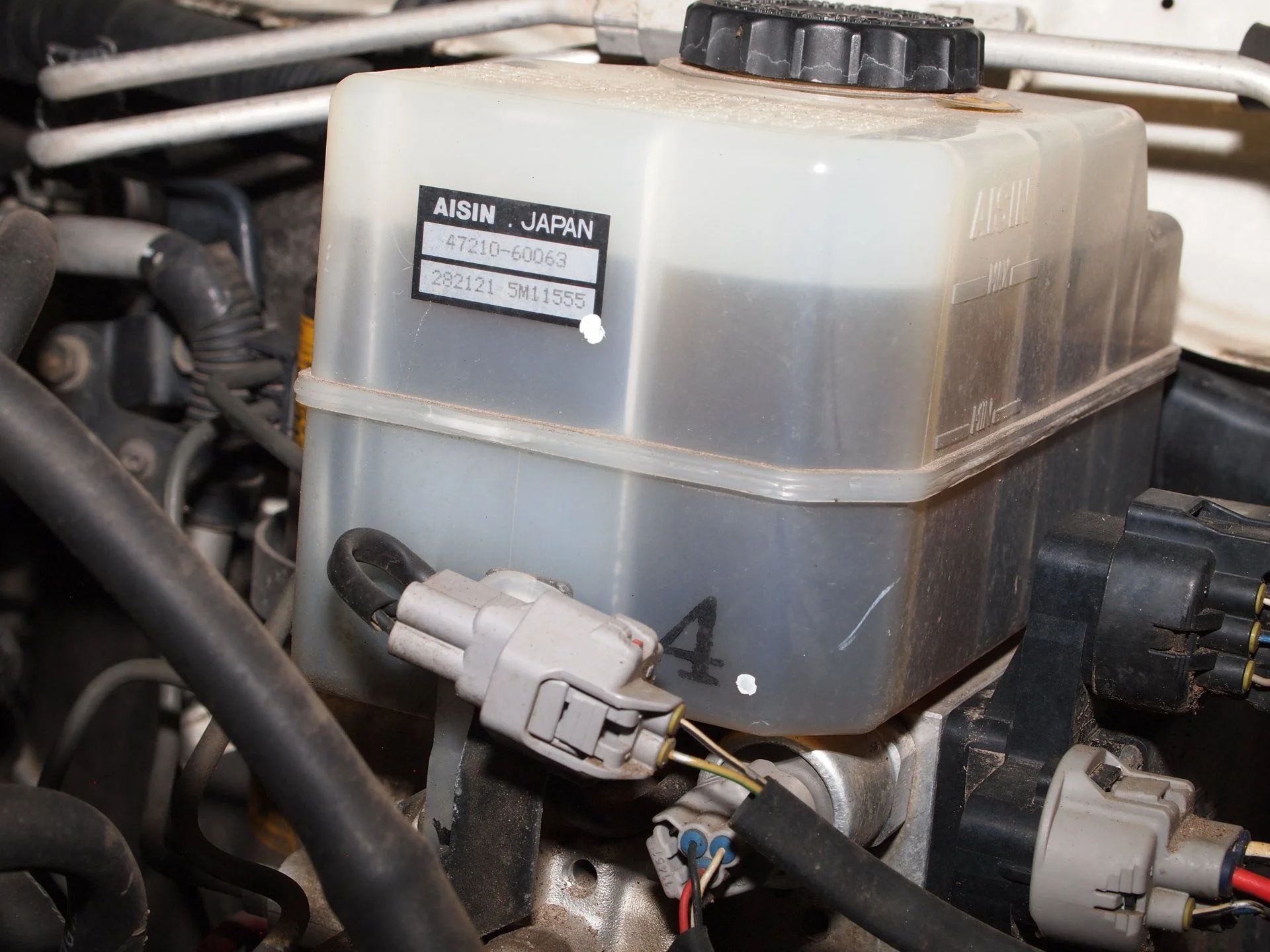

To check brake fluid level there is a procedure which is done with vehicle on level ground. If you look on top of the reservoir, you'll see this procedure written out.
What it states is with key off/out pump brake pedal 40 times. This evacuates booster pump/canister which is holding brake fluid, into the reservoir. Once booster is evacuated, check to see that brake fluid is at the max line (not over or under).
As you can see fluid is at top max line, which is maximum it should be at. The max line is about 4mm wide, it can at bottom of max line.

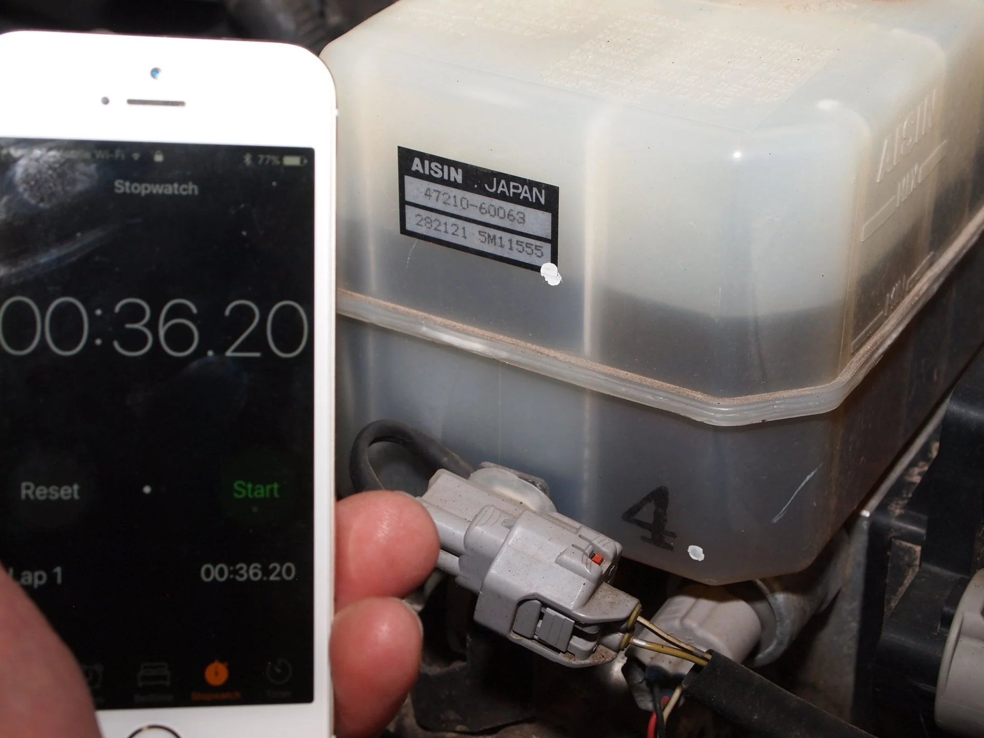

Now that we've followed procedure to check level, we time how long it takes booster pump/canister to fill back up. Simple turn key to ON and time how long booster pump runs. You'll see brake fluid in reservoir drawing down. I do not starter engine for this test, as it would make hearing the pump more difficult. It should take 30 to 40 seconds for a health system until booster pump stops. More time could indicate system has air, so bleed and re test. If all air bleed out and still running longer or short, something needs fixing.
You can see booster pump drawn down the fluid level to halfway between max & min lines. Had this reservoir been low after level check (evacuating booster) it may have drop below min line as booster canister filled. Below min line will activate alarm.
Keep in mind that brake fluid level is based on new brake pads & rotors. That level will drop a little bit as pads & rotors wear. So it is ok to be a little below max. If topped when pads & rotors are worn, installing new pads & rotors may put over max line. Running over max is not advisable.
You should never have to add fluid, unless flushing. Needing to add may indicate leak.

Now that we've followed procedure to check level, we time how long it takes booster pump/canister to fill back up. Simple turn key to ON and time how long booster pump runs. You''l see brake fluid in reservoir drawing down. I do not starter engine for this test, as it makes hearing the pump more difficult. It should take 30 to 40 seconds for a health system until booster pump stops. More time could indicate system has air, so bleed and re test. If all air bleed out and still running longer or short, something needs fixing.

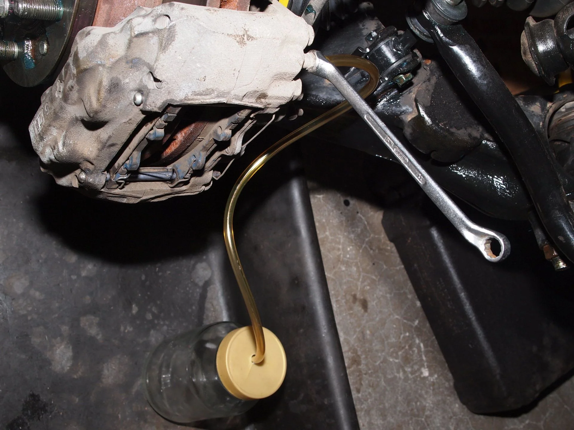

You can just suck it out or reservoir, A very thin hose is needed to get past stop under cap. A better way is bleeding off some by depressed brake pedal, key on (runs booster pump) than bleed a rear bleeder. I say rear because you can drain as much as you want without pumping pedal. Just don't empty revoir. For fronts you'll need a helper to pump pedal and hold, only getting a little at a time. By bleeding off a little rather than sucking out of reservoir it gets some of the nastiest old fluid out of calipers. Caliper is where heat is generated boiling the brake fluid, and attacking the most moisture.
I use and old shower curtain spring loaded bar to push on brake pedal, using seat motor against headrest with a protective rubber feet and a rag to protect leather of seat.

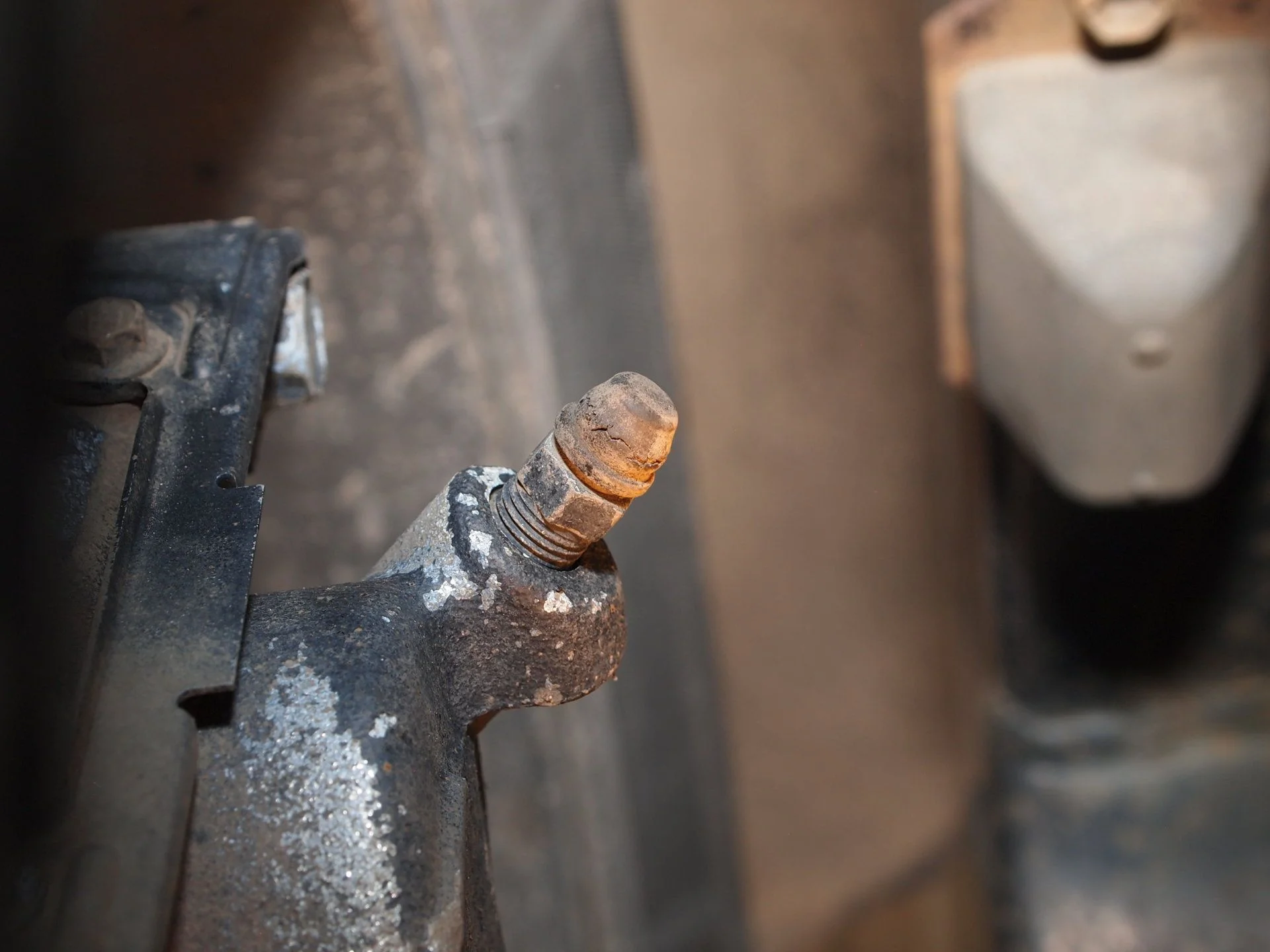

As always make sure you keep bleed caps on all bleeders and in good condition. They last about 7 years. If bleeder is not kept sealed moisture will damager bleeders and calipers.

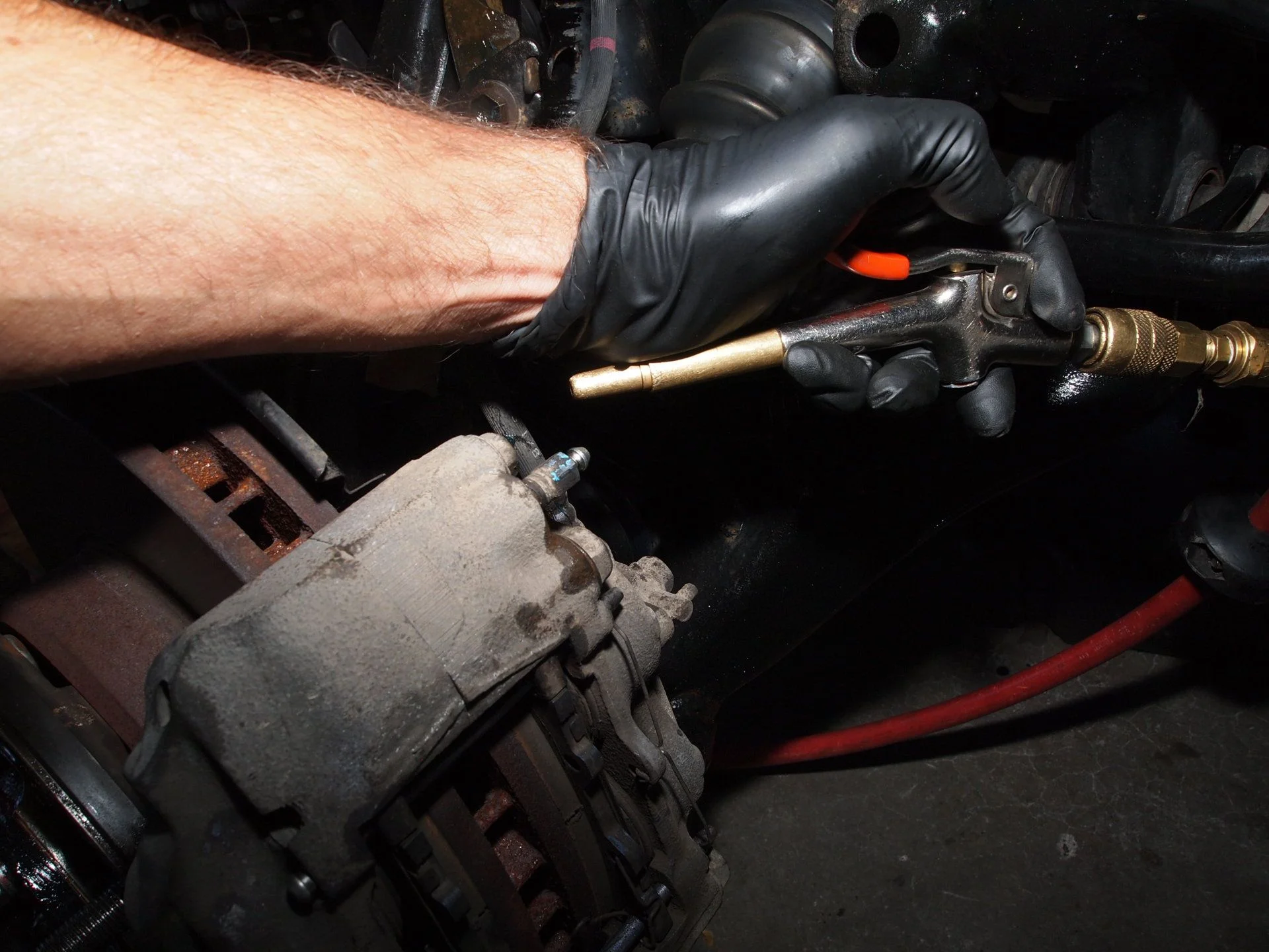

I like to blow out bleeder as final step after torque in. This helps me in two ways: 1) Keeps from getting false visual inspection for leak. 2) Any brake fluid remaining in bleeder will attract moisture.

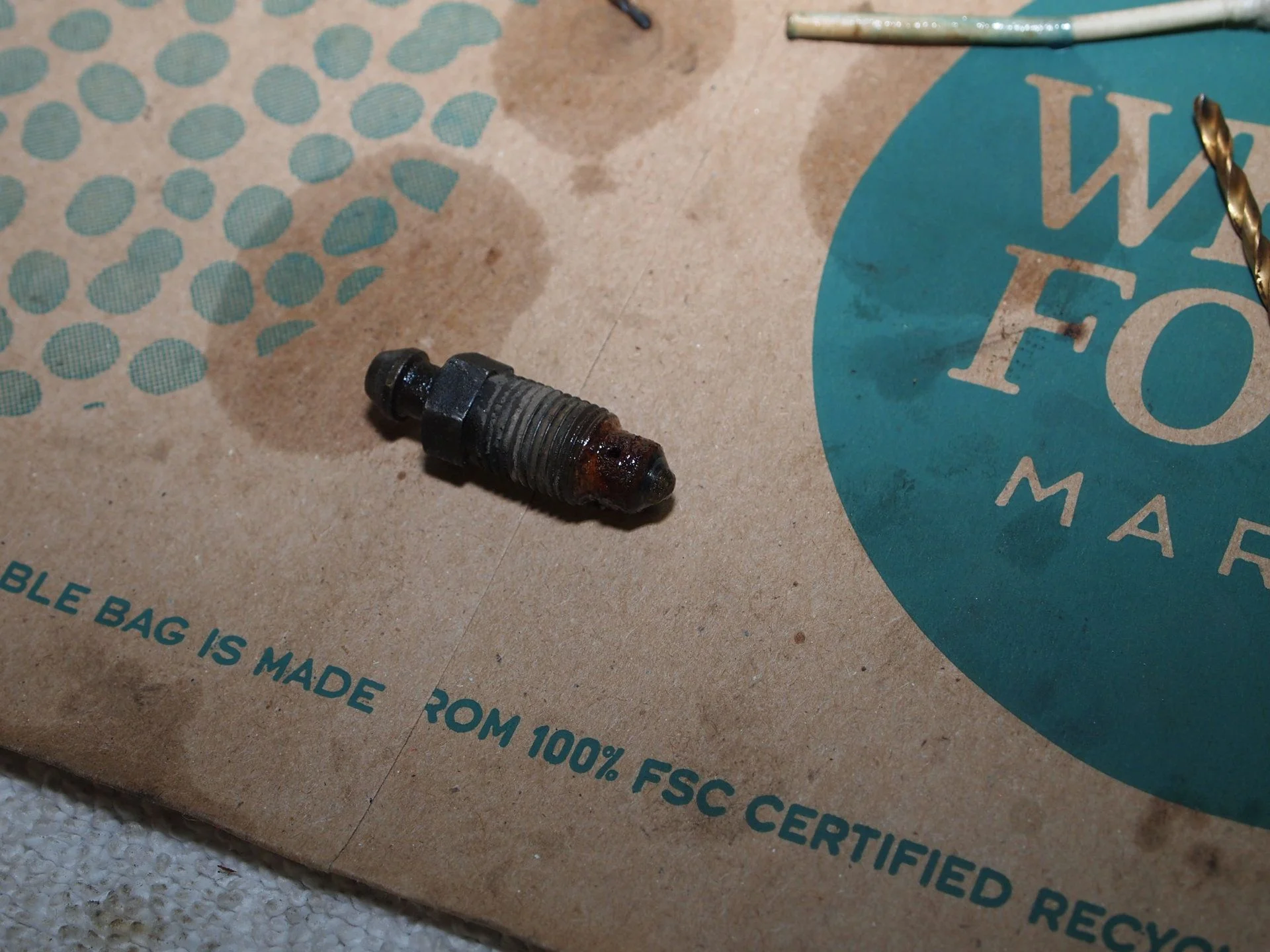

This bleeder rusted shut from bad or missing cap. I really can hardly believe how many shops don't replace bad caps after a brake job. Guess they know it insure a bigger more expensive job next time as they are incompetent.
