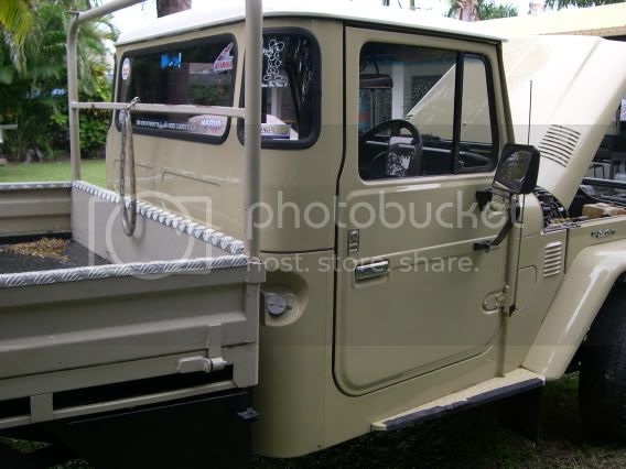

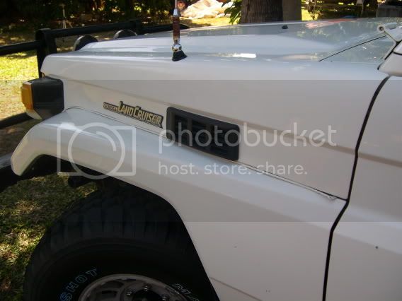

Looking at these old 40/45/47 series trucks I think the vents are pretty close to the mark. I remember on my old 45 ute the hot air coming out the vents used to annoy me when it came in the cab especially at lower speeds towing my 19foot boat with al its gear. I had no aircon back then.:D ol.

just wondering if anyone has thought about install a scoop into the hood. eg maybe one like the new hilux has.
