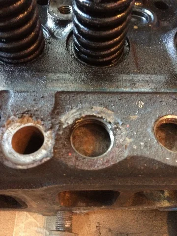

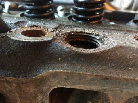

In the mean time, I decided to break down the 2F and see what shape the engine is in. Just through visual inspection, I found a piece of the head cracked off. The section where the temp sensor goes into the top of the head is cracked off. I can still get a couple of threads into but I don't know how well it will seal. I don't want to get the head rebuilt and come to find that the head is screwed and waste all the cash.

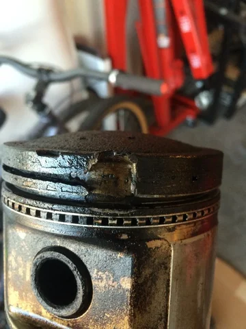

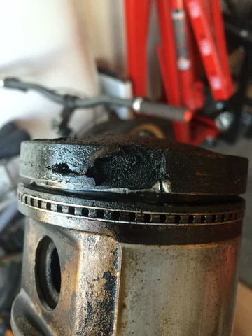

Got the head off and found this little guy on the #6 cylinder. Looks like the oil ring broke and decided to come out the side of the piston..

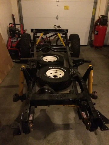

After 6 months of what was supposed to be a 3 month project I have finally gotten her back into a roller. Sandblasted and painted frame, front and rear axle rebuilt, new brakes, and a lot of parts from various guys (Thanks to Georg, Kurt, and Rob) and lots of weekends and work nights. Taken me longer than I hoped but it's still progress and for that I am happy! Thread is worthless without these....
