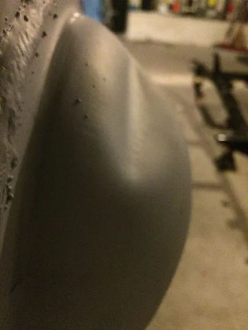

Finally have gotten the frame finished and the suspension back underneath it. After the rear end fiasco have gotten a couple of front 3rds set aside by Landcrusher909 and started prepping the axles to bolt back into the leafs today. Noticed a good side dent on the front pumpkin that I originally thought was a factory bend but after closer look I have realized its from a rock or something else a PO has ran over. Anyone see any issues with me continuing to run this axle or should I just find a disc brake front end?

Take A Torch And Hammer To The Axle Housing Were The Dent Is just slowly heat it up and pound the dent out of it, it's almost like working a dent out of sheet metal with a hammer and dolly but using heat to move the material just don't get it real glowing hot and your good to go, I have fixed a few were the ring gear ate the cover open and fixed it. The material on the cover is almost 3/16" thick maybe a little more so you won't hurt it.
If its that thick I dont think I am going to worry about it. It was fine before and not hitting the carrier or ring gear so in theory it should be ok. Gonna still look around for a front axle, see what I can find. I already have a rebuild kit so it wouldn't hurt to find a disc instead of converting my drum to 60 discs.
