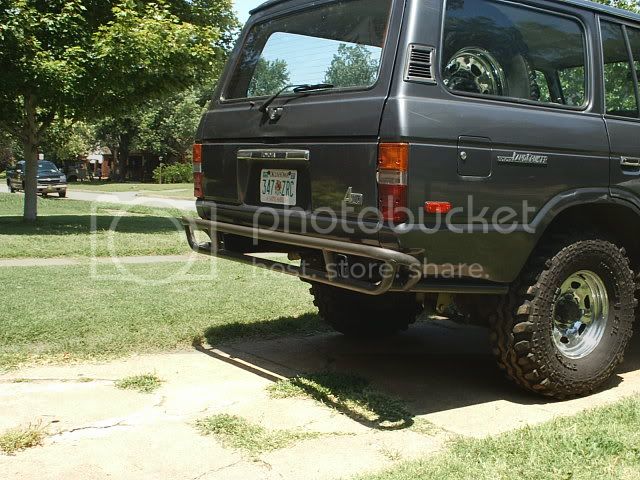

Can you take a pic with the rear tailgate down? I am wondering the clearance. I plan on building a bumper and want to know how high I can go.....

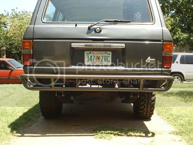

I like the bumper, way nice. How do you have your spare mounted inside??

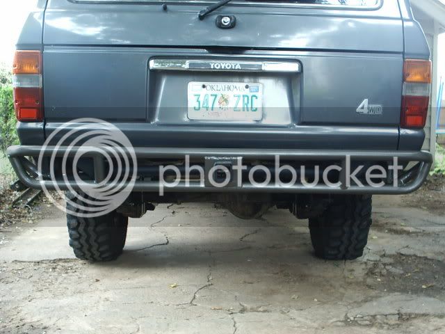

Any other pics!!! ??? Thats really nice. I have been throwing around ideas for tube front and sliders and something similar to this would definately make it uniform.
Any way to incorperate a hitch?
Clearance (Tailgate)

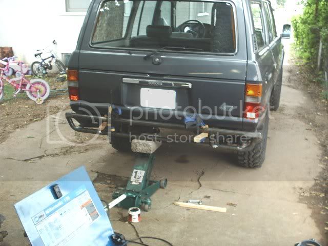

There is about 1/2" (maybe a hair less) of clearance with the gate down. I used a yard stake clamped to the top of the frame rails for a jig with the top tube sitting on top
. The tubing is 1 3/4"
Paint
That is somthing called "Hammered Finish" that you can get at Lowes or Home Depot. The color is called Dark Bronze, but as you can see, it looks grey. I used it my old rig as well and it's really easy to touch up as it comes in a can.

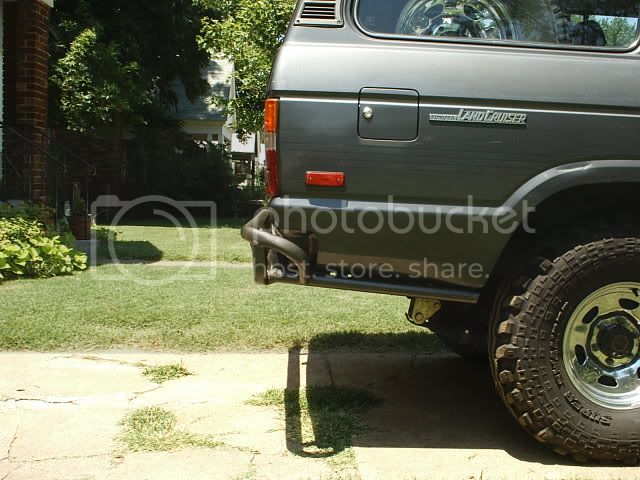

can you post some pics of how its mounted and some detail of it i'd like to get something like that built for my 60
