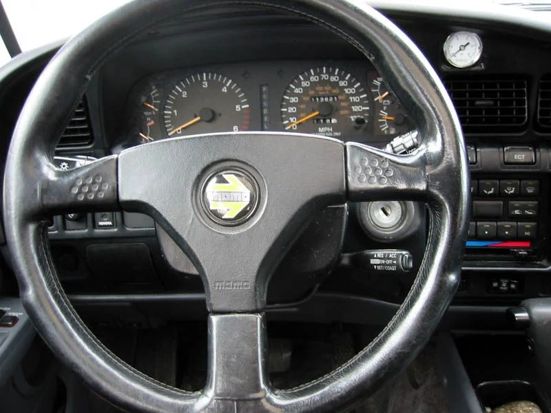

I went the other direction on my SC work truck -- keep it simple. I'm personally not a huge fan of A pillar gauges for many reasons, and normally on boosted engines, the only heads-up one I suggest is boost. Even then, when doing installs, I always put a dimmer cut-out for the back-light feature. IME, there are two types of gauges, reference and diagnostic. A boost gauge could be considered reference (it is good for cruise control O/D drop-point anticipation on the SC trucks), but EGT and Oil temp/pressure are diagnostic gauges IMO. Diagnostic gauges don't need to be line-of sight.
That said, here is my boost gauge install (1.5in 15psi fuel gauge)
attachment.php

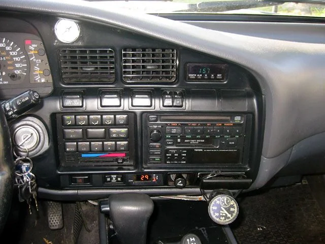

For IC in/out, I used this gauge installed in the switch-blank next to the rear heater, which currently measures air at the Airbox and air in the intake manifold (center position is differential). But I normally install them in turbo cars to measure pre and post IC. (The gauge below the ash tray I since removed, is a aviation Hg gauge I used when I was doing some accurate boost vs ignition testing)
attachment.php
After years of doing gauge installs, I'm of the feeling that A-pillar gauges are really distracting. For track car builds, I don't recommend a-pillar because multi-depth-of-field gauges cause a lot of eye refocus and fatigue. I still install a lot of them on street Audi turbos, but I always get thanked for the dimmer delete switch. With 90 thousand miles Supercharged on my 80, I have felt no real desire to 'add' any other gauges, reference or diagnostic.
YMMV, IMO, IME, HTH and my .02
